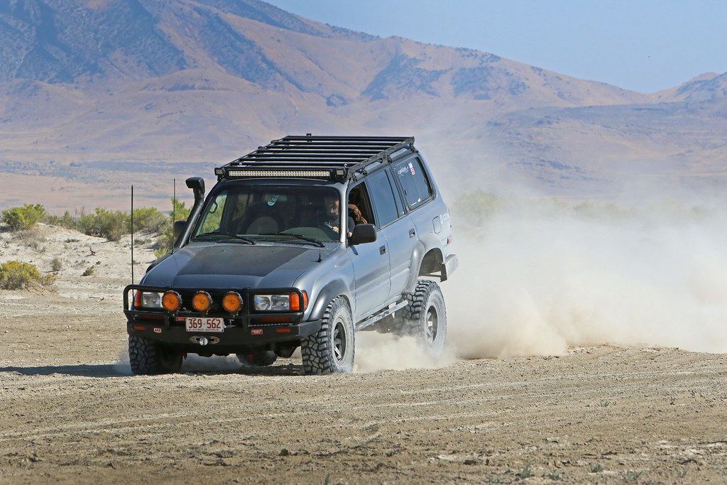

37’s fit diameter wise plenty easily - it’s width and how your suspension travels that determines how cleanly it happens.
I ran 37” trxus on stock rims with 1” spacers no problem and that tire is as big as the STT Pro. But it curves inward and the tread width is only 9” and change so the tuck is completely different than a squared off tread design. It was overall a cleaner fit than the ko2 on 8.5” rims, despite being a full inch larger.
Sticking with 35’s isn’t the issue, it’s that you have to be careful with more variables on 37’s.
Compare this tuck to even the ko2 - it’s much cleaner because the ballon style of the tread angles it inward. As compared to the squared off STT Pro, it’s obvious my backspacing is now not ideal where it was before on the same size max size 37” tire.
That’s the 3.5” F.O.R. Gen II suspension BTW. Here’s the video. The first half being poor spotting and worse driving.
This is also still on F.O.R. Gen II. Some points of good stuff of the ko2 here.
This is also the big 37” Trxus on 3.5”. A little secret is not going super long travel. This is a 10” travel shock with the full travel available with 2” bumpstop drops and eye adapters spacing the travel down. All four tires are planted.
Here’s the vid.
Here’s a closeup of the shock as the bumpstop first hits the axle. Notice the near full compression with a little bit of bumpstop compression remaining (shock protected with no wasted travel).
And here we have 50/50 up and down travel and static ride height so one side isn’t on a limiter (bumpstop or full extension) while the other side is still traveling. This is on the 4” Flexi, and perfectly balanced.

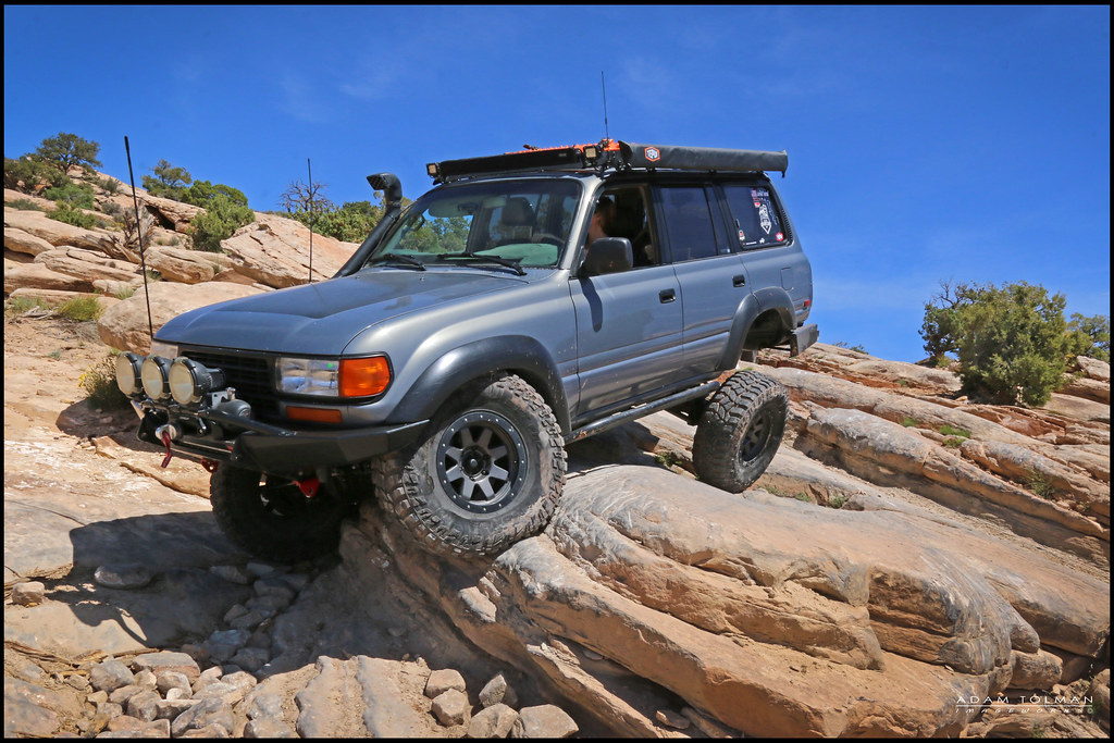

Just that one - was just checking tire fitment on a slag pile. I did look to see if the front end was bound up, and the twist was mostly at the frame end bushings - no bind on the axle end in terms of arms to brackets.
Pretty good in showing how balanced the Flexi is with my shock setup.

Not about coils, but that will dial 37x12.5” tire tuck on a 17x8.5 -6mm offset rim with a net 3.75 backspace. Thems important things to know when one doesn’t want to lose suspension travel arbitrarily to bumpstop drops, or break out the trusty sawzall, just because a certain net backspace is difficult to achieve.
I could drop my stops another 3/8” or so and take care of any remaining rubbing, but then I am tossing suspension travel I worked hard to dial exactly as I want it into the trash. So new spacers it is.
