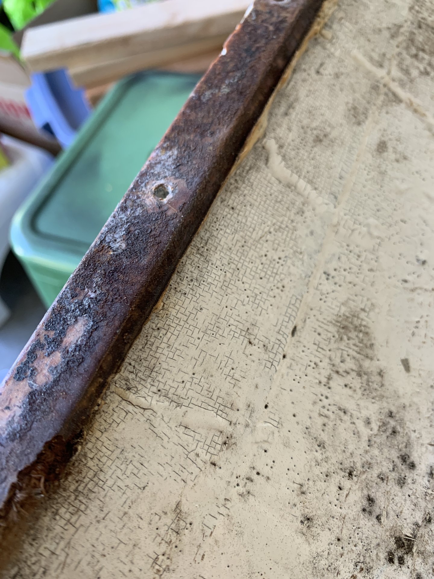

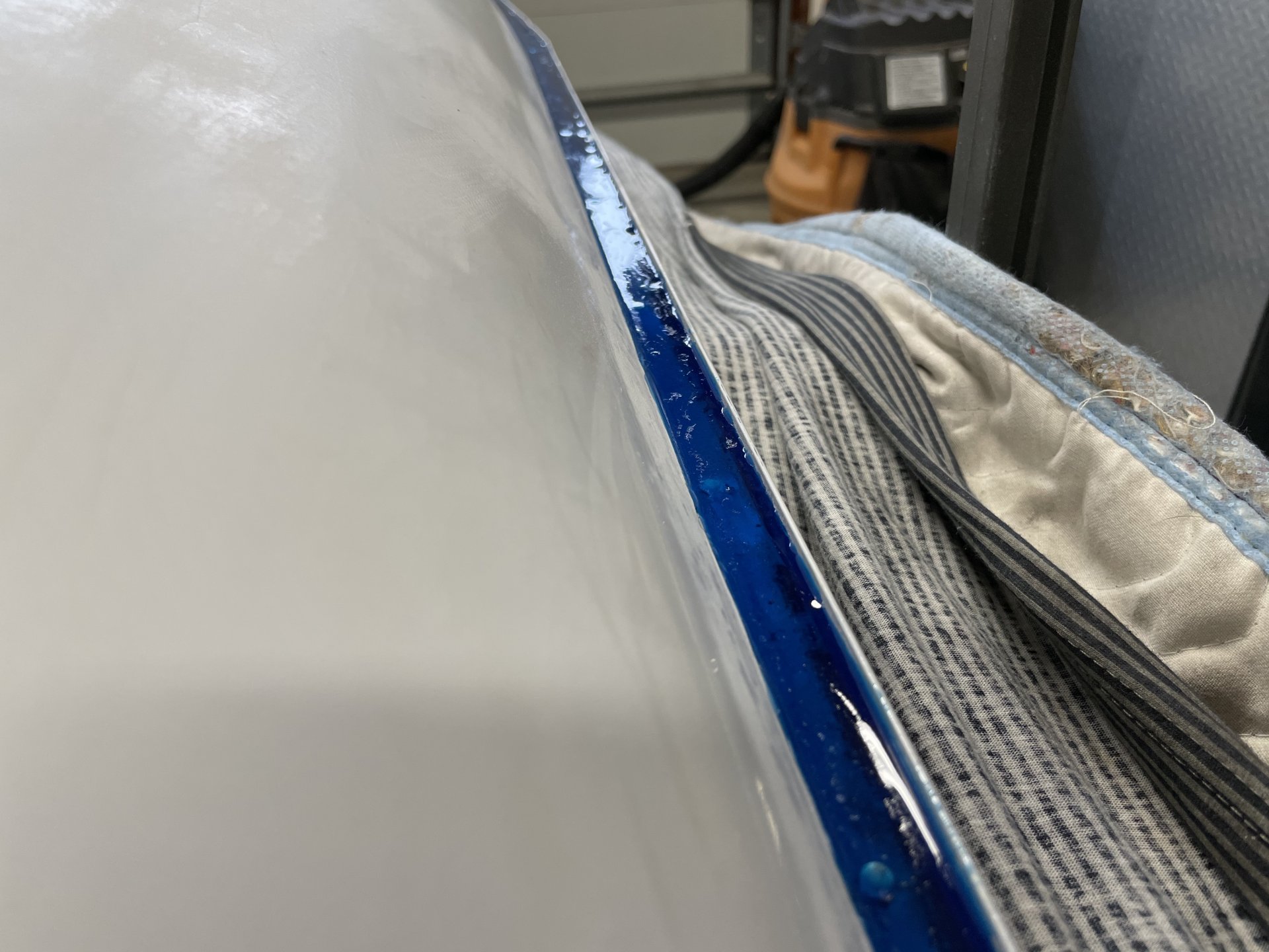

I wonder if they used fiberglass webbing to make the surface stronger and flat?
But if I'm understanding you, it's not impregnated with resin correct? It's more like fabric(soft/flexible) than the rock hard fiberglass of the rest of the cap?
Yeah. Could have been poor craftsmanship back in the day?
If I were to guess, I'd say they had a rationale behind it...maybe to soak up deviation in the mating surfaces? Regardless, it is a poor design (in my opinion) and I definitely wouldn't replicate it when going back together with yours.
I am no forensic scientist, but I am guessing they used fiberglass cloth with a thicker weave to build a flat surface. The epoxy they used to firm it up is still there in parts but its mostly deteriorated. To me, they didn't use enough. I will bring it to a boat shop and have them build it up using newer techniques.

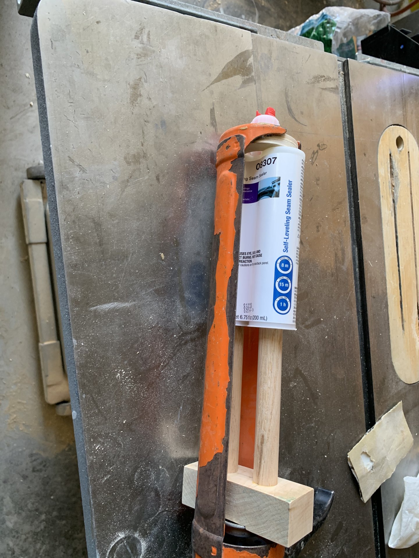

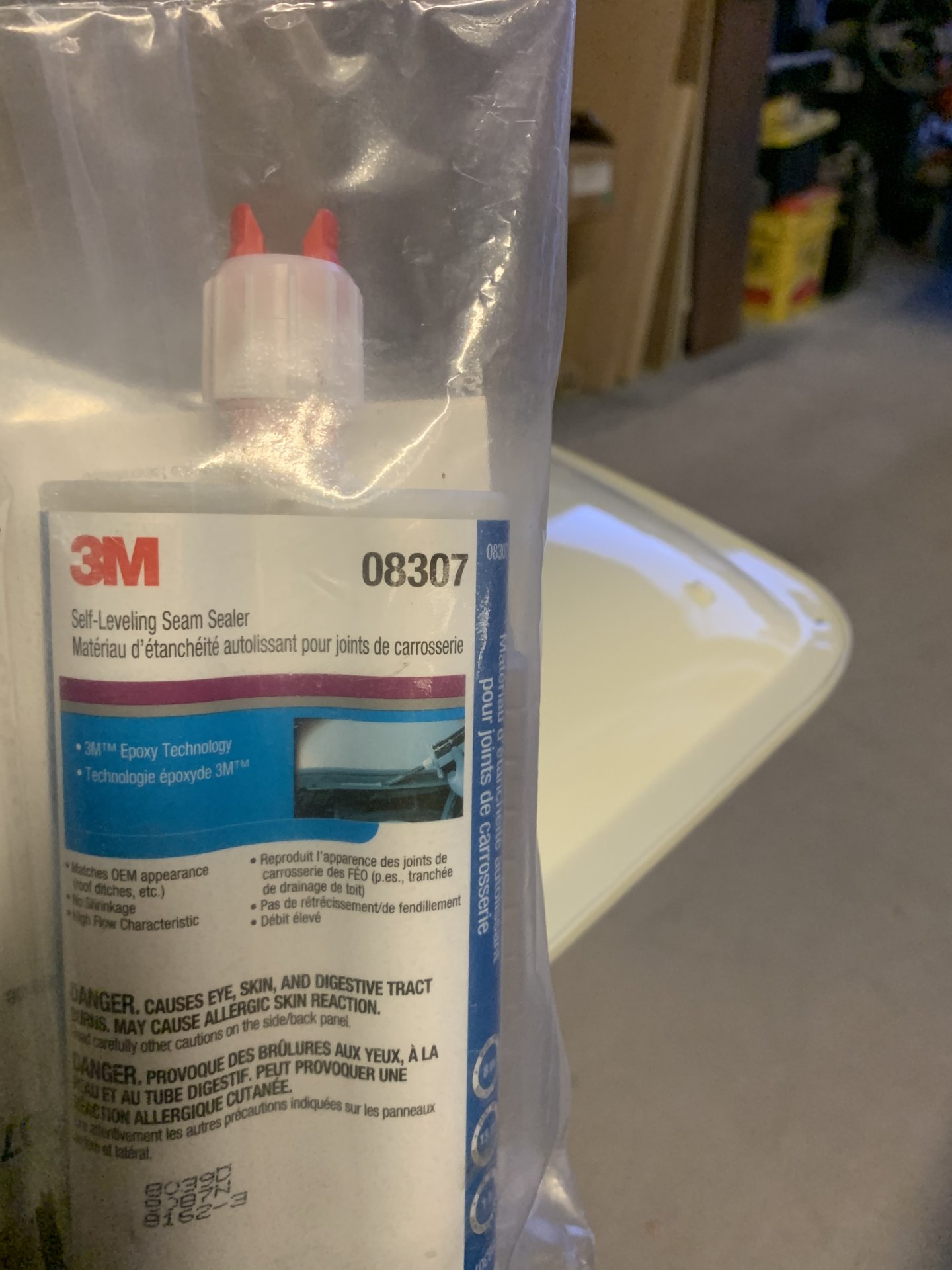

I’m not sure if this will help or not but I had to replace a section of my original rain gutter I had to been destroyed by a rollover. I purchased a section from CCOT as others have mentioned on this thread. I ended up needing to get a donor fiberglass top because the one I had was totally filleted at all four corners I also purchased a rivet set from CC0T and with a lot of patience used a tack hammer to round all the rivets over. Once that was done, I used a two part 3M self leveling filler over the rivets in the gutters prior to painting the top and the rails. I had to make a ghetto press to use in my Quart caulk gun to make it work. If you are interested, And I wanted a clean look so I used the good stuff that was about $55 a tube. Approximately four tubes were needed
I’m not sure if this will help or not but I had to replace a section of my original rain gutter I had to been destroyed by a rollover. I purchased a section from CCOT as others have mentioned on this thread. I ended up needing to get a donor piece of fiberglass because the one I had was totally filleted at all four corners I also purchased a rivet set from cc 0T and with a lot of patience used a tack hammer to round all the rivets over. What’s that was done I used a two part SEM self leveling filler over the rivets in the gutters prior to painting the top and the rails. If you are interested, I will do some investigating and find out what I used as a filler. And I wanted a really good luck so I use the good stuff that was about $55 a tube. Approximately four tubes were needed
That's the good seam sealer, exact product I would/will use for gutter sealing over rivets in the gutter lip.

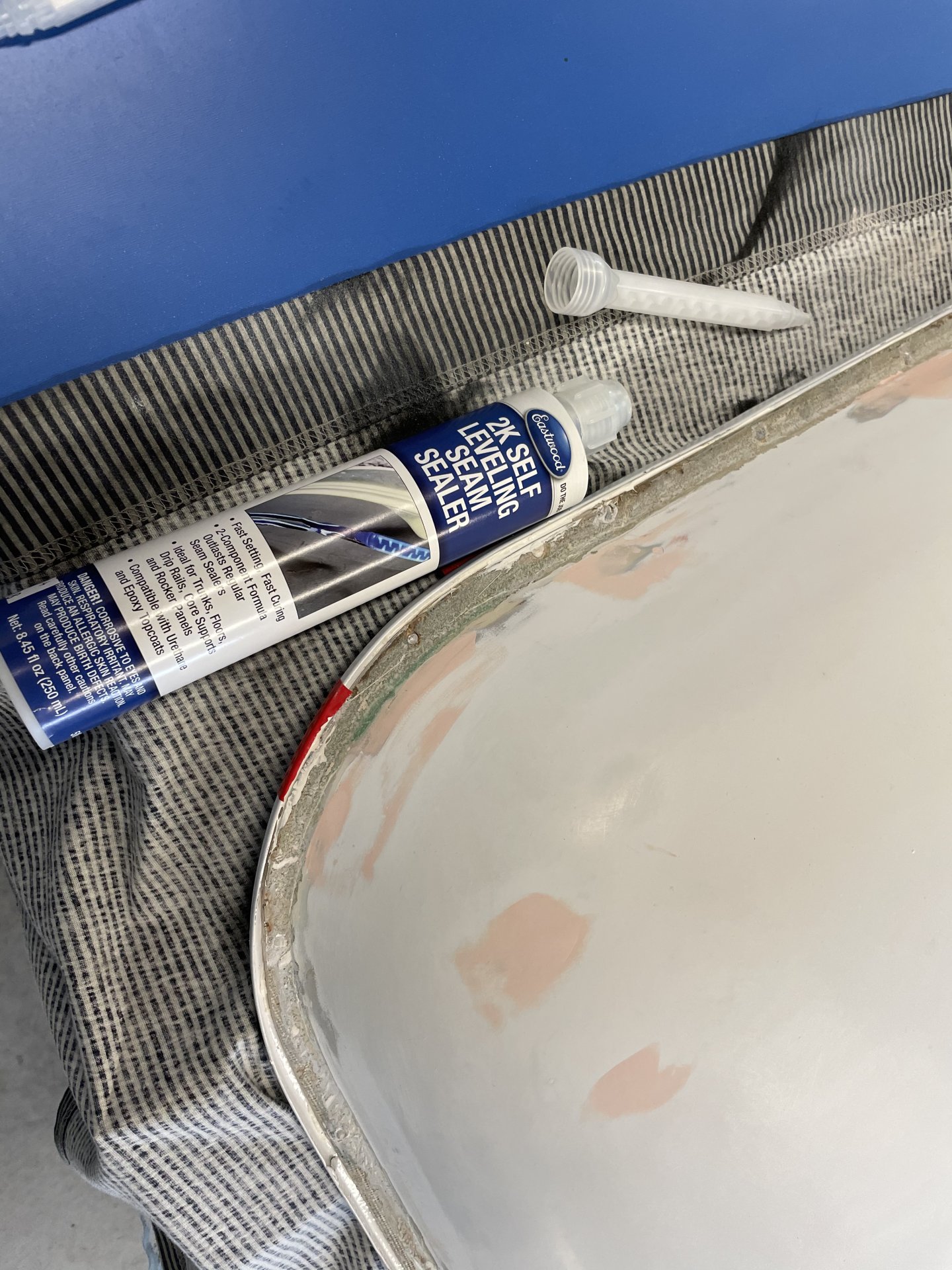

One product I don’t see mentioned a lot is Eastwood 2k self leveling seam sealer. It’s a true 2 part epoxy product that comes in a regular size caulk tube, so no special caulk gun needed. It goes on easy and takes paint well. You will need 2 tubes.
