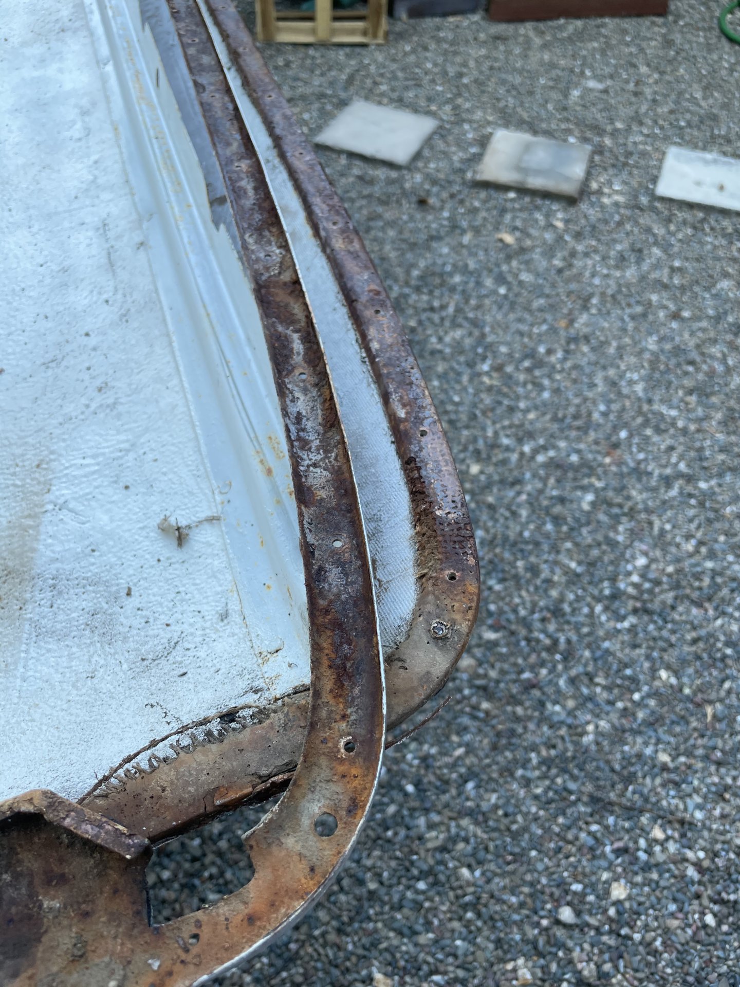

Also, while examining the rim of the top. The material that connects directly to the fiberglass shell appears to be some sort of fiber cloth. Does anyone know what this material is? It doesn't appear to be fiberglass but I am probably wrong. I ask because I will eventually bring this to a boat shop and have them rework the edges.

Any chance that your cap has been apart before and the burlap sack looking material went on with the custom liquid nails headliner or something else a po thought was a good idea?

Hmm, yeah my truck appeared to have original rivets, and definitely did not have a material like that between the fiberglass and the gutter.
