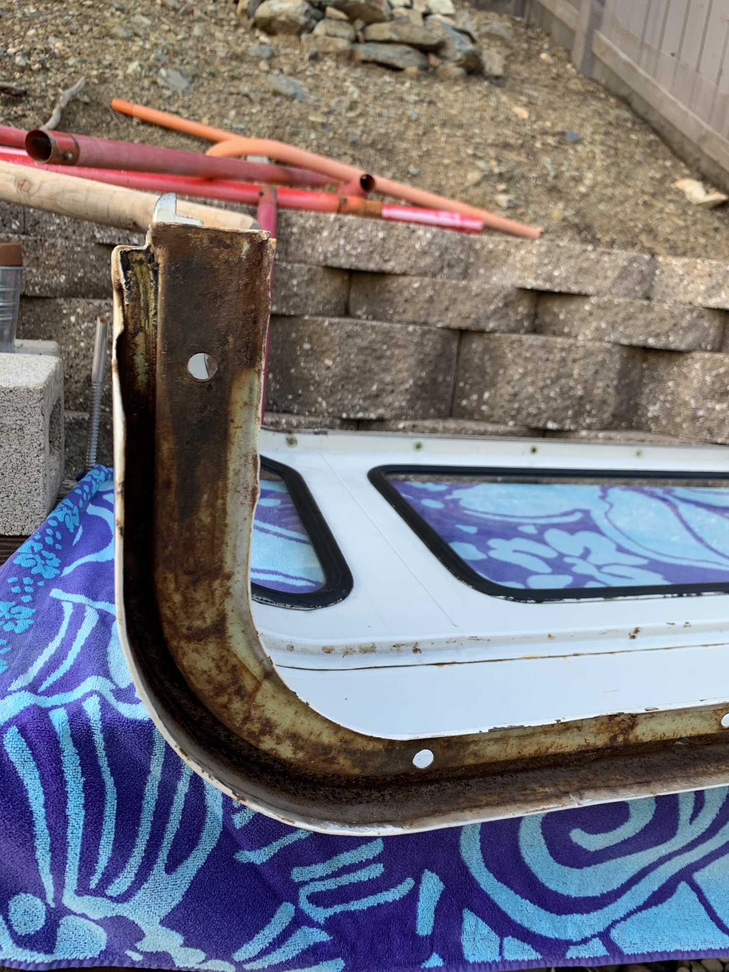

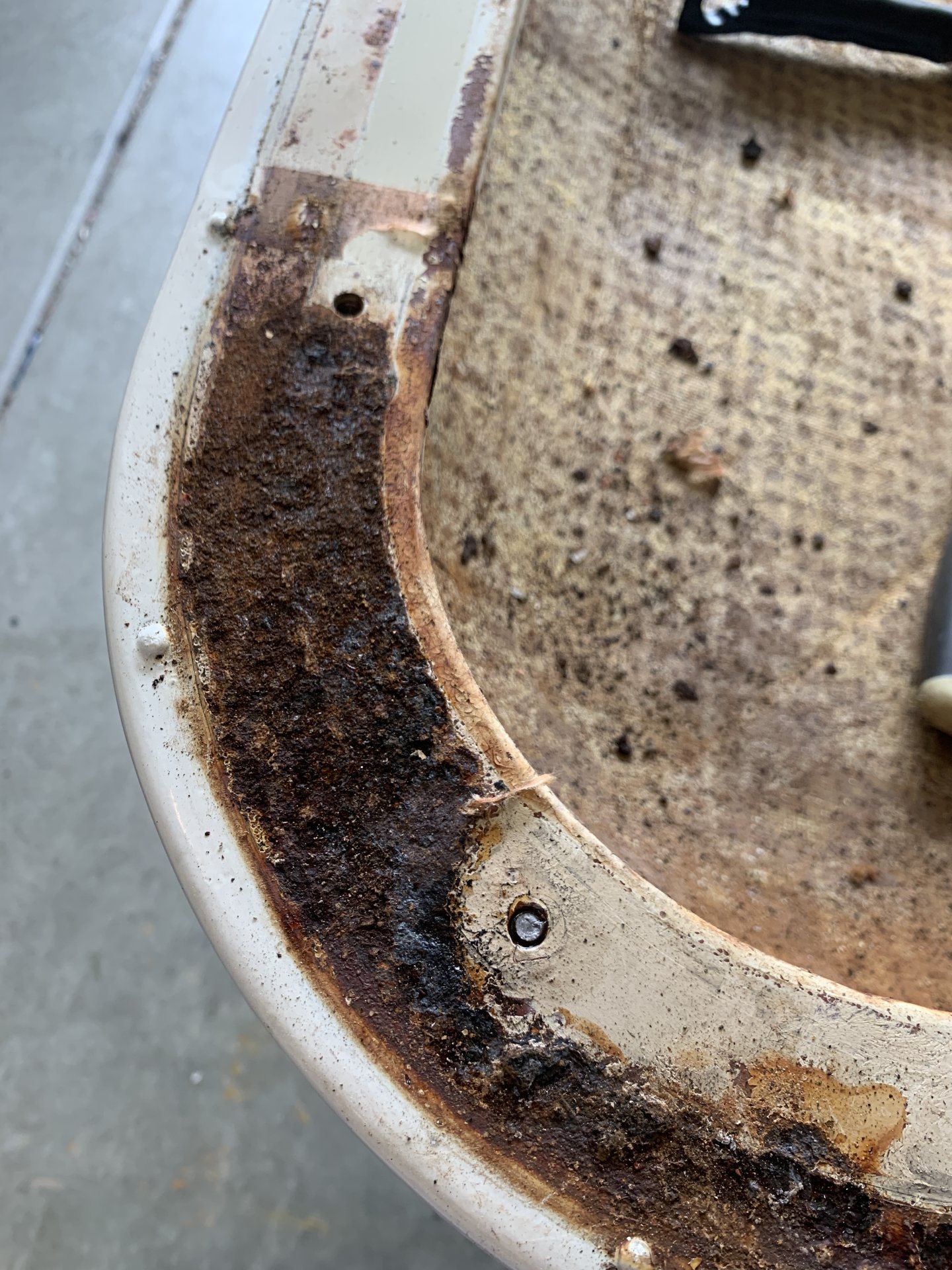

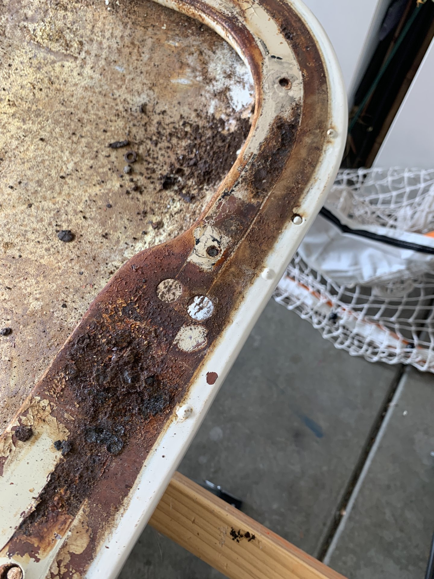

Well, I flipped this thing over like a rotisserie chicken to see what the underpart of the gutter looked like. Crap... doesn't look pretty in the back corners. To make matters worse, yours truly has zero welding skills. So I will need to pay to have this patched up.
Question... do I pay to have this metal restored or do I order a gutter from Cool cruisers? Not sure what I can expect to have a welder charge to fix this. Beyond these spots, the metal is very solid.
Get a flap disc and spend $150 at Harbor freight for a flux core welder. Thats an easy fix. Plus its more fun to do it yourself instead of hire everything out. Thats my 40 ethos though, doesn't have to be yours and that's okay

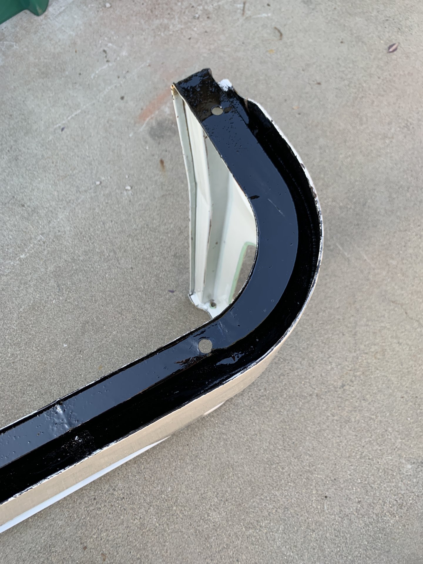

Made a little progress yesterday. Since I have the sides off, I put some POR 15 on. They had some rust spots that weren’t terrible but needed to be treated with something. I did the 3 step POR process so I think I did it right.
Got my gutter back from the welder. He said it didn't make sense to cut out all the small holes and do a bunch of tiny patches. So he filled them all instead. Does it look as pretty as a clean patch? Nope. But this will do.
After I finish shaping the dented edges and such, I am going to hit it with a 2k epoxy primer. Then fill some of the pits with body filler, followed by more 2 k primer. I want the bottom to be as flush as possible to the weatherstripping to create a near-perfect seal.

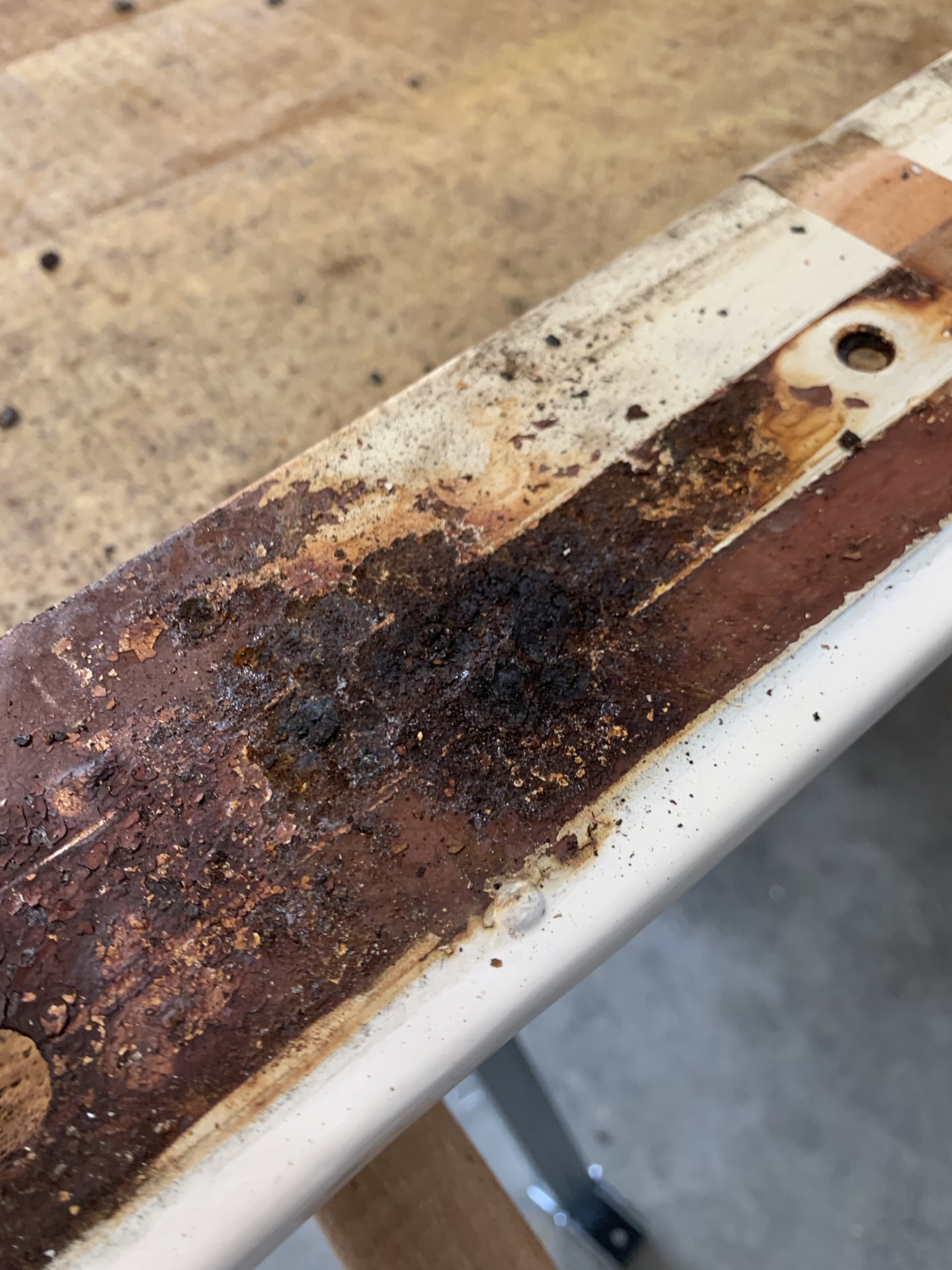

Question... this thing has been media blasted and then worked on with bare hands. Yeah, I know. Don't do that. But what's done is done. Any recommendations on how to remove some of the very light rust before I primer? I thought about hitting it with a roloc bristle disk. Just not sure which grit.
I'd just hit those spots with 80 grit sand paper by hand. That kind of surface rust is easy to remove.
Also, I'd recommend doing the body filler directly on the bare steel. The epoxy primer usually has a 3 day recoat window. If you aren't able to paint within 72 hours, you have to scuff sand tiny spot before you can put any paint on top. On a part like that gutter, it'll be a bear to get into the nooks and crannies.
So unless you live in a really humid area with big temperature swings (aka prone to flash rust), I'd try to hold off on epoxy until you're ready to paint within a few days.
