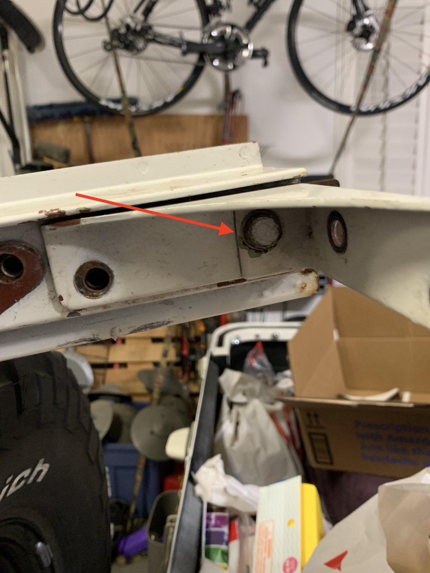

Here is the rear hatch brace. When I removed the rubber piece you see here, the metal looked in good shape (not rusted out).
However, one problem... the nut that holds this bolt in place just spins and spins. Any suggestions on how to remove it without having to cut the side out, and access it that way?

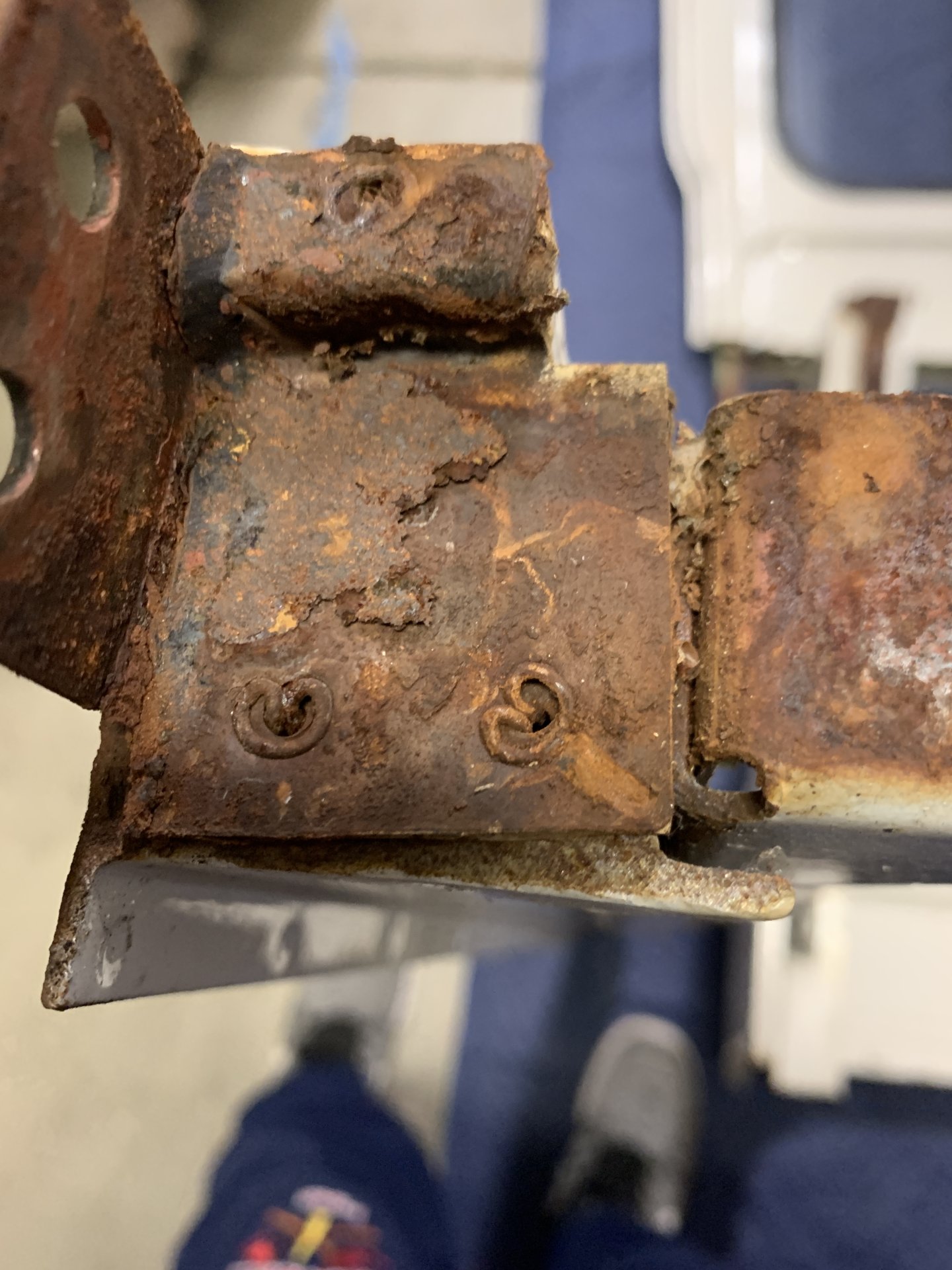

No good ways, here is what you're dealing with inside the header. The nut is captured in a steel cage...I'd imagine yours did just like this one and the cage rusted away leaving the square nut free to spin. You will likely need to drill a access hole and tack weld the nut in place then weld up your access hole... This will mean the angle bracket is no longer adjustable. Or you could cut the end wide open and re create the nut cage. Other options are replace the header or make peace with it and do whatever additional work you're planning on with the bracket in place.
Ugh. I checked for a new header and saw real jacked up ones going for a lot. I am thinking the best thing to do is cut the side open and try and repair it.
I had the same issue with the spinning nut inside the header. A welder friend of mine came up with a good solution. Old bolt was cut off. The square nut on the inside was punched out. He drilled a hole in the header just big enough for a regular hex nut then welded it flush with the header. This approach was minimally invasive compared to opening up the header to weld in a new captured nut. Sorry no pics of the process.
ohhh i like that idea! I will cut it off!!!
Voilà! Knocked it out this afternoon. I used a Dremel with a cutting wheel to get in the tight spot.
I am going to do the same thing you suggested and weld a nut there. Thanks for the idea!
