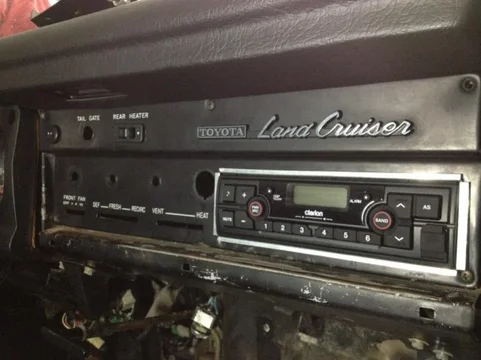

I'm working on putting an updated radio in my '76 pig right now. Found that a Pioneer CD unit (and any other standard size CD player) is too deep and hits the windshield wiper linkage.

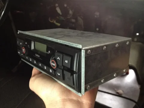

I ended up ordering a Clarion RG9451 which is shallower but includes a front AUX input instead of the CD player. They're meant for heavy machinery, so they're waterproof and vibration proof...perfect fit for an old cruiser. Very solid unit.

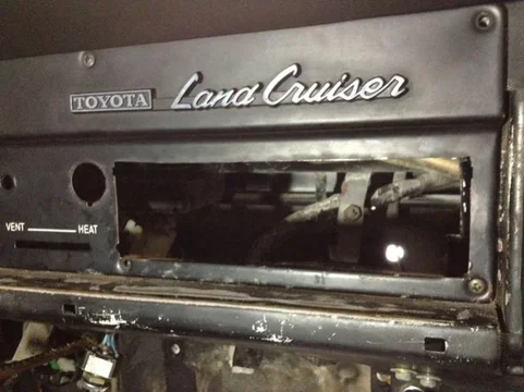

The biggest part of the project is building a sleeve to mount it in and trim the dash to fit. The seam on the left side of the defrost duct will need to be trimmed some, but a dremel and coarse file make quick work of that. The sleeve is just sheet metal bent in a brake and rivetted.
Here are a couple pics.
The decision to cut my dash was a hard one, considering the dash panel is near perfect. But I wasn't having much luck finding radios that fit the original slot. If you do decide to cut, cut smaller than needed and use a fine file to finish the edges so it's a nice snug fit. No regrets here.
