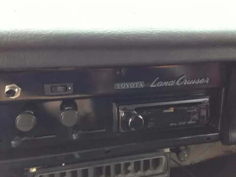

lowtideride said:
I have used in the past on all my cruisers...
~A small amp that powers the speakers.
~My Iphone or Ipod to control music and volume
Who listens to the radio and cd's anymore?:p
With this setup it you leave the dash OE and unmolested. Aftermarket head units always look terrible.
-Al:beer:
