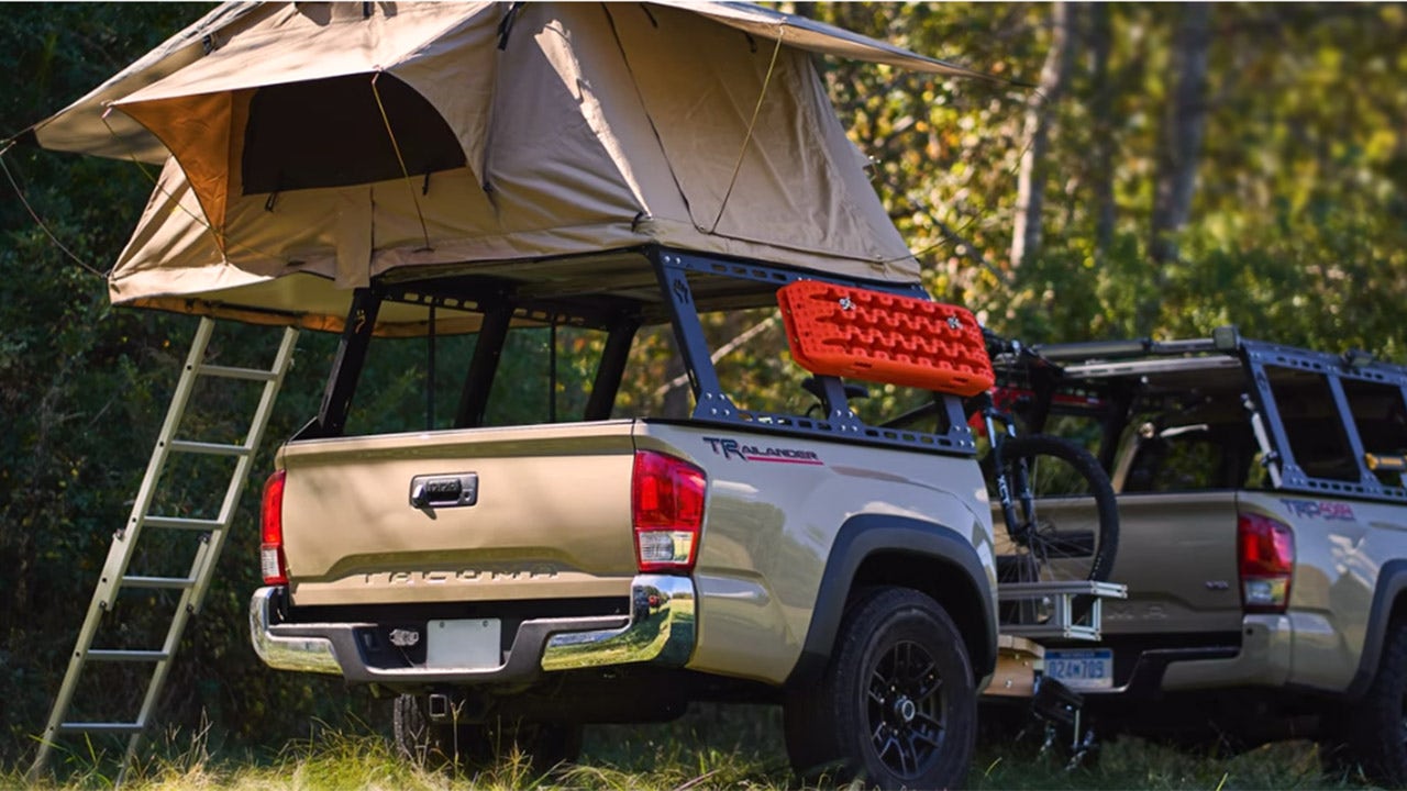

I caught this will looking over the election results.
Okay, this may be my next mod, especially if Toyota pulls the trigger and actually builds them! How cool would that be!!!

I find it kind of funny because red necks have been doing this for decades and it has always been considered trashy. Now it's suddenly hip and cool and will cost you thousands?! The world works in mysterious ways.

Your right!!! That was a Redneck trailer back in the day! Didn't even think about that till you mentioned it.

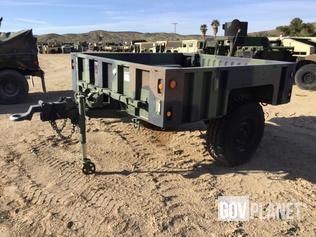

I've been pondering building out a M1102 Army surplus trailer. You can get them all day long for $500.00.
I flipped and even built out a few M1101's a few years back, it wasn't my thing either. I was using them with my lifted Power Wagon and Super Duty, both of which were on 37's and they were still tall trailers even for those trucks so they might look ridiculous with our smaller GX's not to mention how much wider they are than the GX. I wasn't finding them for $500 at auction, usually they were going for $700-1100. By the time I cleaned them up and converted them to 12V, LED, 7-pin and got them tagged/inspected they were always well over $1K but I would get $2500+ for them when I flipped them.

The width is my one big concern. Even with a full size truck, just who wide are they when using your rear view wing mirrors?
I'm thinking that my wing mirrors will be useless, which may be the main reason not to go in that direction.

They were wider than the body on both my Super Duty and Power Wagon on 37's, they were after all designed for the HMMWV.

I can see that they are lower than your wing mirrors, but do you think they would obstruct vision if they were built up, like the ones with the canvas tops?

Here is a pic of the width behind my 2018 Power Wagon on 37's.
Hard to say how high it would sit behind the GX but you'd certainly have to have a riser on your hitch for it or drop down to smaller tires and that would look pretty silly considering that they are setup for 37's. Most come with the canvas top but not all of them have the bows needed to complete it. I am not a fan of the soft top, it's fine around town but it's not really up to the task of highway speeds and the buckles and twist tabs that lock it to the trailer suck. Good luck finding a Schutt hard top too, I looked for a year and never found one and they are TALL with them on.
I tracked down a now out of business company in California that was making hardtops for them and myself and another guy bought one. They weren't bad but they weren't perfect either and needed reinforcing with the interior frame/cage. Even then they still weren't quite up to the task of a static load required to run a RTT with occupants safely. The biggest drawback to them is that they are as wide and they are long and they aren't easy to insulate. I ran mine with two cots inside once and that was the end of the it. They are also quite wobbly even with the included platform jacks.
I wanted these to work and in regards to towing behind a large, lifted truck they do quite well both on and off-road but I wasn't a fan as a "overland trailer." I ended up flipping six of them and made some good money but I've since moved on.
