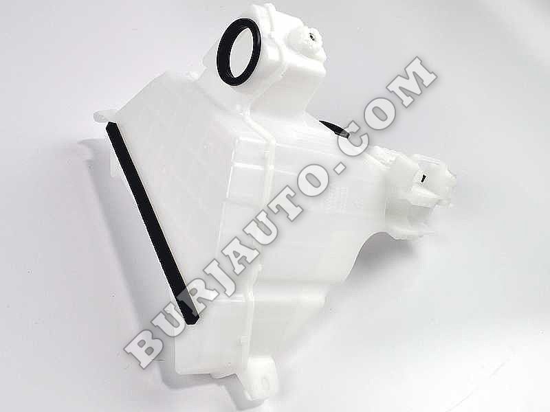

PN: 8531535340 - Same washer bottle for 4R and 460 (without headlight washer)
4R
460 version without headlight washer (10-19)
4R

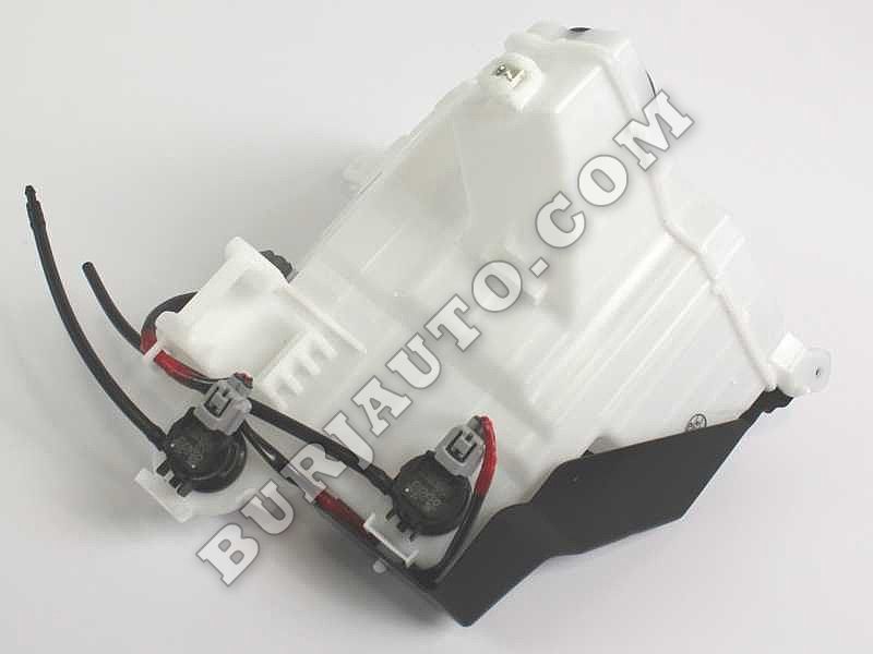

So with a no go for me, I have the head light washer, assuming the SSO cover is for the without head light washer.
Picture of 8531535340
8535560200 - '10-'13 w/Headlamp Washer
'14-'19 w/Headlight Washer - 85355-60240
2020-W Headlamp Washer. No Image found yet - PN: 85355-60320
