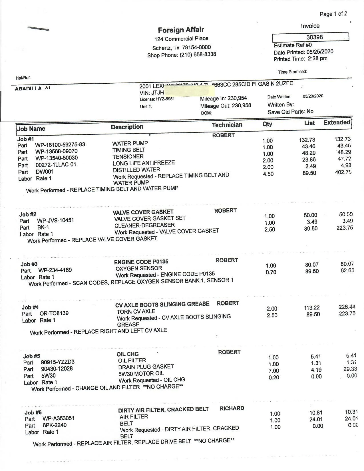

I know the OP asked about dealerships, but I'll share my indy shop quote for additional reference. Foreign Affair in Schertz, TX (San Antonio area) is doing my timing belt, hydraulic tensioner, and water pump for $725

Parts & labor invoice using genuine Toyota parts. (F.A. won't warranty work unless genuine parts are used). 4.5 hours to do a timing belt isn't bad ... I'd probably do it myself in 9 hours
Helpful info for comparison purposes. 4.5hrs is fair and the labor rate @ $89.50 per hour is quite fair.
