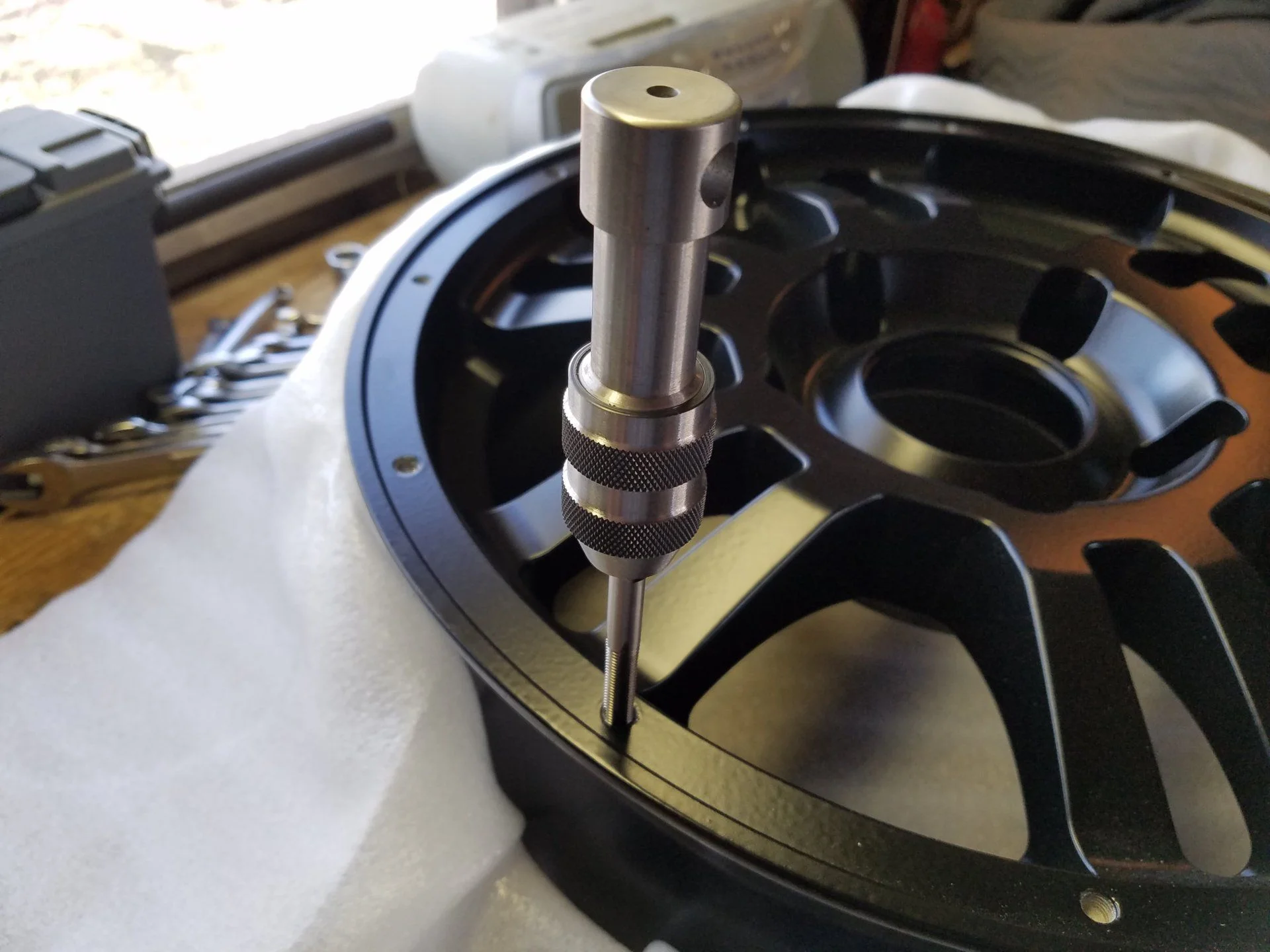

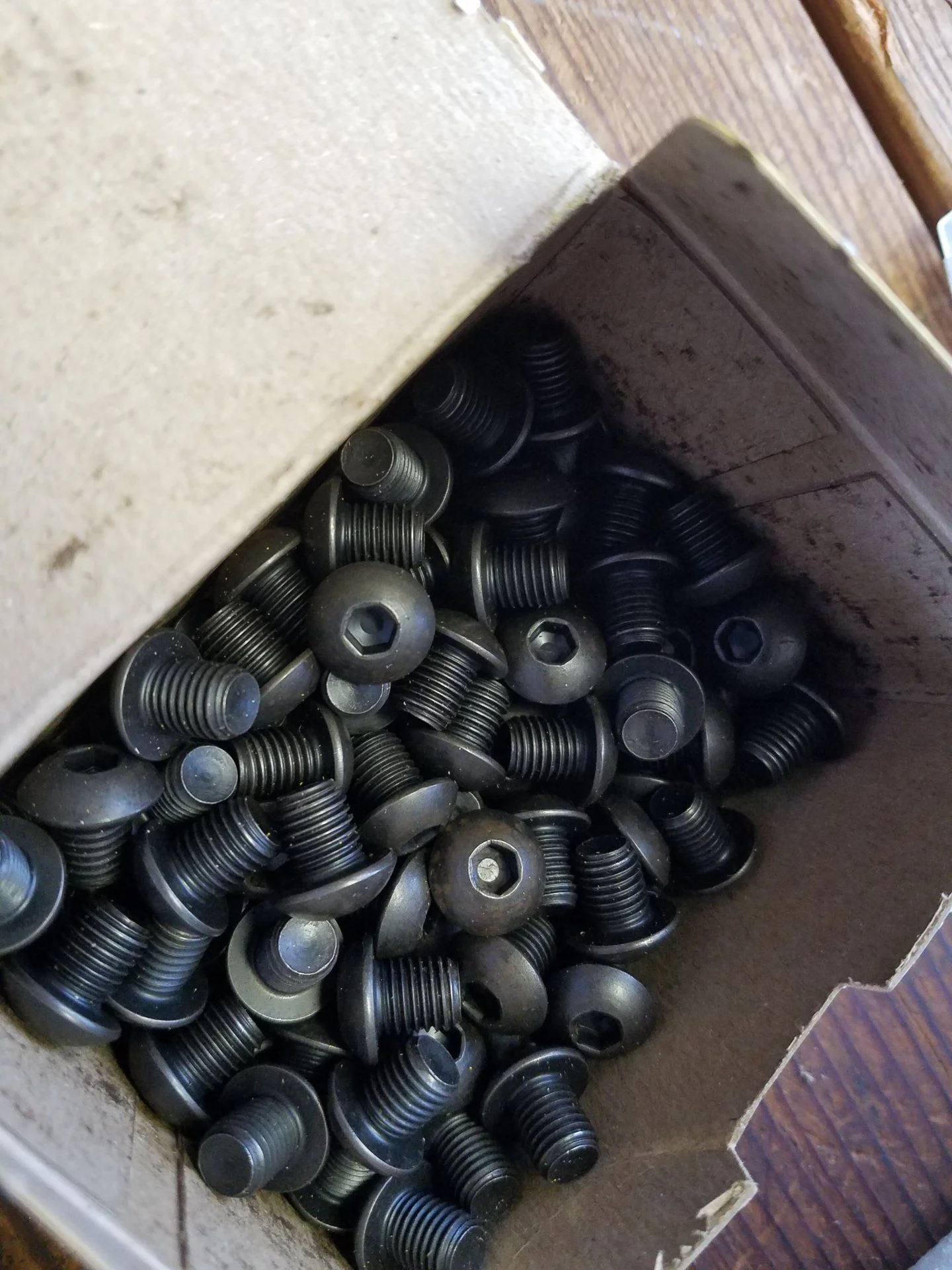

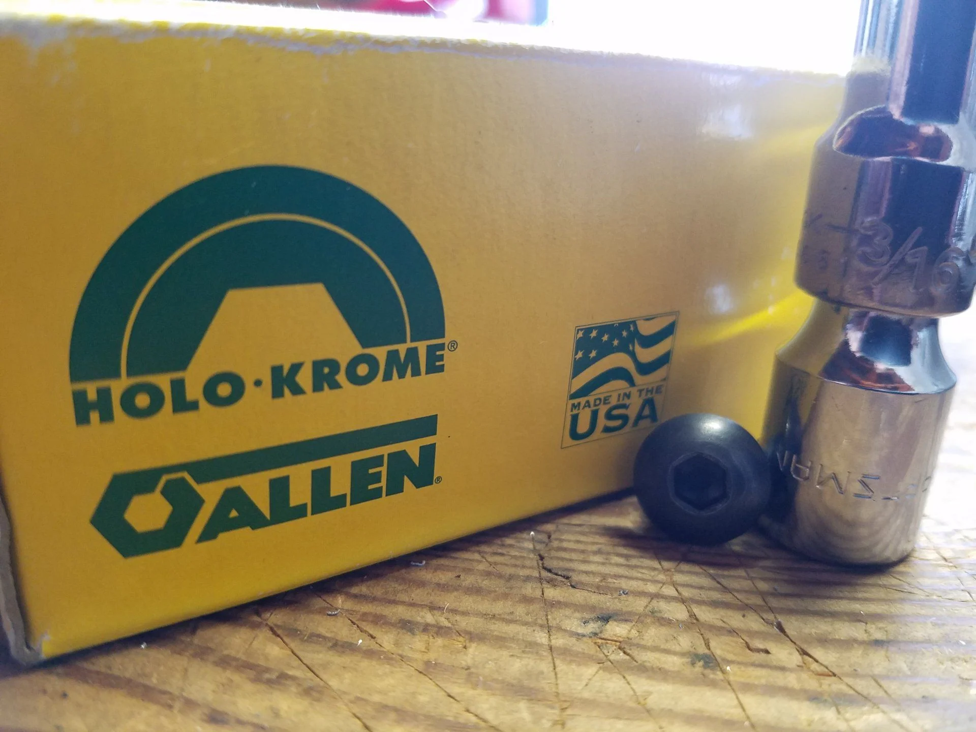

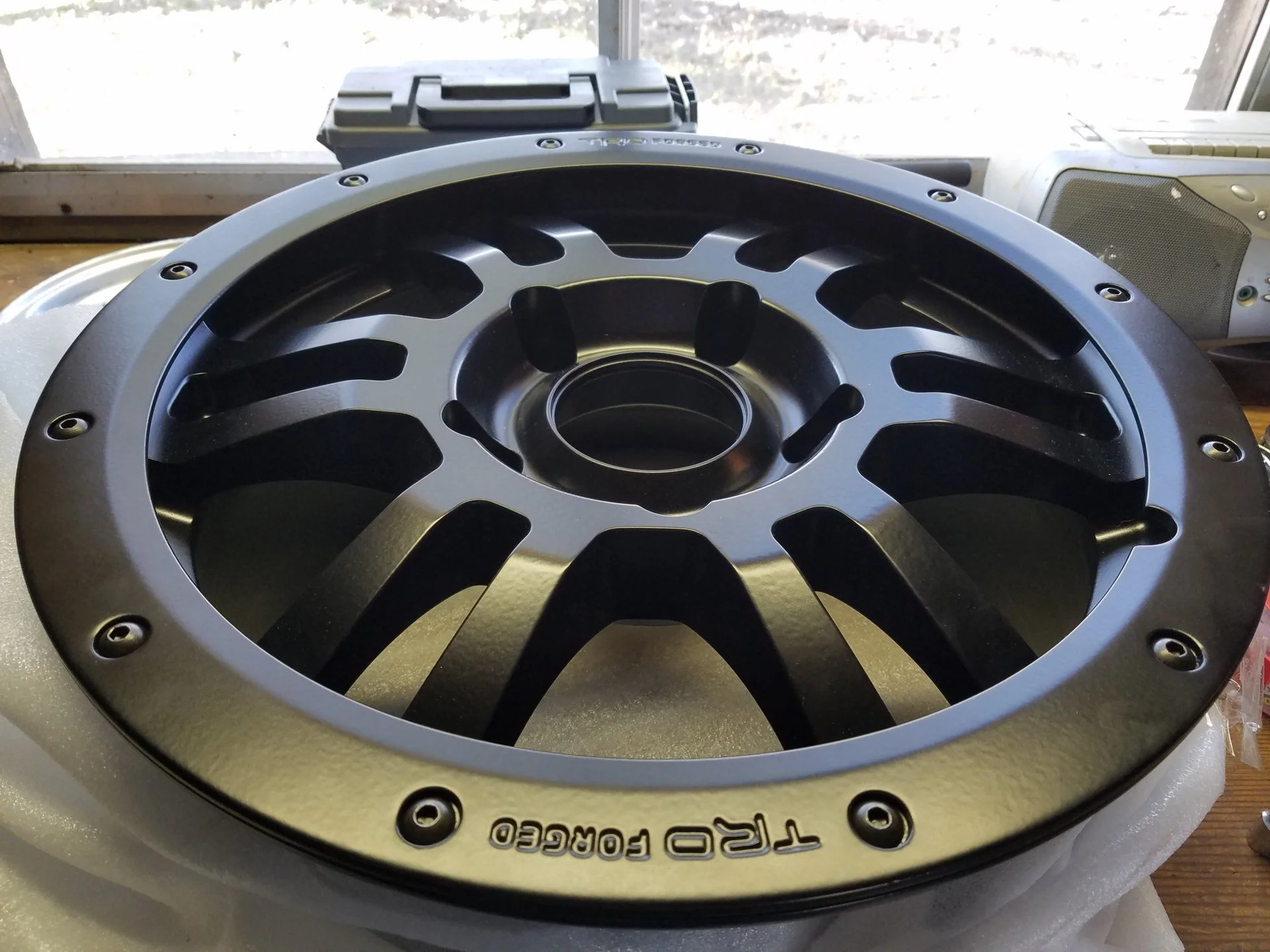

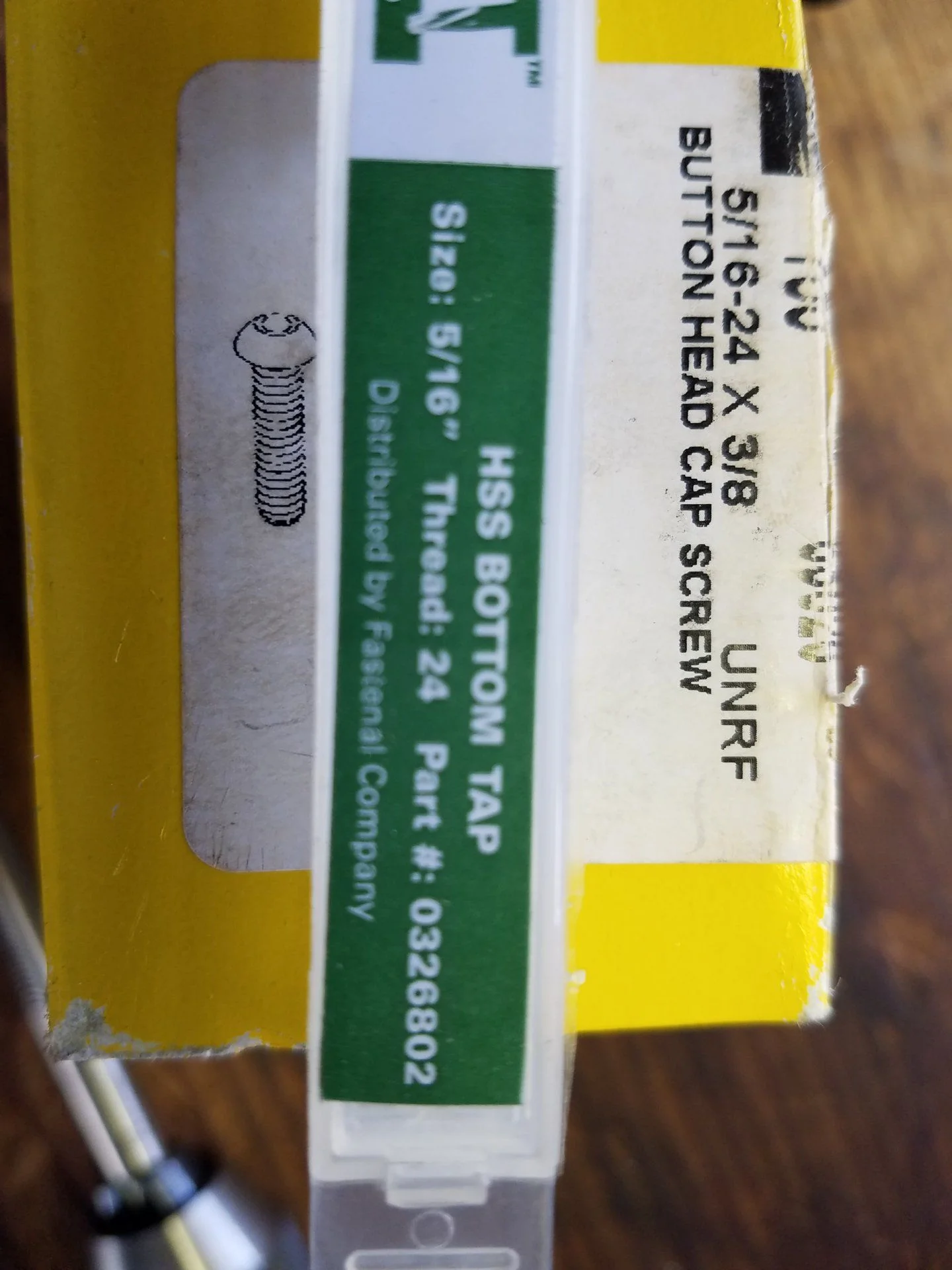

Picked up the RWs from powder coat, Cardinal Black T002-BK08. Looking great.
I looked all over but was unable to source M8X1.0 black button heads, I debated switching over to coarse metric but 5/16-24 was closer.
A trip to Fastenal, twice as they had to order them, netted 100 5/16-24 black button heads and a bottoming tap for a grand total of $50.91.
72 holes chased out later (two spares) and we're good to go.
Lug nuts next...

They look great! Just a word of warning on the black oxide bolts (I assume they're black oxide...?) - in my experience they won't stay uniformly black for long, and they may even transfer some corrosion to your rings. I hear clear coating the bolts, or even waxing them would help. YMMV.
I agree. Black oxide is not a very durable coating, and if you live in a high humidity environment, you can expect to see them rusting way quicker than you might expect. Clear or black paint will go a long way to prevent this, but I would also put anti-seize on the threads too. Since you (apparently) live in Arizona, rust may not be a problem, but fading from the sun may be.

I cleared the ring bolts before installing them, hopefully this helps mitigate any corrosion. I'm still on the hunt for an equivalent black bolt with better corrosion characteristics...I could Cerakote them but that might get pretty spendy.
