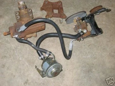

    I am using that bracket for mine. I lucked into a good deal here on Mud! First, here is what you need off the mini truck: ;) Pic boosted from E-Bay...
