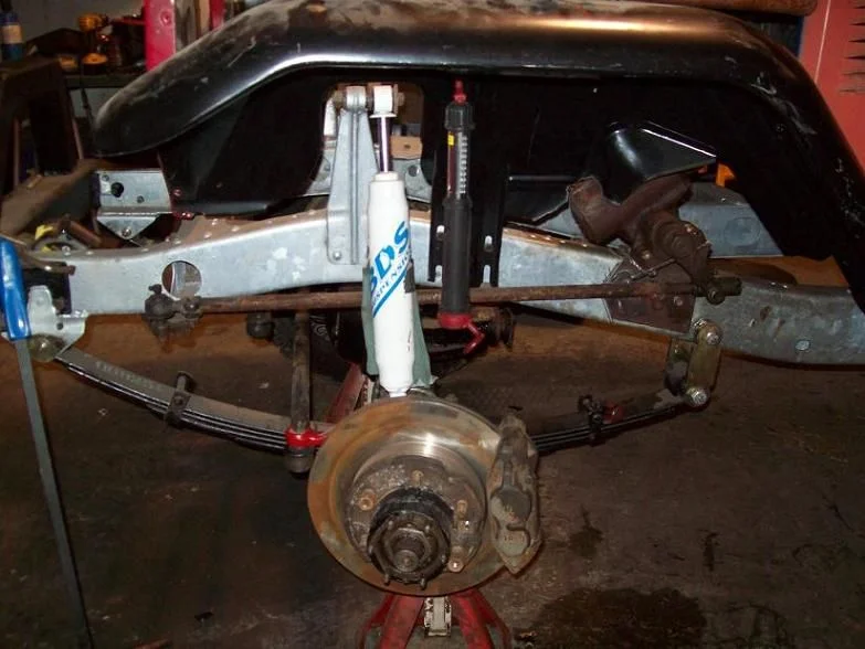

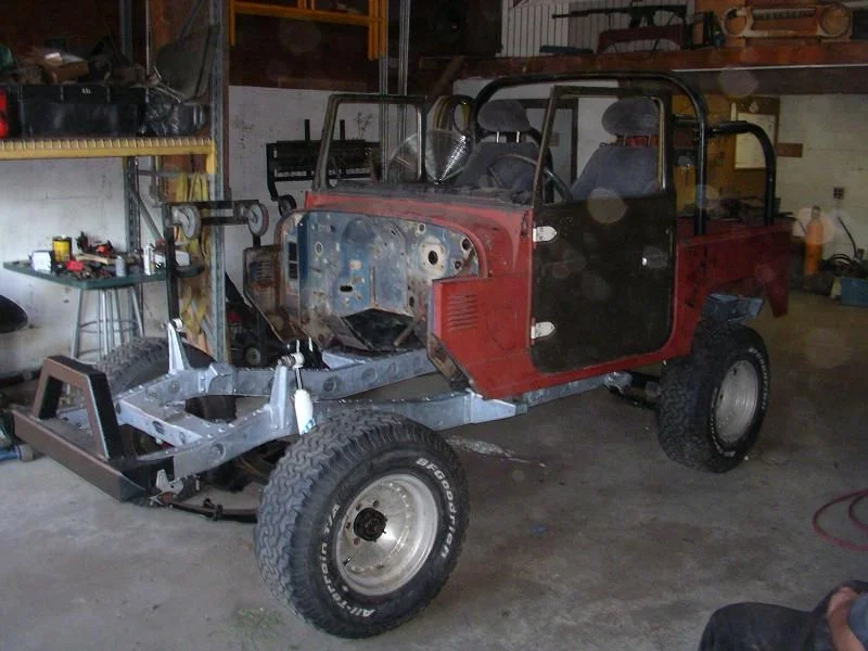

Finaly got a rolling chassis built. I am about a week~ish behind where I want to be, but what ever I am having fun and the girlfriend (its her truck) is happy.
Quick specs:
2.5in BDS
Galvinized frame
mini truck nuckels 27stock birfs
Vented rotors, IFS mini calipers
9.5 in wide rims, Big flat Centerline's
Vortex'ed midevil looking bumper.
I am starting the steering mockup/build once I get the tub floor welded and set on the frame.
thats the tub behind it, standing on the tailgate section The tins and Tub will go to Garnett blasting hopefuly next week, while they are gone Ill swap in motor/trany/tcase. Fmotor/4sp/3spd case

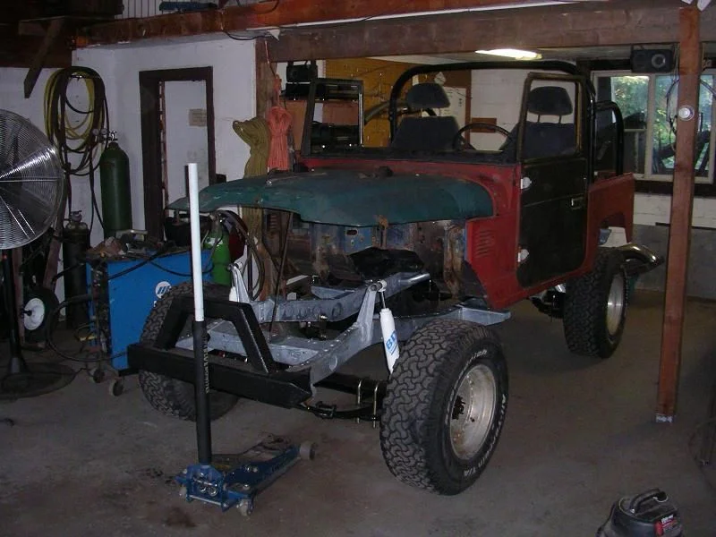

Droped the body back on last night to mock up stearing and stuff. Its going to be a while before those springs settle! I am 6ft and the bottom of the window opening is just under my arm!
Need to weld a few things up and it will be ready to go to sandblast.

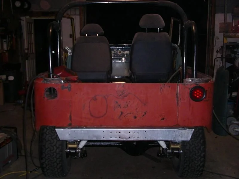

Quick update. All the little stuff is killing me. little more welding here and there... I keep finding stuff to fix. Got the seats all in, along with the tuffy, also got the tail lights in there too.
Thanks for those Leaping Dear!

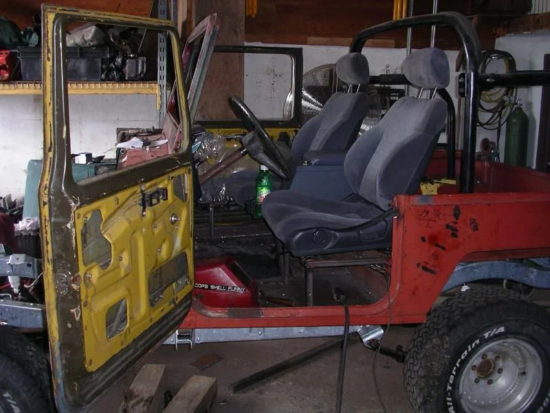

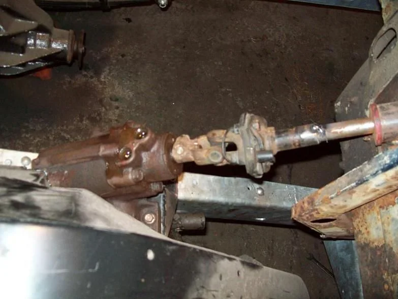

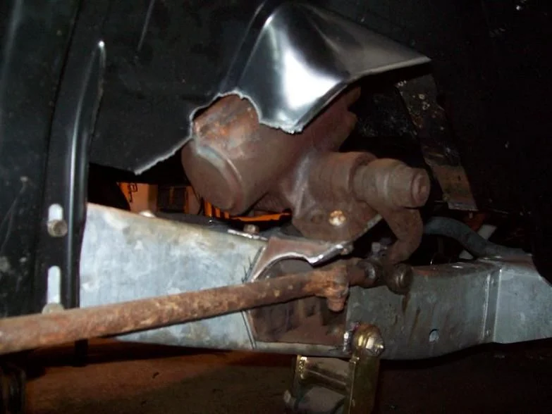

After a long time pushed into the corner, I am have pulled the 40 out and am working on this again. The boss has asked to drive the 40 instead of getting a limmo after our wedding.
Newish 33X12.5 Procomp MT's are mounted up, but I still have a couple bead leaks.
Cab mounts are tacked up, just need to be finish welded
Mini truck powerstearing box is installed and colum is hooked up. All done except for paint.
Hood, bib, windshield frame, and fender skirts are Garnett blasted, welded where needed and ready for primer.
Still need to get the $$ together to have the body, remainder of the pannels, and soft top parts garnett blasted.
Put a big order into CCOT for wheelspacers, and a bunch of other random things that ill need to put this together after paint.
A BIG thanks goes out to 82crusier for the stearing stuff that I need to mock up the stearing system.
on to the pics I know you guys love so much!

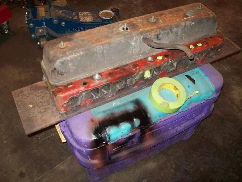

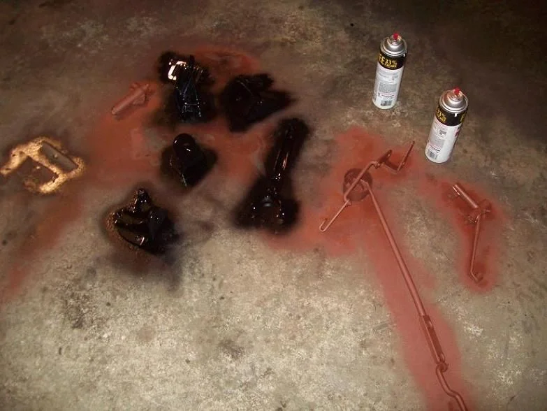

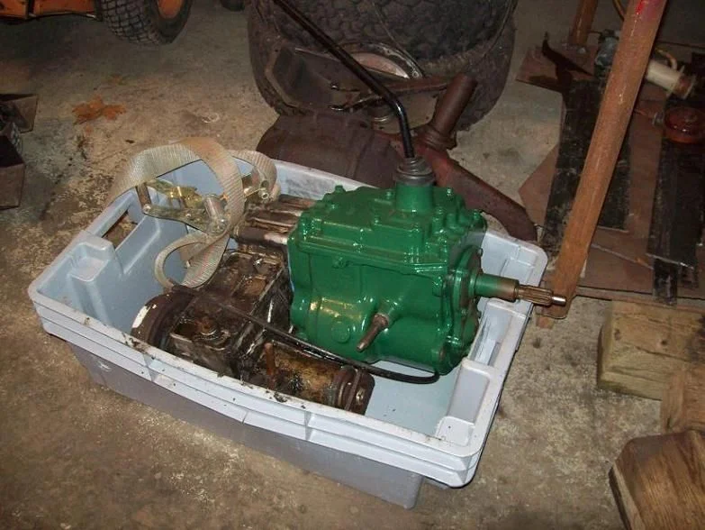

Heres a couple new ones...
Been in the cleaning parts and painting stage. Waiting for a bunch of parts to come in and need to go pickup a bunch too. Flywheel, throwout bearing,etc the last couple things before I can slam it all together and drop it in there! The 4speed/3speed case setup is done, just wanted to get the case water tight before I wash it down one last time, most of the junk on there is soapy crud.
Head swap will happen after the powertrain is in the truck, much more torque accurate that way. But while it was clean I figured it needed some paint!
Working on a deal with the Vortex bedliner dude to get the tub sprayed inside, bottom, underhood and engine compartment. Finaly got the cash to have the tub media blasted and a buddy has offered to help spray the paint.
Till then...
Watchin paint dry is like watching grass grow without the paycheck at the end...

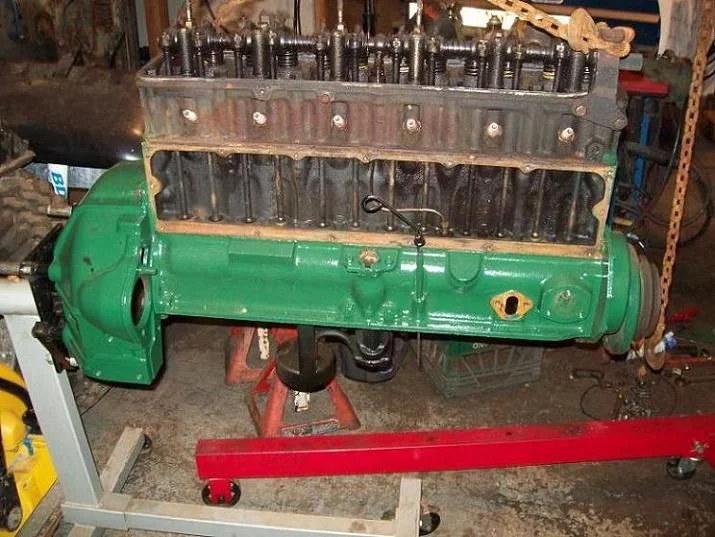

One more shot of the engine.

Black is such a boring color, besides I had some extra GREEN after I painted my plow. So I figured what the hell, everybody calls these trucks 'fast tractors' anyhow, why not paint it a tractor color
I realy need to get it moving with most of the pieces attached within the next couple months. I am moving my shop and having it all almost together would save me a bunch of hassle.

Its getting closer.... threw the rest of the head/pushrods on this AM! Stripped the wireing harness out of the doaner yesterday, after I am done with the hulk it will be on its way north to VT full o spare parts! Today its back to clean, prime, paint, bolt... repete...
Coolerman, your post is totaly Sig worthy... thanks the girlfriend will love it
