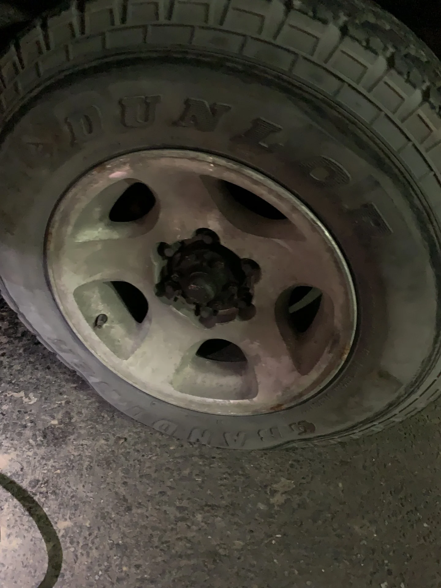

Got a flat this weekend, that was so bad that it ripped open the tire. I then found out that the spare tire, which was mounted under the vehicle for the last 10+ years, was deflated. This caused the tire to separate from the rim, which allowed small gravel and pebbles to be wedged in between the rubber tire and the aluminum rim. I was able to remove most of this with a flathead screw driver and pliers, but did knock some of it inside the tire. After reinflating the tire, air continued to slowly leak out. I needed to use a portable pump to keep the air pressure up until I made it to a tire repair place.
In my other car, the tire is inside the trunk and protected from the elements. Does anyone have any advice on keeping the spare tire in good condition if you are lucky (or unlucky) enough to rarely use it?

I realise the picture is of your flat tire, is only stored temporarily but it is upside down. Having the finished side of the wheel facing up will keep it in better condition away from the elements.

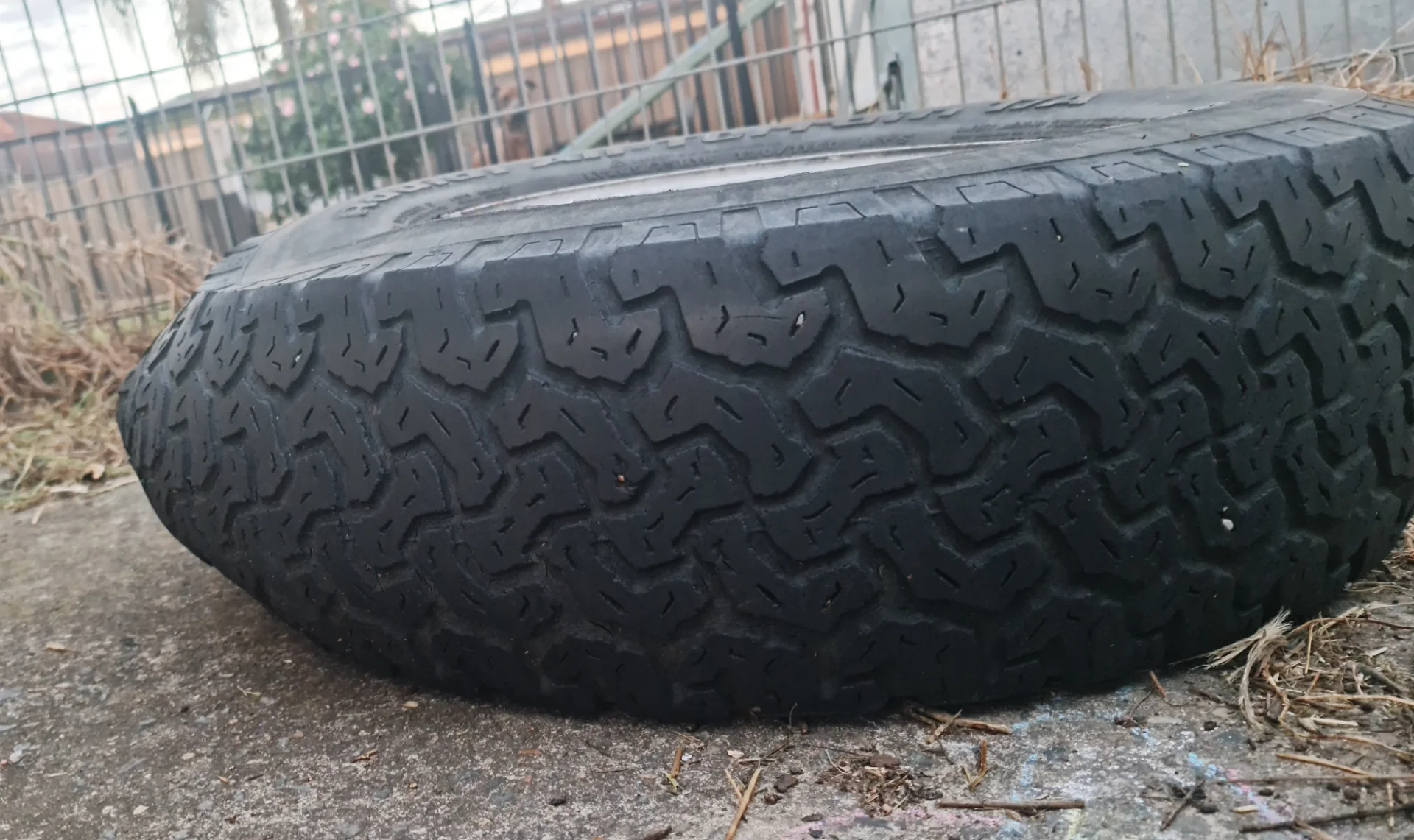

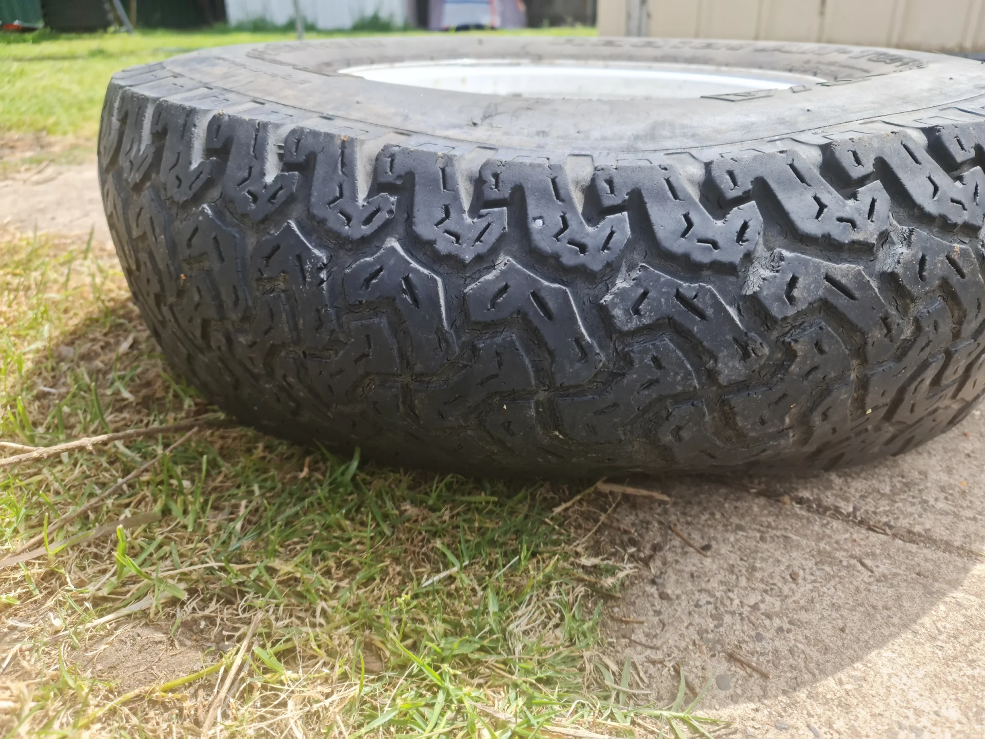

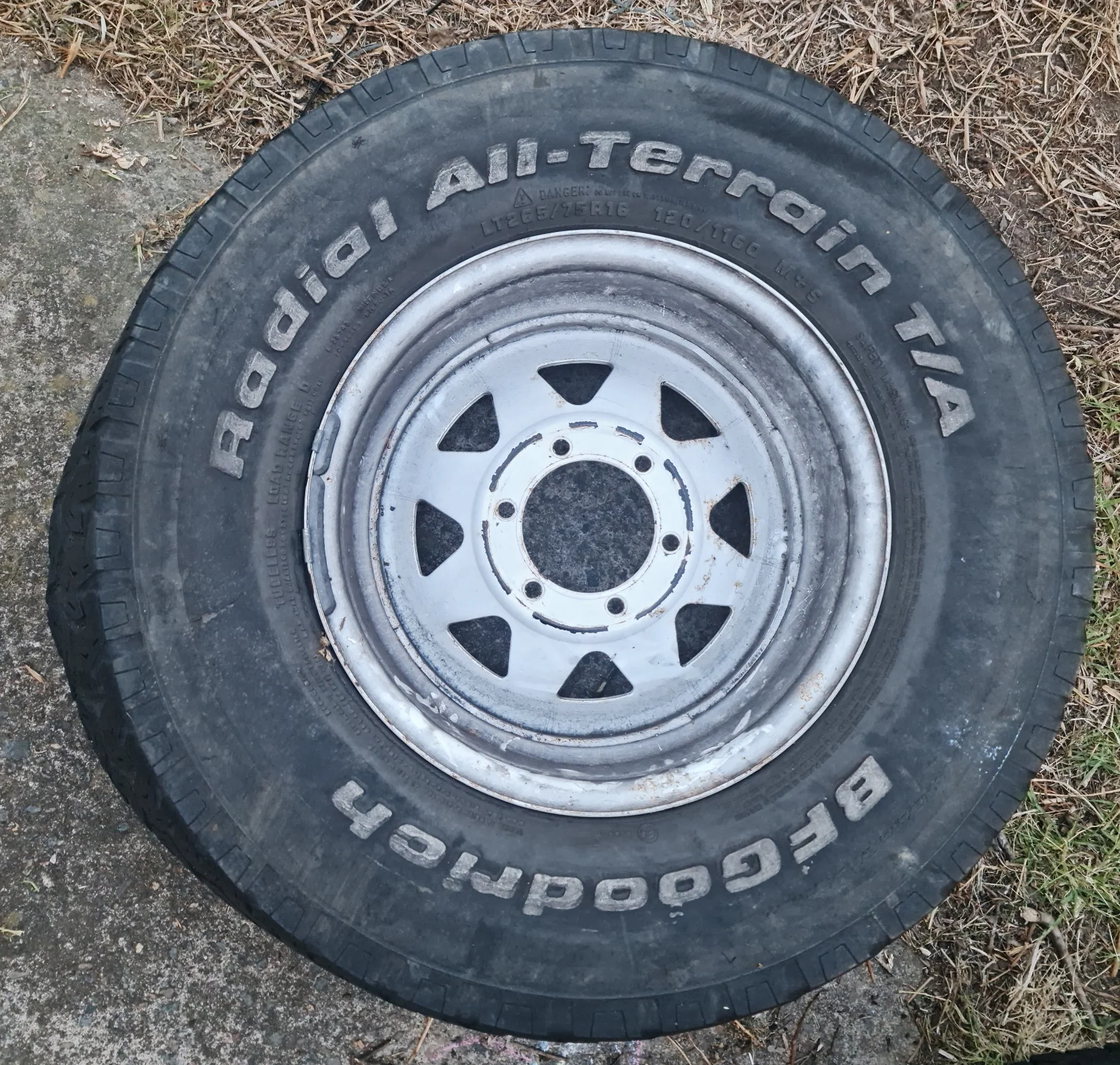

I didn't bother too much with the idea of covering the spare on mine, but I recently had an incident that's making me re-evaluate that. I bought three spare wheels for my 80 from a guy here locally a few months back, with used but serviceable tyres on the rims. Since my rear tyres were shot, I swapped in two of his for mine to get me through until I can replace all the tyres with new ones. I drove like this for weeks around my local area. First time on the highway though, it drove fine for around 30 minutes or so. Enough to get me where I was going and start the trip back. About 10 minutes away from home though, I noticed a slight wobble developing. Being close to home, I decided I'd continue on and check it out when I got there. Then it got worse. I pulled over. I couldn't immediately see what was wrong, but I inspected my drive train, satisfied myself it wasn't anything serious or mechanical in nature, and decided to slow down a bit and limp home. It got worse and worse. By the end, it felt like I was driving over a brick every tyre rotation, but I got into the driveway. Then I saw what the issue was. My rear passenger side tyre was no longer round:
Best as I can figure, this was used as a spare on the back of the 80 of the guy I bought it off, and it was parked in the sun. The UV hitting the top of that tyre day in and day out for years did a number on the rubber. The top section which was most directly exposed here fared the worst. The tyre looked perfect, and drove fine at first, but as soon as I got it up to a good temperature from a proper highway run, with a decent hill climb and descent, the uneven weakening of the tyre from the UV exposure caused it to let go in this odd way. The tyre didn't blow out, it still holds air, but I deflated it as soon as I caught the problem to make sure it didn't explode, because it wasn't looking healthy. As a result of this, I'm reconsidering one of those spare wheel covers.

If you expect your spare to live much longer, I’d at minimum dismount it, JB weld the pebble scoring in the rim beads & smooth, let dry & really clean the bead ring of sand/dust/grit on the tire.
Or buy a extra stock wheel & get a new tire if that mis-match I see PF is 5+ yrs old.
Tread is pretty asphalt-oriented anyhow compared to your others.

This type of thing was my reasoning for getting a spare tire cover when I recently had new tires put on. 315's are too expensive to just let one get cooked by UV.
