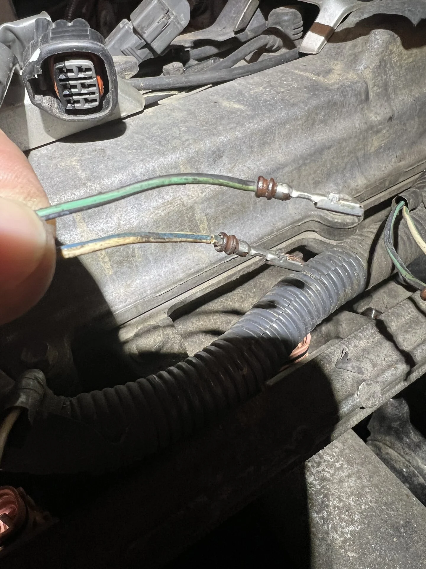

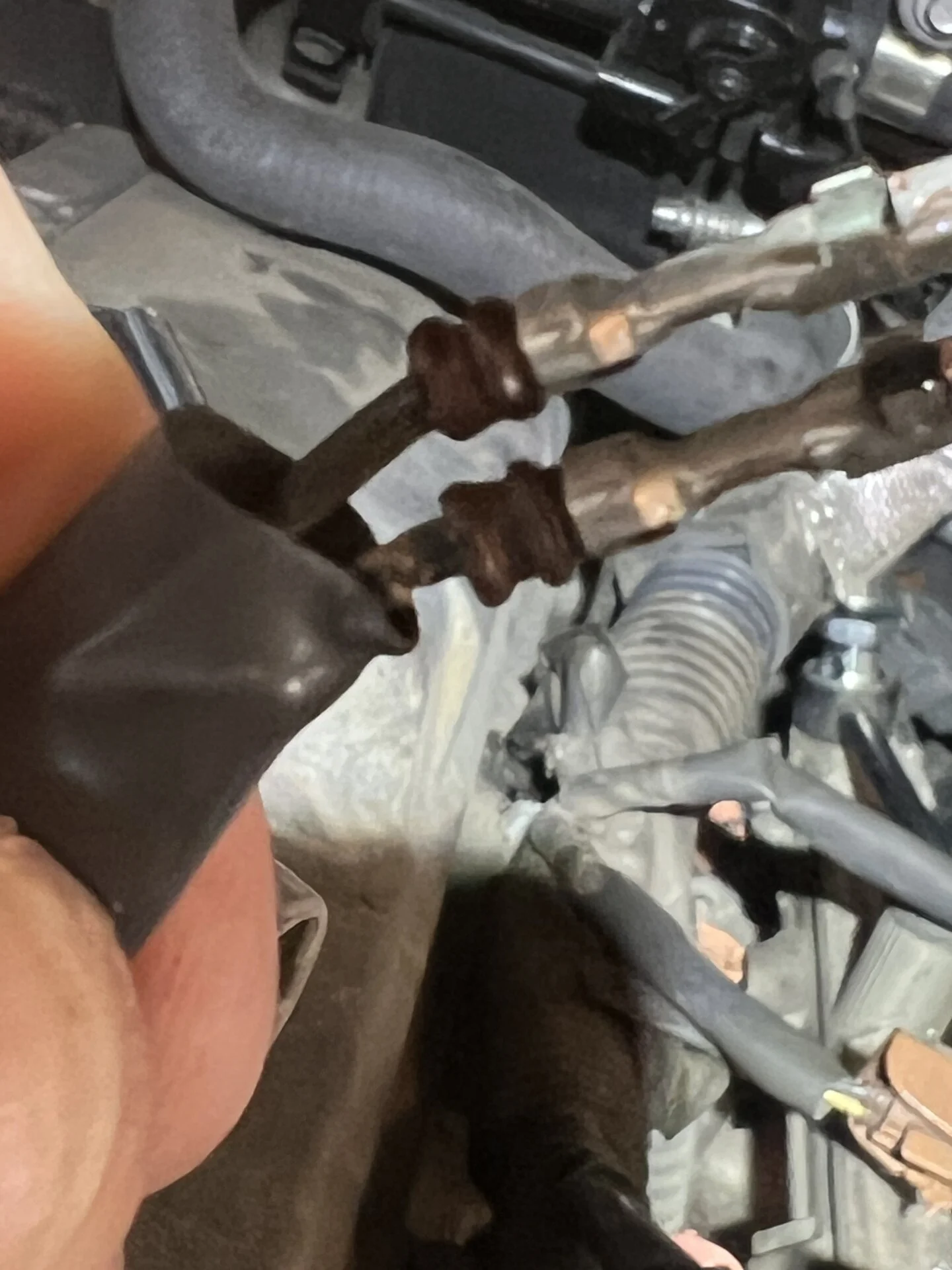

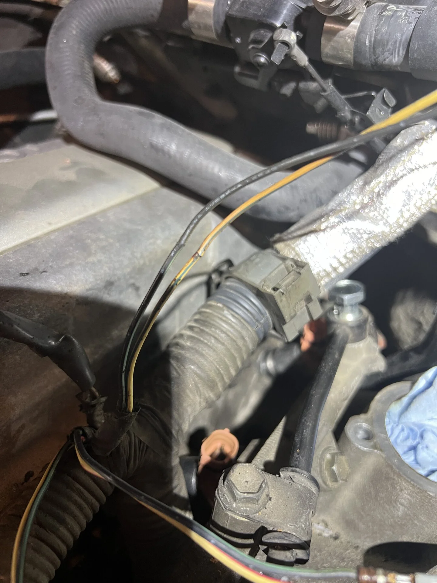

I mentioned on another thread that I was having my injectors rebuilt for my 1994 1FZ. I had ordered connectors from Ballinger Motorsports, but once I looked closely at the injector wires, I found two with broken sheathing/exposed wire and two that were cooked along a significant length and the sheathing was broken in two places on both wires (#6 by EGR, no surprise). The pins on #6 were very corroded too.
So I reached back out to Ballinger and ordered a set of connectors with pigtails (yes, I could have spliced my own, but would prefer the peace of mind of a known good crimp on the injector connection pins).
My first question is how do people recommend attaching these pigtails to the factory loom? Crimp butt connector, solder the joint, something else?
My second question: to inspect the wires, I destructively removed the plastic wire loom cover around the wires to each injector. I'd like to replace it with something suitable. I could use heat shrink, wire loom or something else, but don't know what approach might be best. Is there a product available that is similar to the factory protective wire loom cover? Does anyone have recommendations?
