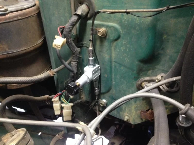

I know you prolly saw the title and thought wth ? . I have been reading old posts like a mo fo, I am looking for which proportioning valve a guy should buy that would be best for my application. Stock booster/ mc 75 fj40 77 disk fronts but am waiting and gathering parts and pieces for rear disk swap. I checked out summit racings page and there is a multitude of proportioning valves , Which one thanx Neil.
I used wilwood cause it's the same brand of brakes I chose to use.
I was wondering more if some came threaded metric or are they standard ? Does it come with the fitting's and then you have to do the flaring ? Thanx Neil
There was a thread some time back with the discussion of metric vs SAE. There were part numbers posted of metric-threaded versions. I don't have time to google it for you just now. Add "site:ih8mud.com" to the end of your google search.
Mine was sae- 1/8"x27npt. I also used swagelok fittings to the hard lines. (3/16"x 1/8")
Can I ask where you sourced the adapters thanx . Neil
Thank you.:beer:
I went with Wilwood because they are at all 4 corners. For fittings I simply purchased the SAE fittings to match the valve and cut the brake line where I wanted the valve and slide on the SAE fittings before flaring the lines. No adapters necessary.
I have the Wilwood proportioning valve as well - used fittings to adapt the NPT to AN, and AN to 10mm Toyota - fittings came from Earl's
Wilwood as well, did the same thing as DSRTRDR
I did this too, super easy solution. I think there is a part number lurking in a thread somewhere, but it's easy to work out from the swagelok website too.

I too have the Wilwood proportioning valve. I adapted the NPT to AN, and AN to 10mm Toyota. The adapters came from Summit.
