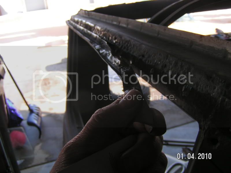

I spent the day hand chiseling the rusty remains out of the drivers drip rail, then grinding the left over spot welds, then cut out a bad section, and got access to the hole on the rear window pillar. It is a lot of work, and I am grinding and cleaning up spot weld that may get replaced, but I am committed to preserving as much original steel as possible. A lot of extra time, but will minimize the impact on the final product. I just really hate to cut good steel when there is another way.
Anyway. I figured I would do some of this, before I finish cutting the donor pigs roof. Thanks again Frank!

Microsurgery on the inner roof structure.
Sure, many pros will say this method is a waste of time. Good point, it does take more time. My goal is not only to fix the rust, but to do it with minimal impact to the original steel and structure. I call it microsurgery, it looks like this...
First, I marked off the bad areas that have to go.
Next, I removed the roof rails...
A couple pictures of the sections removed. Next step will be to graft in patches from the recently departed Frankencruiser.
