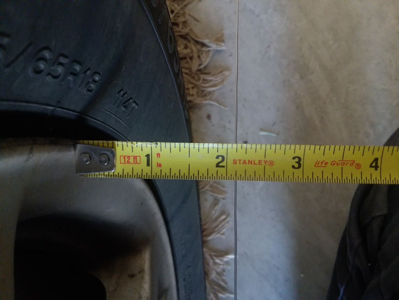

finished the alignment. the last step is setting toe. unlike the previous video which only gives you overall toe, I'm using a different method to measure toe on each side. it's a little tedious but i managed to set toe to 0. i used jack stands and 30lb fishing line which is all i could find thanks to the virus.
it could be stretched and stay taunt while giving very precise measurement. basically you move the jackstands until the distance between the string and the rim of the wheel is the same in the rear. measure from the back and front of the wheel to the string.
once both measurements are the same move to the front and measure. mine was a little off. iirc it had too much toe in.
then i basically made an adjustment to the tire rod on that side to move it in and out accordingly.
after making an adjustment you have to move a jackstand and pull the vehicle forward or backwards a ways so the adjustment can be measured. if i had set the tires up to spin with the bag and oil method like the video, this wouldn't be necessary. i moved out of the garage a car length and pulled back in, then set up the jackstands and remeasured. i goofed a couple times and moved the TRE the wrong direction. this made it take 3 times longer than it should have because i didn't realize what i had done. took me about 2 hours. should only take 30 minutes. but i took it for a drive and it's tracking straight and my return to center is good as well. need to get it on the freeway to see if the caster is enough at 75mph but i think I'm good. shouldn't need aftermarket UCAs unless my tire choice doesn't clear the stock uca.

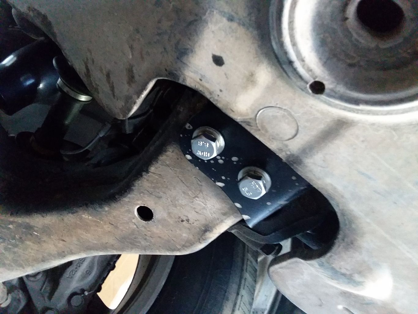

got around to drilling the the holes for the LCA support bracket that came with the ironman kit. i hear they're not result l really necessary on gas engine LCs but whatever. it was easy. had to put it up on jackstands to have enough clearance for the drill.

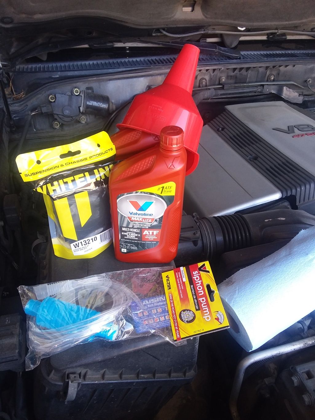

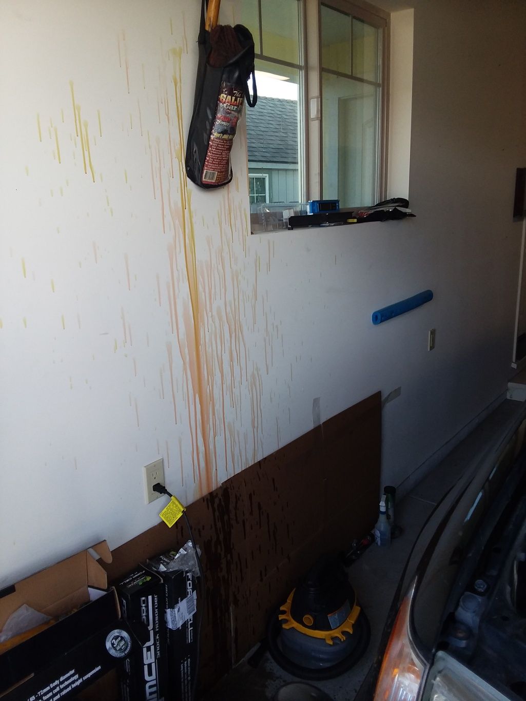

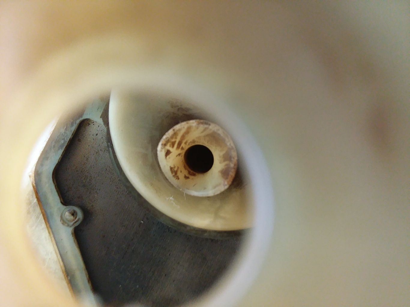

well flushed my power steering fluid. spent a good 1.5 hours cleaning the reservoir. its probably never been cleaned. look at that gunk on the screen! its maybe never been flushed. also made a goof and shot PS fluid all over the garage.i can laugh about it now.

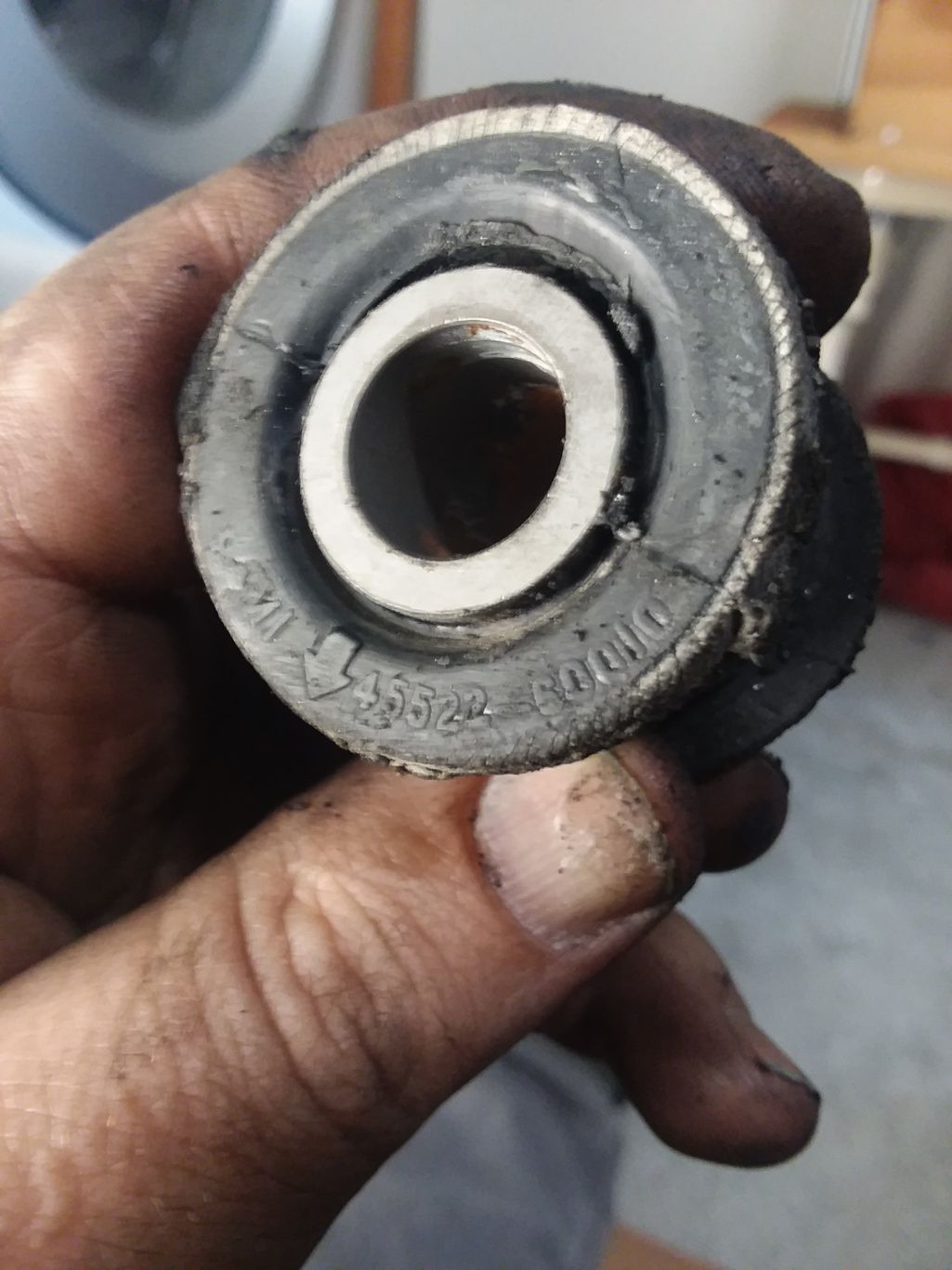

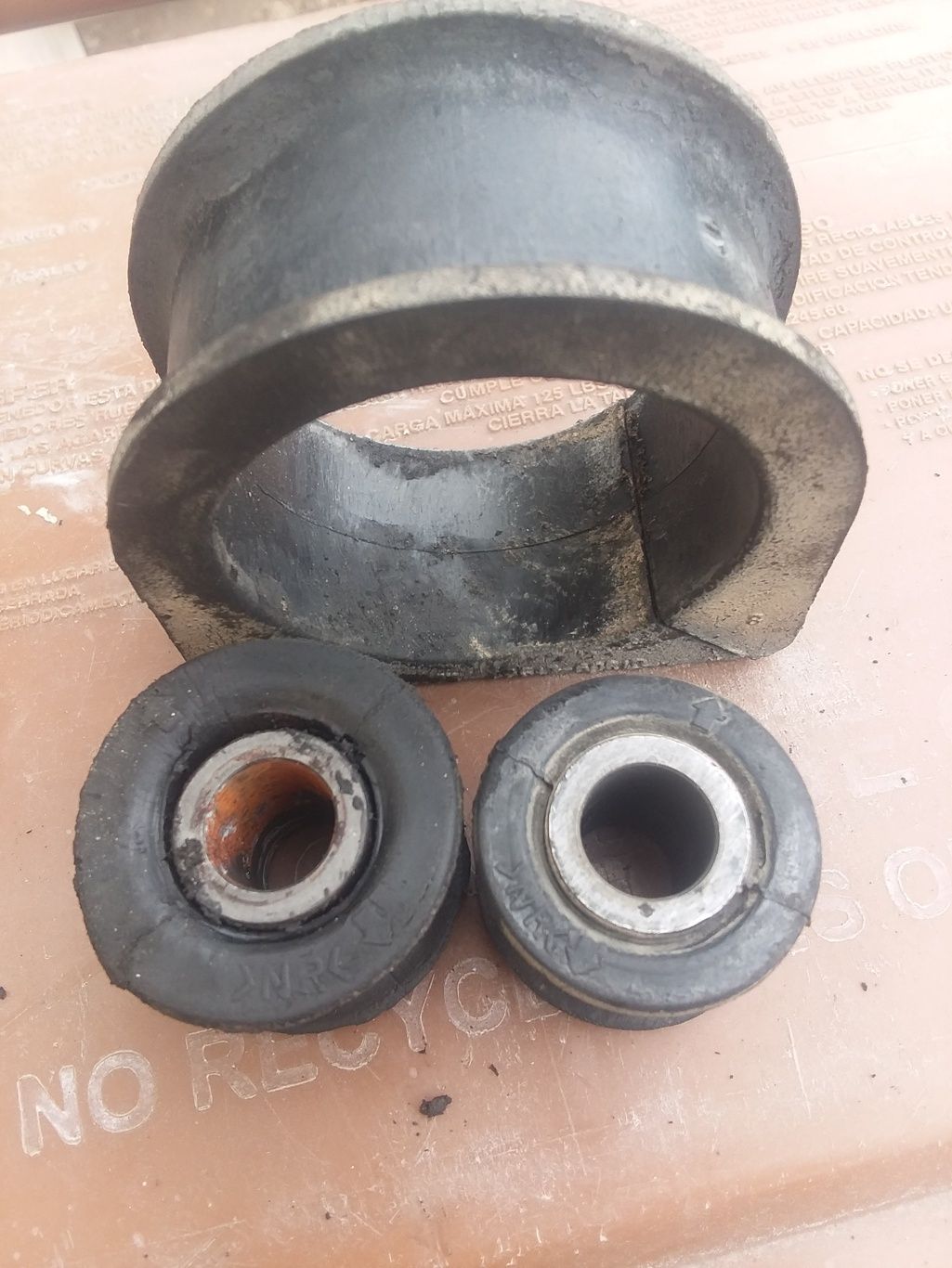

Installed the whiteline steering bushings today. Did the whole thing without jacking up the truck. I had to unbolt one steering arm from the knuckle to have enough room to slide the bushings in. Using the bolt and washers to pull the top bushing in was the necessary trick. Old bushings didn't look too terrible but they were definitely allowing movement. They are much softer.
steering is much more precise. i didn't really have a problem with the steering before but it's very responsive now. the power steering pump makes less noise as well. it didn't really quiet down after the flush but this made it quieter. it wasn't particularly noisy before but i was starting to notice the sound.
Worn bushings
Whiteline bushings
btw a 5.5 inch bolt would have been better. the 6" was too long and i had to use washers to space it down.

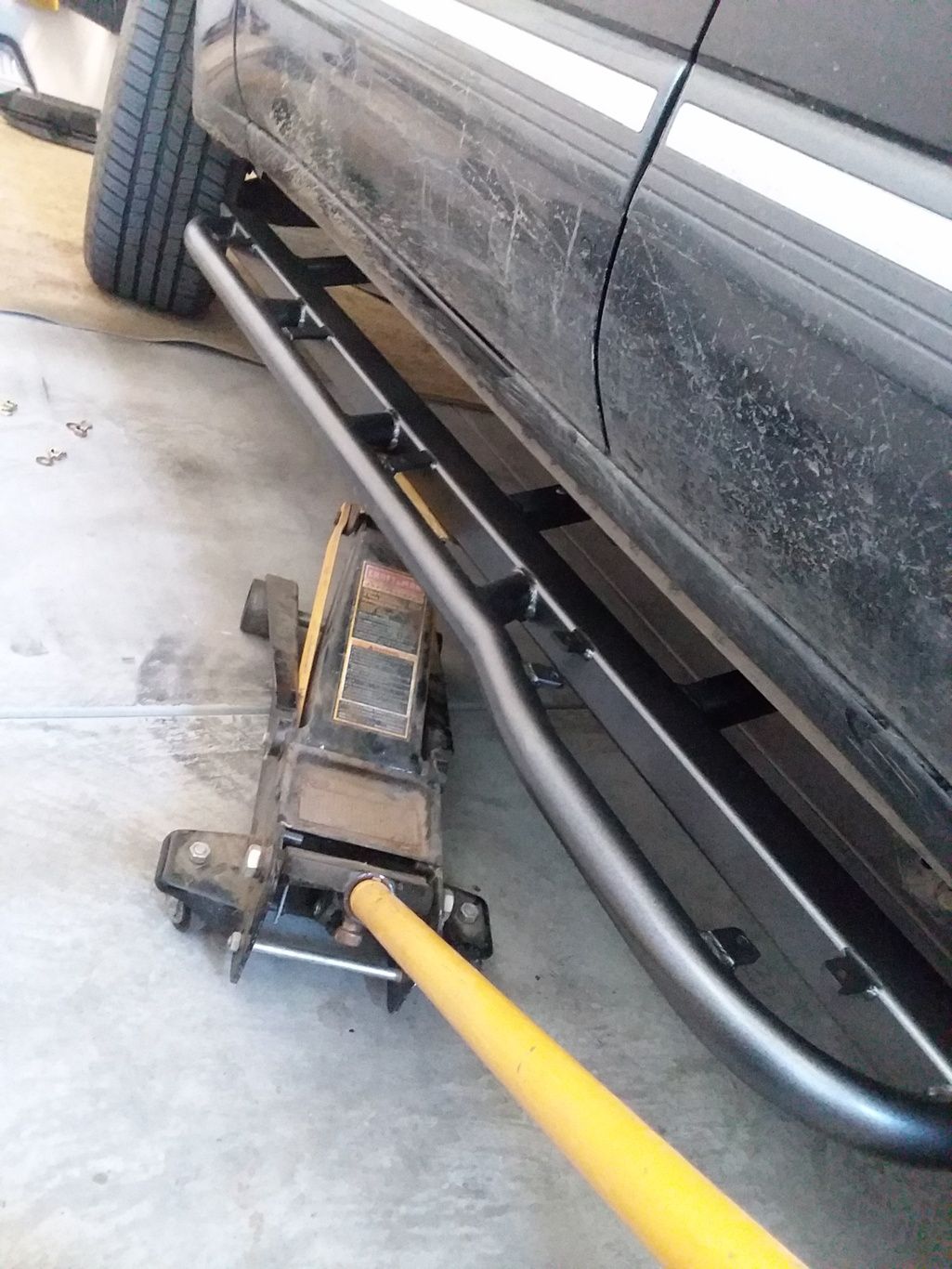

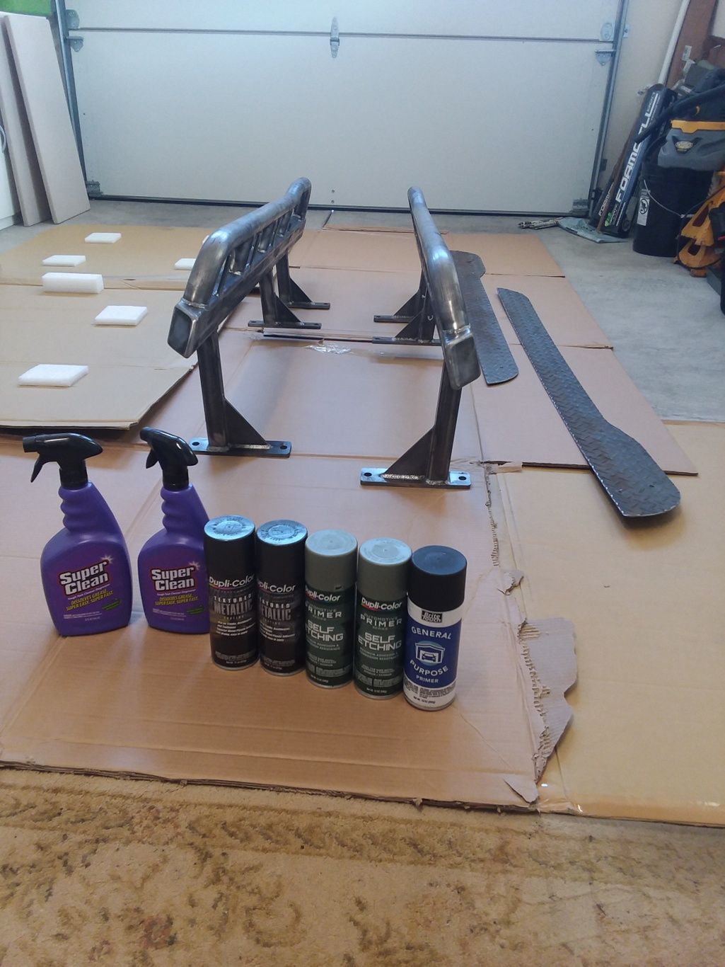

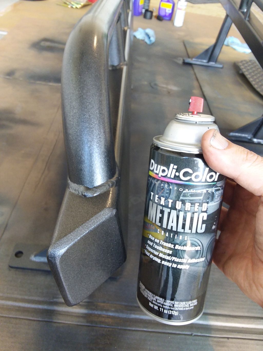

picked up my white knuckle sliders this weekend. today's project is painting them. its taking much more paint than i expected. i had to buy extra self etching primer. the rustoleum stuff goes on waaay better than the duplicolor. might have only needed 2 cans if it was all rustoleum. otoh the rustoleum gloss paint i also used for the underside is taking fooooooorever to dry. I recommend flat so it dries faster. this duplicolor textured metallic is interesting. not sure how it will look on the black Cruiser. i got it hoping to give the sliders some traction without being overly aggressive as to tear up clothes and skin when getting out. if it doesnt look right I'll just do one last coat of semi gloss black over top.
Well I see I've met my clone... same suspension, wheels, bumper, and color lol

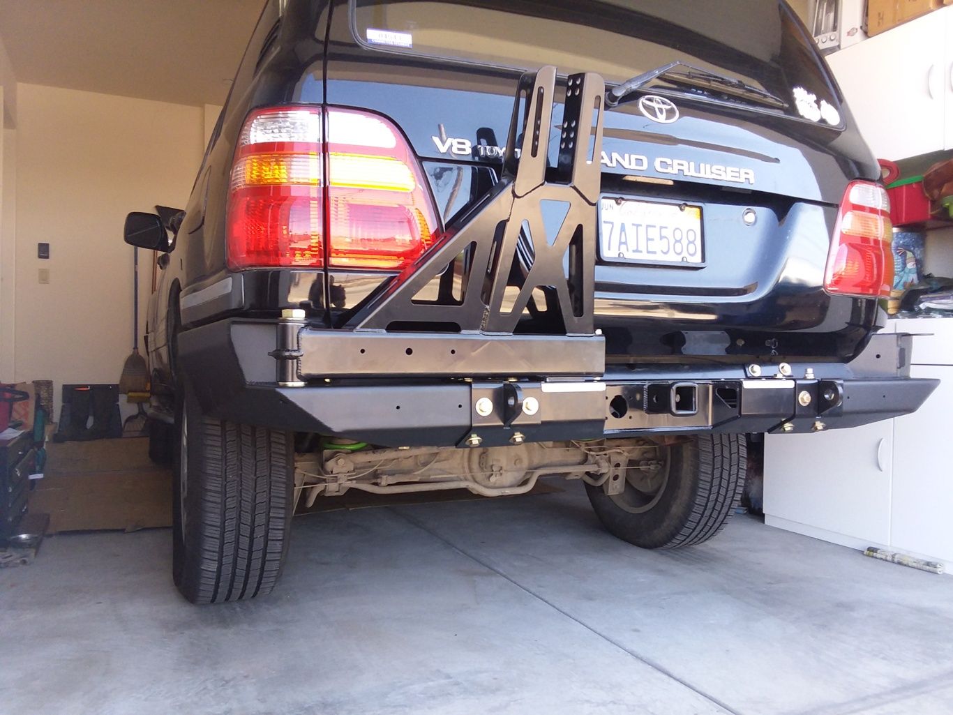

got most of my Dissent rear bumper mounted today. i really lucked out getting this bumper since Ben doesn't make them anymore. i really wanted the high clearance of his original design and didn't mind cutting out the rear cross member. i love the looks of this bumper and the functionality is unmatched. I'm still in the process of finishing the tire carrier and second swing out.
some install pics

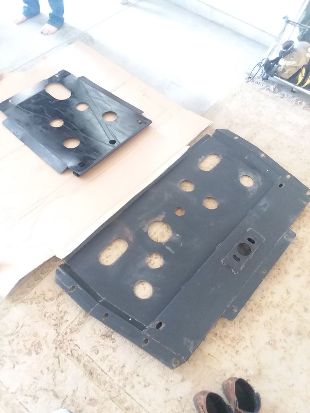

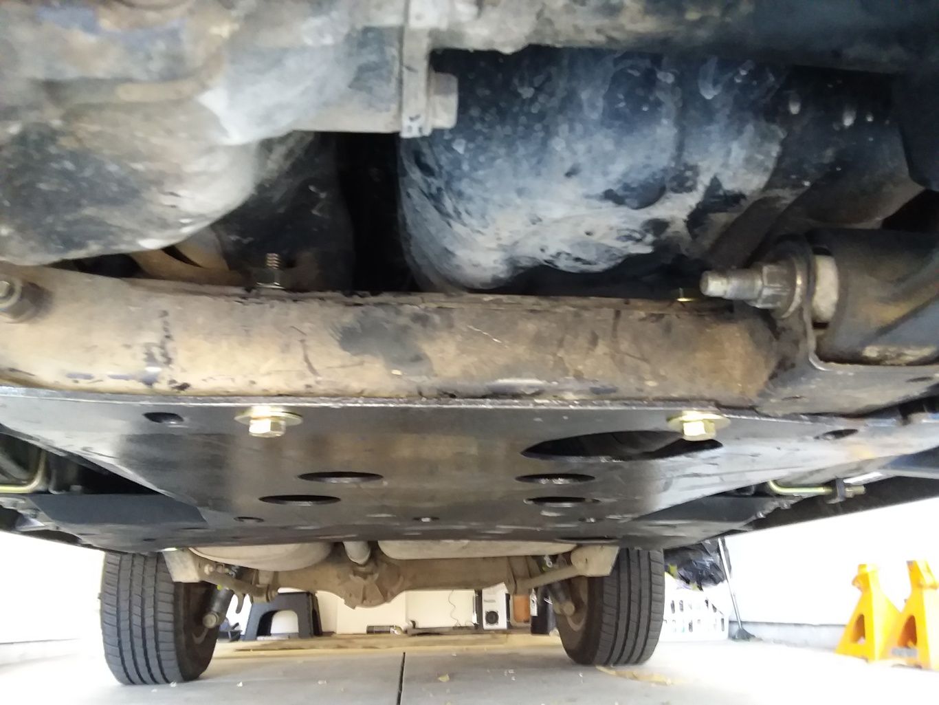

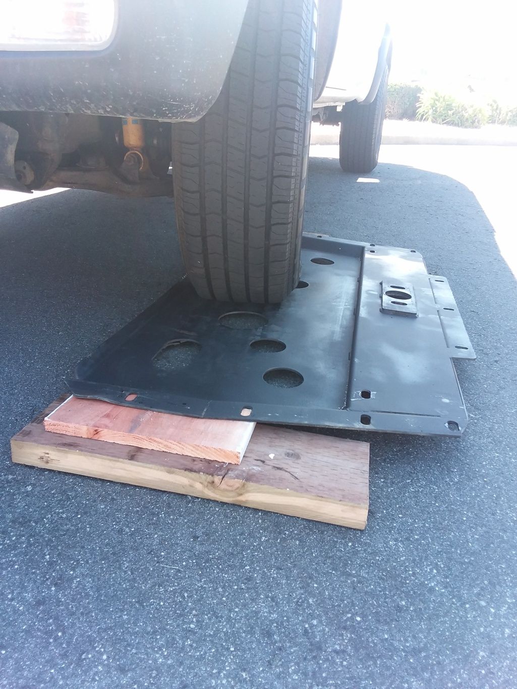

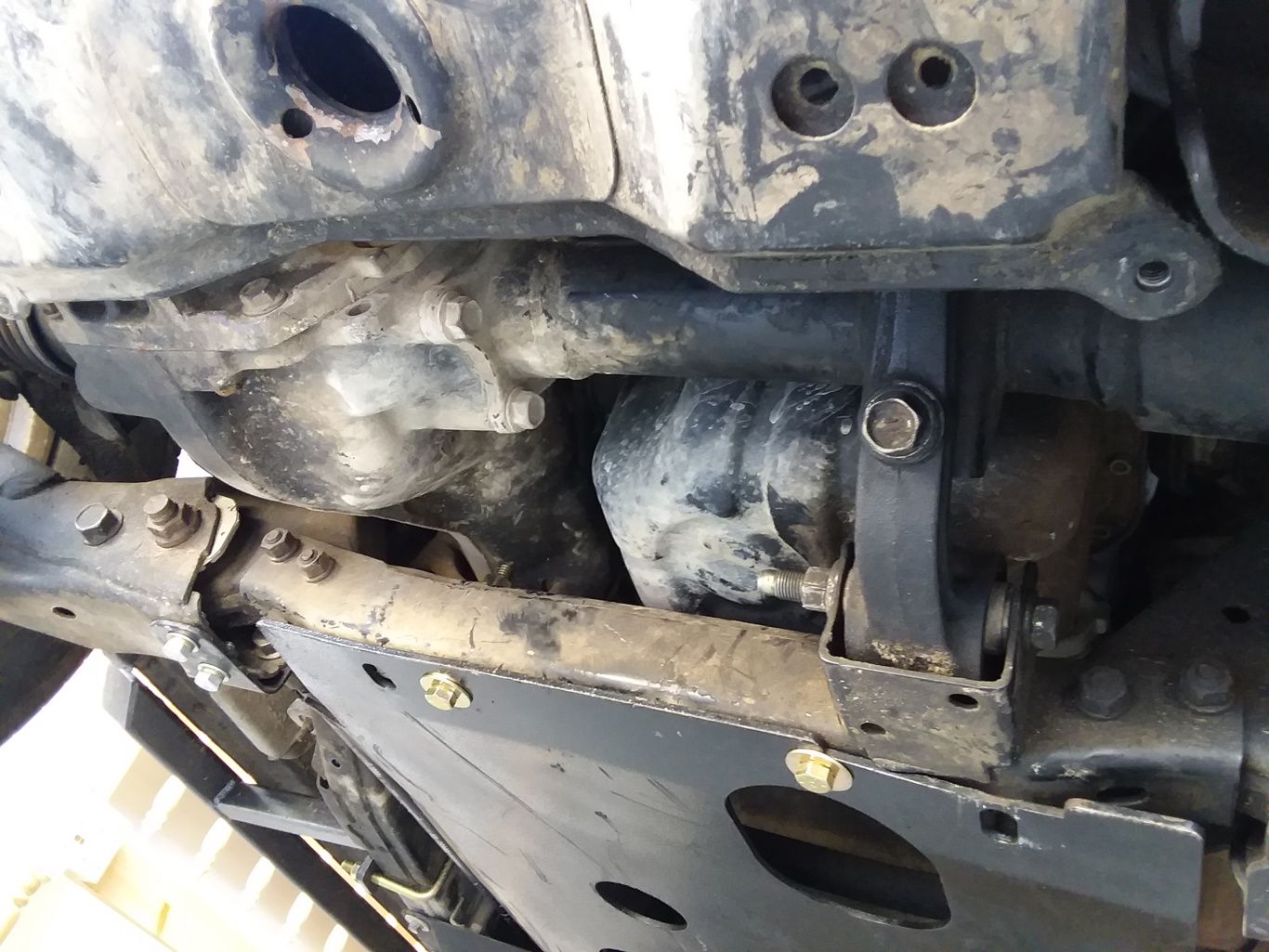

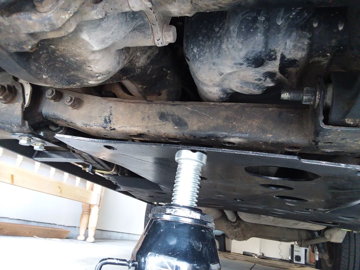

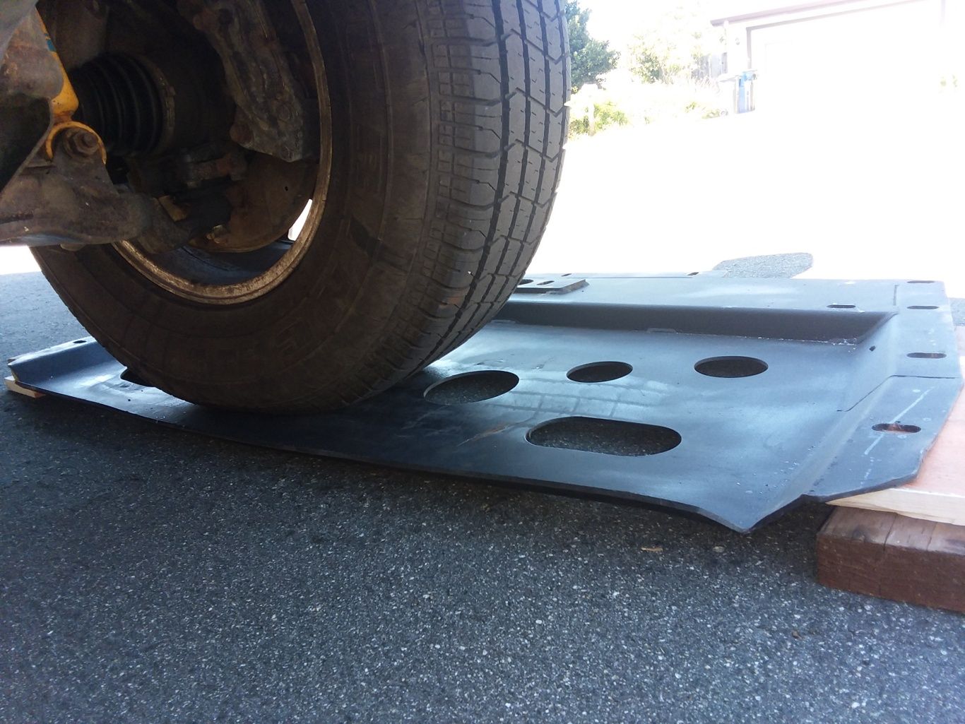

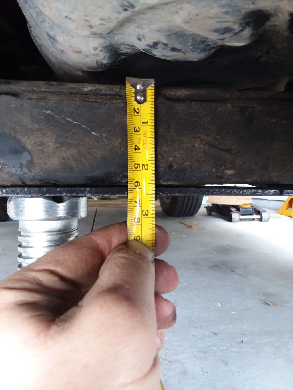

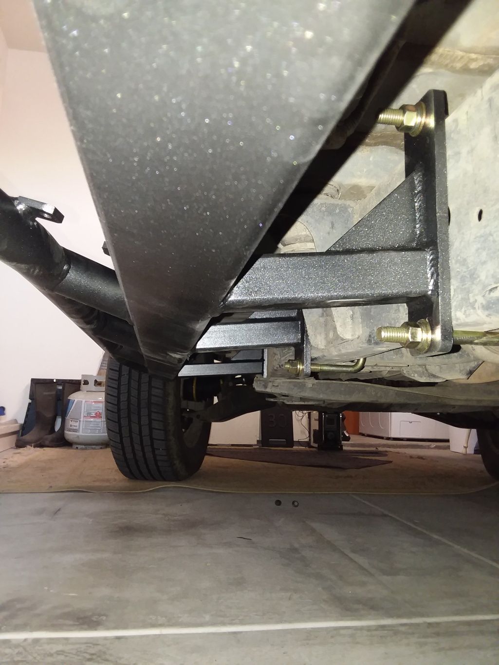

picked up some well used slee skid plates from @hoser on Sunday. i got the belly plate and intermediate plate. Slee says you need both the belly pan and the front skid to mount the intermediate plate but i was able to mount it without the front skid by drilling some holes that lined up with holes in the stock diff cross member and through bolted it with some 3" long 7/16 grade 8 bolts. 3" long bolt is just barely long enough to get through with 2 washers and a nut and clear the oil pan. if you had a diff drop it wouldnt be a problem and you could use a longer bolt with a lock washer (which i did on one side).
those holes in the cross member already go all the way through. i just drilled the skid plate.
the bolt on the left in the picture is 3.5 inches and has a lock washer on top. a 3.5 wouldn't fit on the right due to the oil pan.
this last pic is the gap between the stock front skid and the intermediate skid. i handled it by bolting the splash shield back on over top the skid. i could have left it off entirely and been fine. i plan to order the front slee skid imminently so I'll deal with it then. you don't need the slee diff drop to do what i did but i think I'll need it when using the front skid depending on how it bends around the front cross member and diff. besides it will probably have the proper welded nut locations so i can just use bolts. and lowering the diff probably isn't a bad thing.

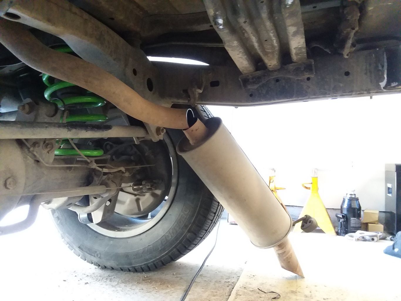

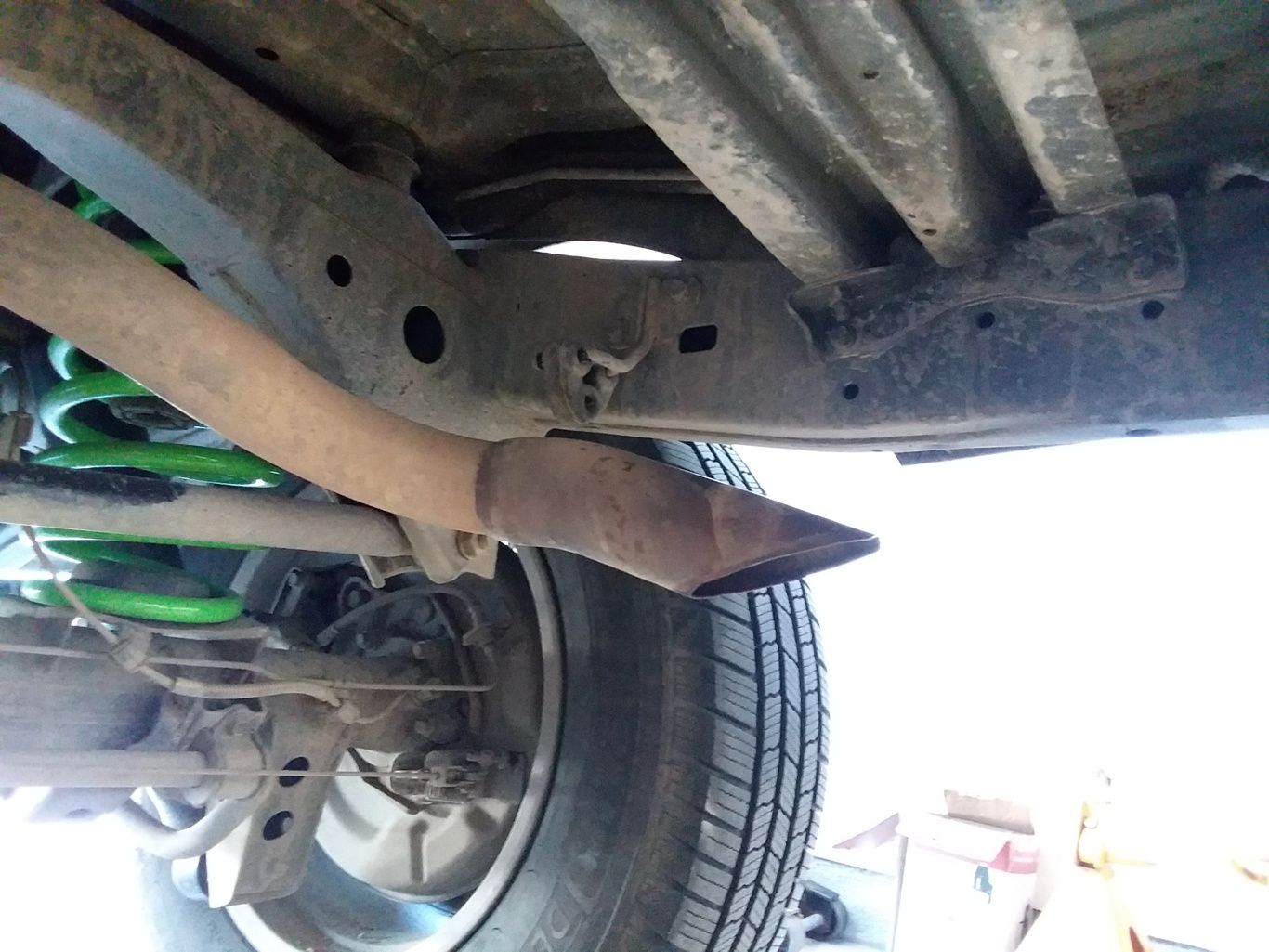

unintended consequence: engine noise seems much louder. it must be reflecting off the intermediate plate. not sure i like that aspect.

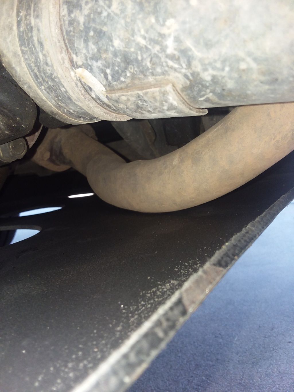

edit: now i think the exhaust is contacting the belly pan since its bowed a little, leading to vibration congruent with engine RPM. :hmm:
fixed the vibration! had to straighten out the skids
the exhaust was contacting the skid previously.
after straightening i still had to relieve the area where is was contacting by using a sledge hammer to dent it downward. it worked and now i got a fingers width of clearance and NO VIBRATION:clap::D
