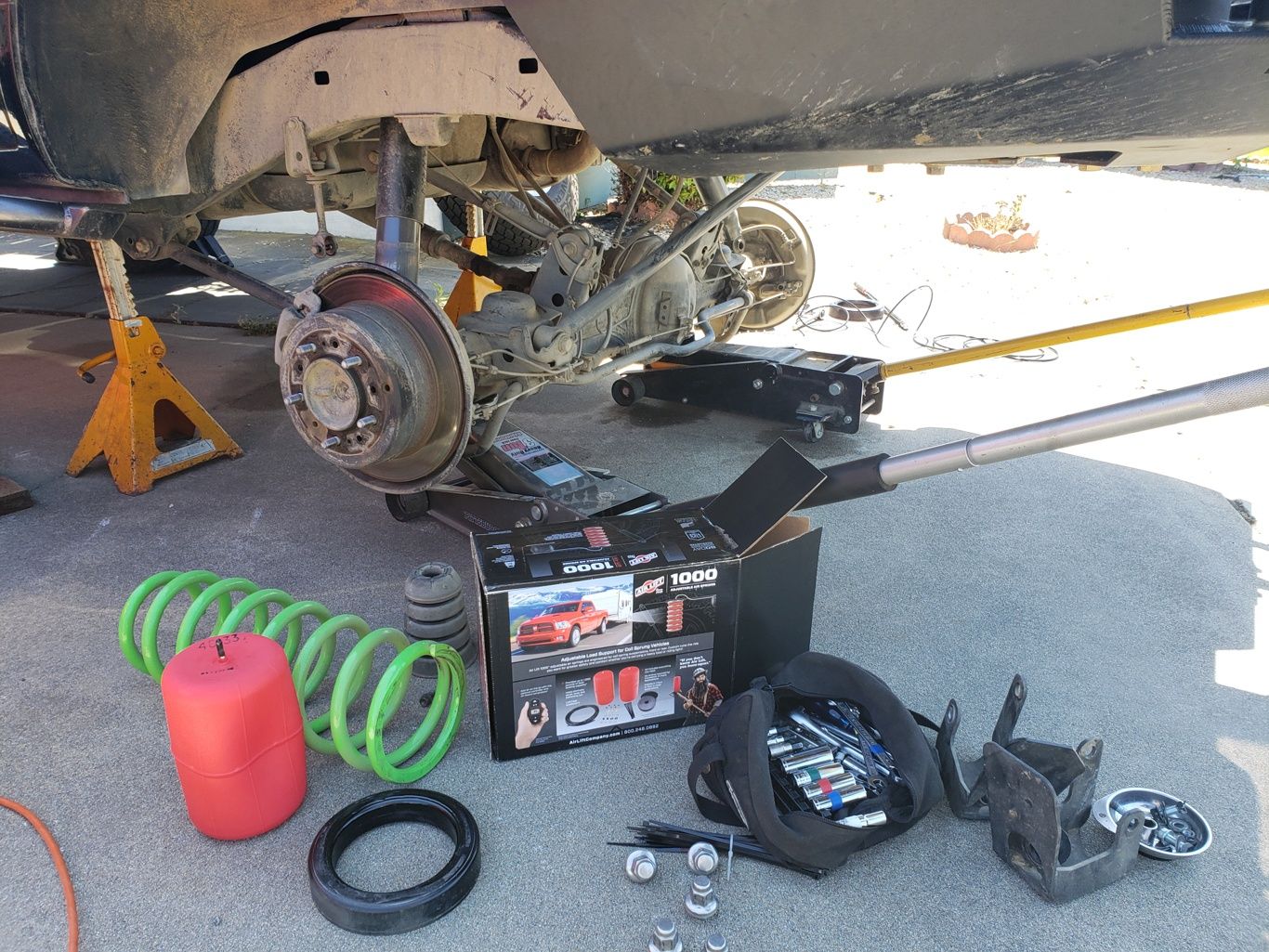

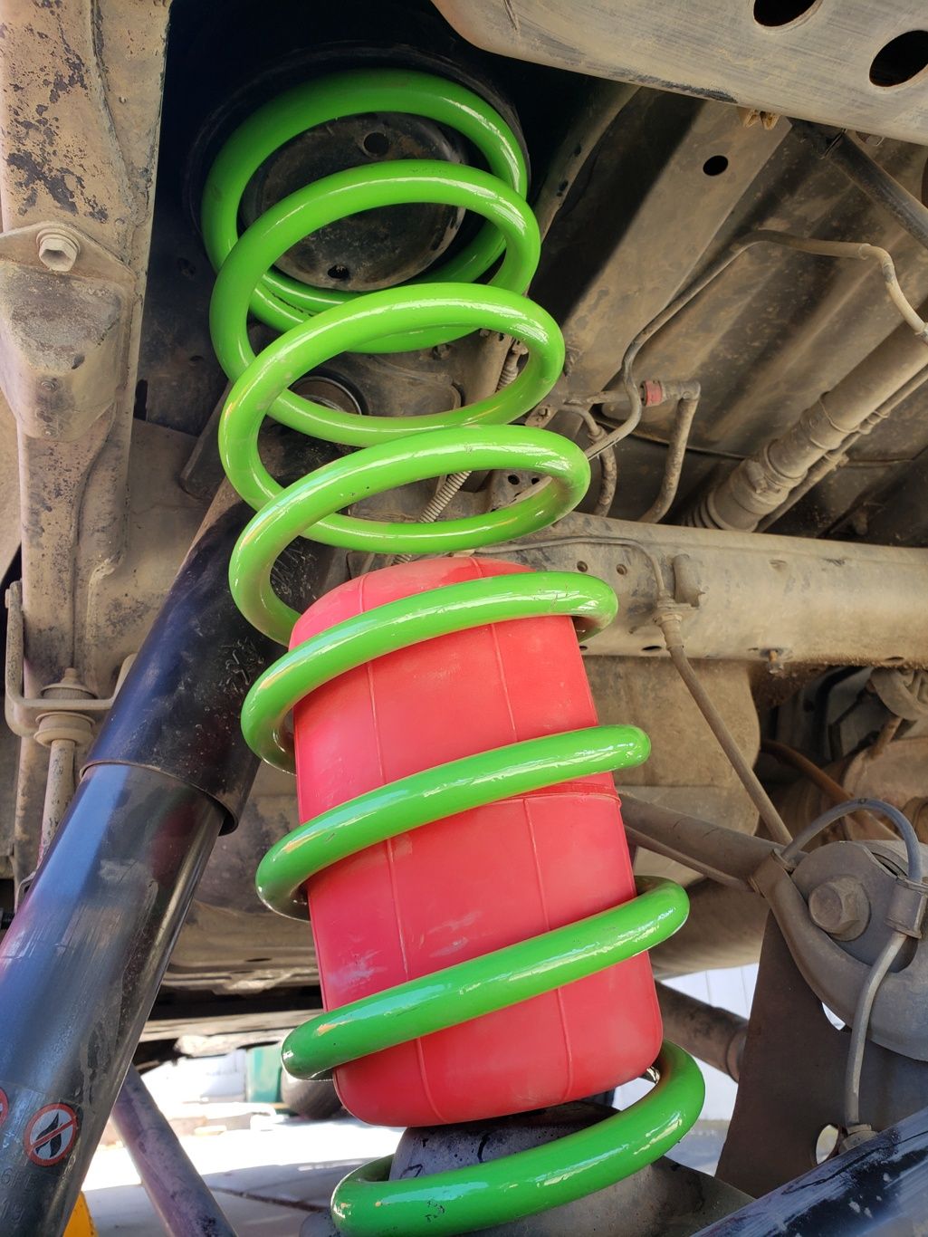

I'm getting ready to tow a utility trailer when we move and the Land Cruiser is sitting pretty level right now. I picked up some 30mm spacers to try and pick up a little rake and I also bought these air lift bags to help stiffen the spring rate when towing. I also used this opportunity to try switching the coils from left to right to see if I could even out the driver side lean a little. Result: it still leans to the driver side about the same amount. I'm not convinced there's any difference in these springs from left to right.

I was a little concerned about adding a spacer and air lift springs as I had to remove the internal bumper/ spring retainer. Does anyone know if I need to do something to keep the springs and spacer in place? There shocks limit travel pretty good do I don't think the spring will come loose when flexing but you never know.

I would imagine Toyota put the isolators in for NVH. I can't see any harm coming from removing them other than the metal/metal contact.

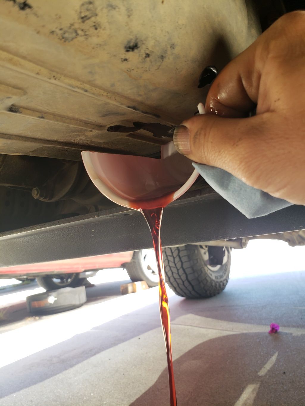

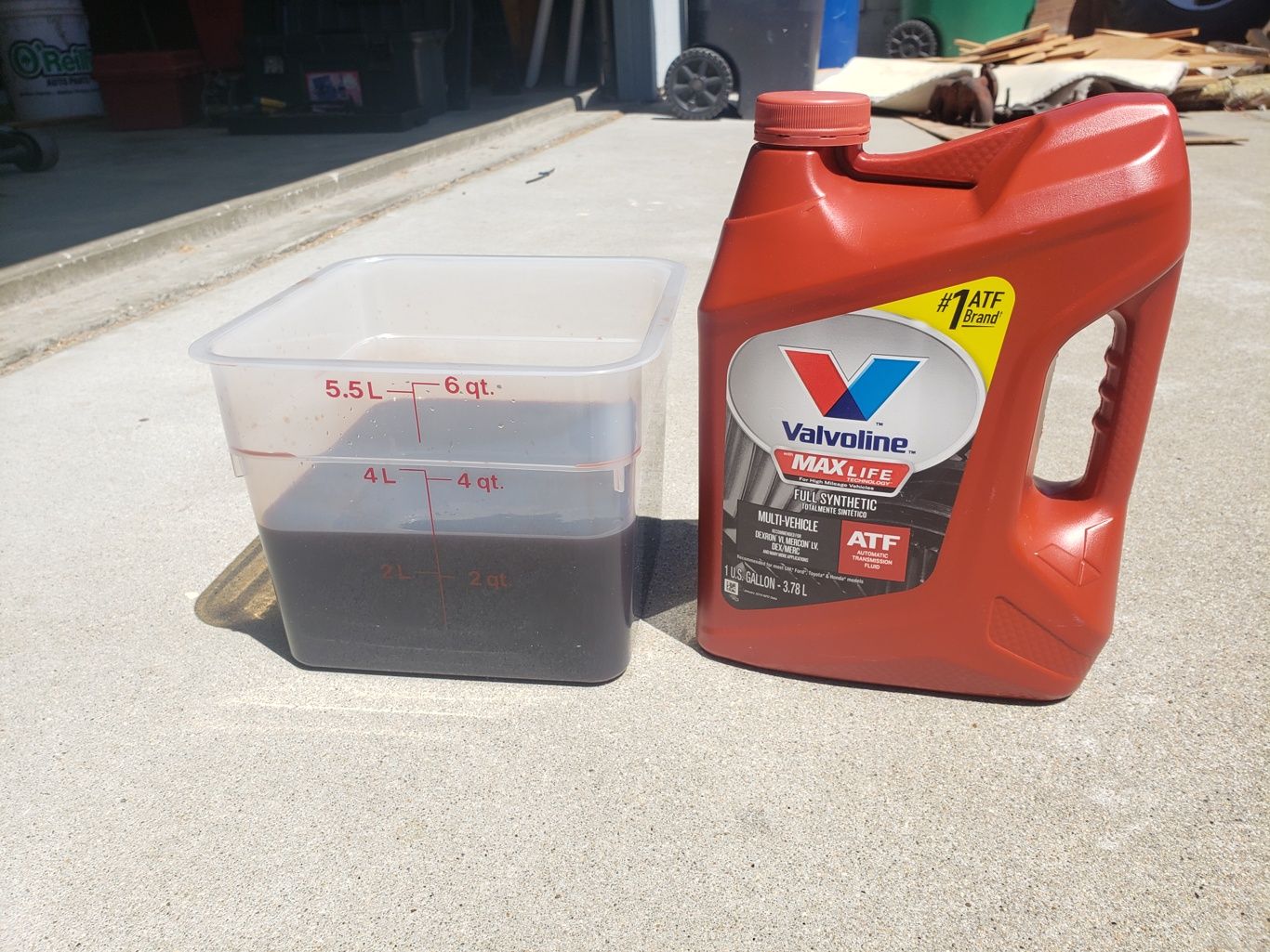

Well I went to do a simple ATF drain and fill. Come to find out, the slee skid doesn't make this easy. Not only did I have to drop the intermediate pan, but the belly pan also is in the way. I needed to do this quickly so rather than drop the pan, I cut a solo cup in half to channel the fluid into my clear graduated bucket that i got from the restaurant supply. This worked reasonably well but I need to figure out a better way. Dropping the intermediate plate is a huge inconvenience and the belly plate is a PITA.
It took right about 3 quarts.
Now my suspension looks like Christmas
Did you ever come up with an answer for this I'm looking into the same setup and have the same question.
I have not done any extreme wheeling since installing the spacers and lift springs. But i have done some wheeling and many miles towing and I am confident they will stay in place. I recently removed the spacers because i had too much rake and I wasn't towing so much. They almost glued themselves on there so I'm confident in them.
