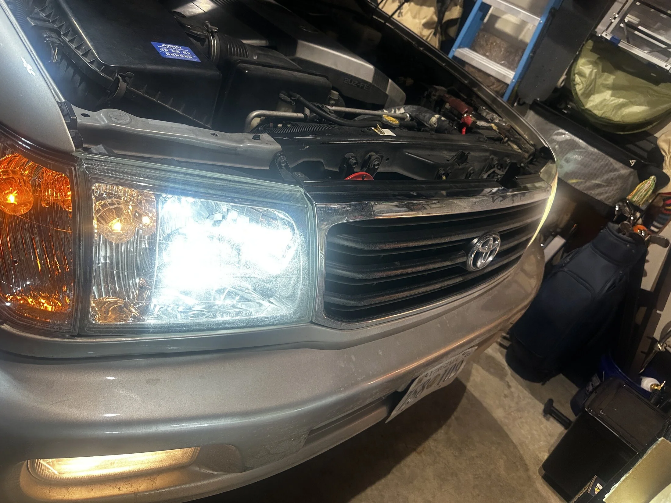

Can you tell us what you are seeing that constitutes the “serious reflector damage”?
Is the mirrored coating peeling or flaking off of the back reflector of the assembly? Is it something with the little secondary reflectors that cover the front of the bulbs?

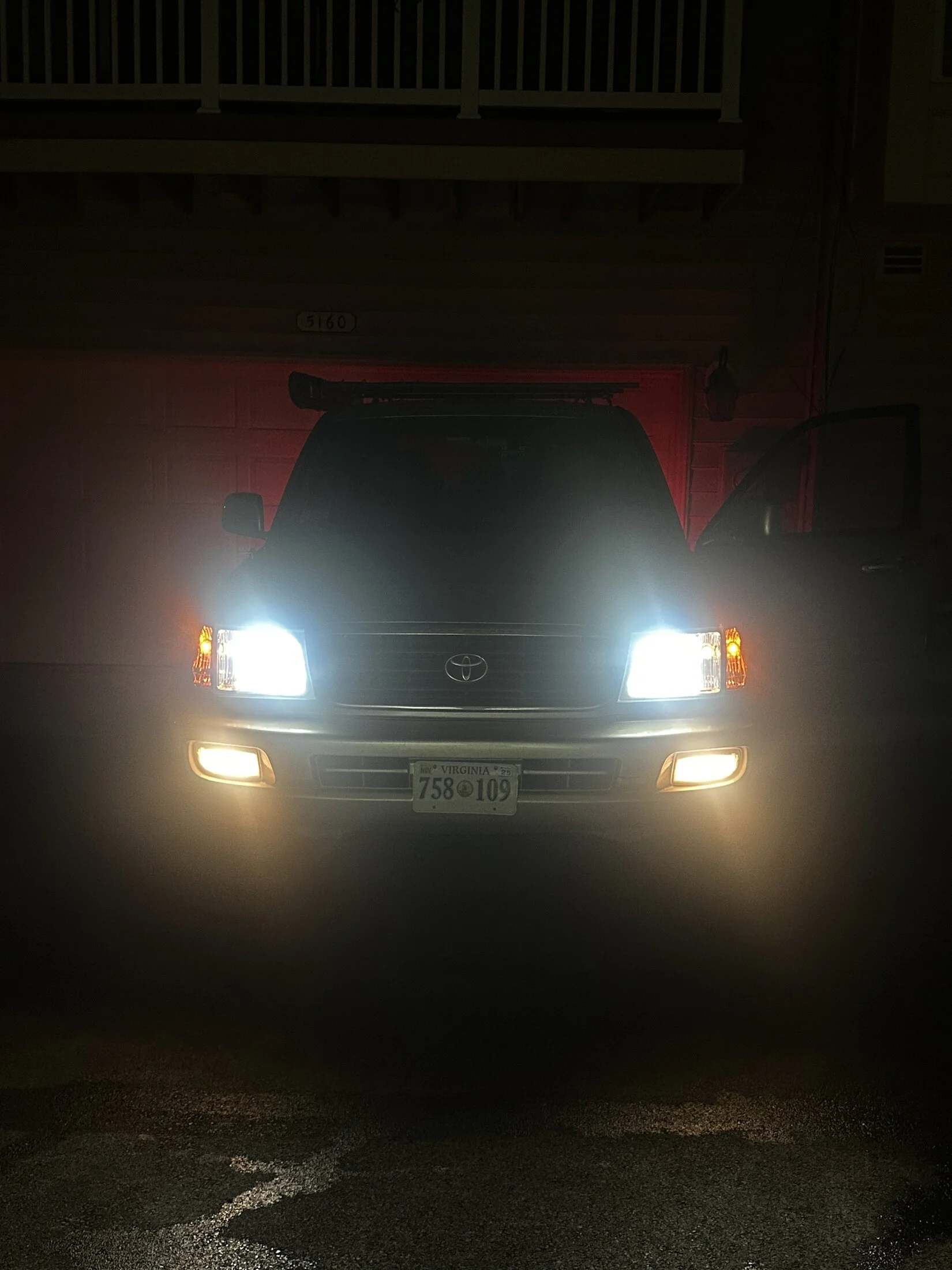

I got the SL2s in January and have been very happy with them so far in my LC. They have an LX option but it looks a bit different so can’t comment

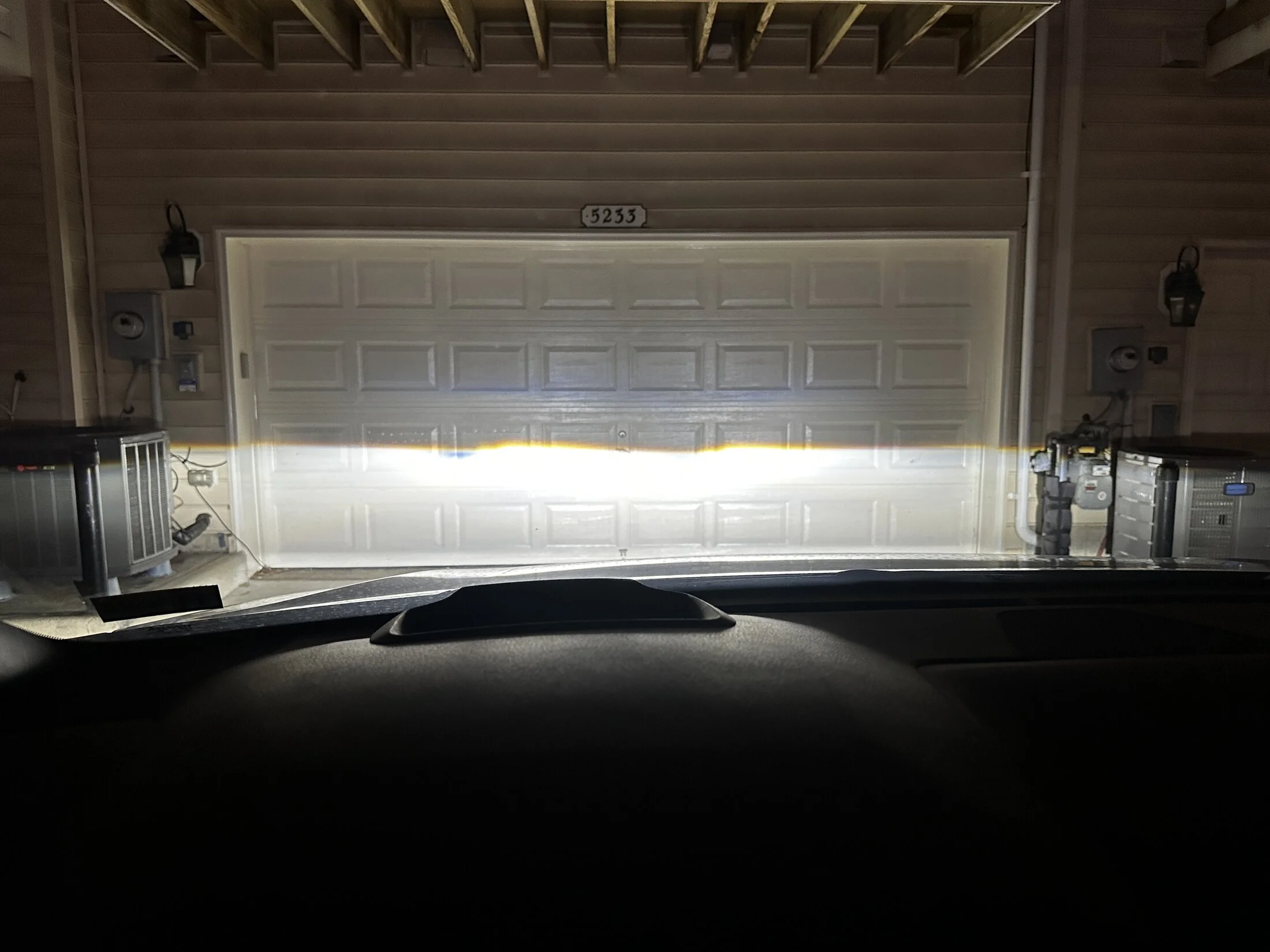

View attachment 3848155View attachment 3848156
Low beams, right? How's the cut off? It'll be appreciated if you can post a pic in front of a wall just to see how they behave in the stock LC reflector, thanks in advance!
Far from perfect cutoff but big improvement in usability. The halogen bulb cut off wasn’t much better honestly as I remember.

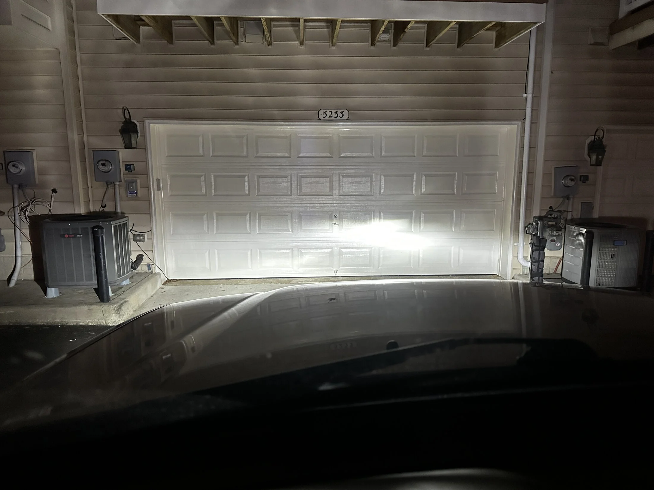

2024 Sienna Platinum for comparison:
Thanks for that! Not bad at all! All LEDs I’ve seen in halogen designed housings reflect a blob of round light all over the place without any way to align. This is much better.
There’s some light reflected above the cutoff, and obviously not as sharp as a modern lens, but not useless.
