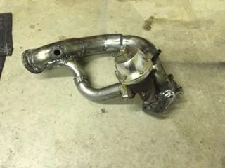

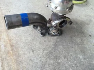

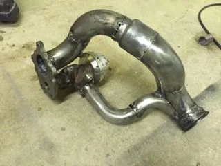

Got the new down pipe tacked up. It will go to my buddy for TIG finish welding.

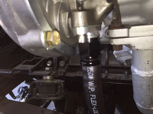

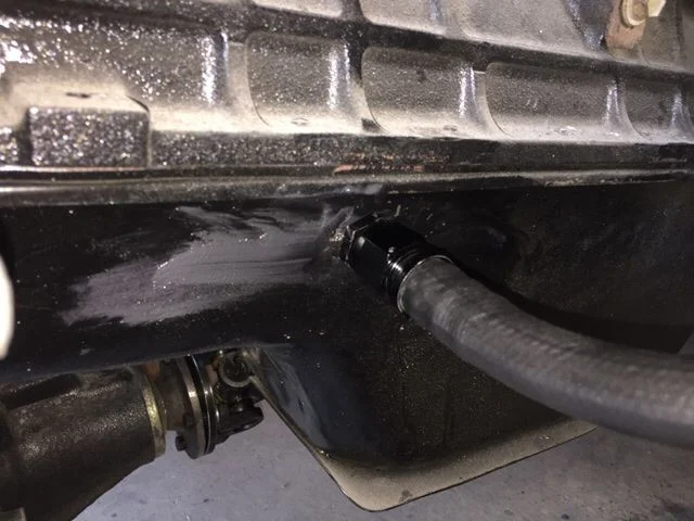

Oil drained installed. It is an AN10 hose. On the pan side I tapped with a 3/8 NPT to AN10 fitting. Used grease on the drill and tap to prevent shavings from getting into the oil pan.
Despite the grease on the tap, I'd still change the oil before running the engine. No one wants metal shavings in the oil galleys!

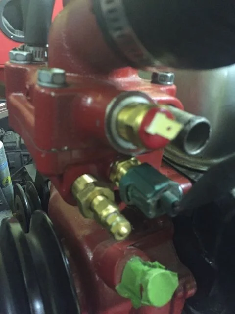

Sensors:
On the thermostat housing: top-radiator fan temp switch, bottom right-autometer gauge water temp sender, bottom right- oem water temp sensor (used by Megasquirt for warm up enrichment)

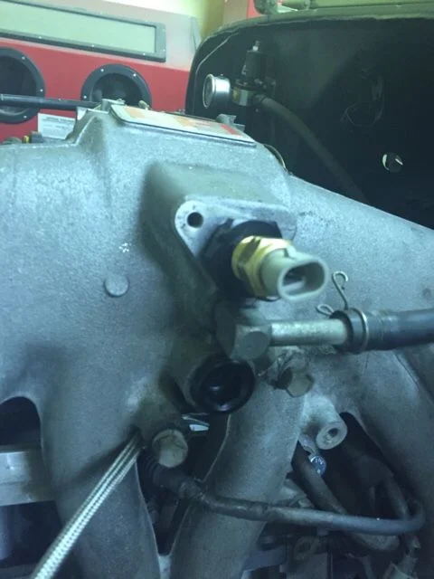

Intake- cold start injector eliminated and replaced by air temp sensor used by Megasquirt in conjunction with MAP sensor (onboard ECU)
Hey Isaac, how did you adapt the cold start injector port for the IAT sensor? I really like that idea. I currently run mine in the intake hose, pre-throttle body. Any other updates?
:beer: Ramon
:beer: Ramon
I tapped the intake with a 3/4" NPT and used a plug for the EGR and adapter in the CSI hole for the GM IAT. I have recently been trying to get my cooling plumbing and accessory drive in order. I am having to fab up a bracket for the York compressor.
I'm thinking of moving my IAT like you have your's - do you have a link for the adapter used? Also, had any time to work on her any lately?
here is a link for the adapter:

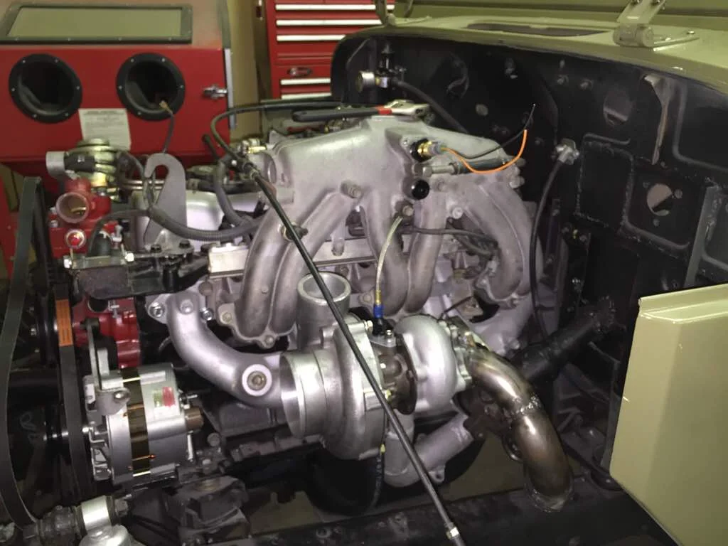

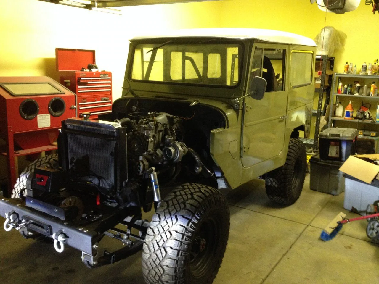

We just sold our home and will be moving into a rental for about a year until our new home is built. The new house will have a 1200 sq ft detached workshop, so I will finally have some dedicated space to finish this thing up and for future projects. In the meantime I have been trying to get as many loose pieces attached to the Land Cruisers as I can for the move. I got the roll cage bolted down, and welded in the sliders for the driver seat and got the hardtop on. The York compressor bracket is done and it is on the engine along with the radiator. I also got the hoses I needed from Beno and those are on too.

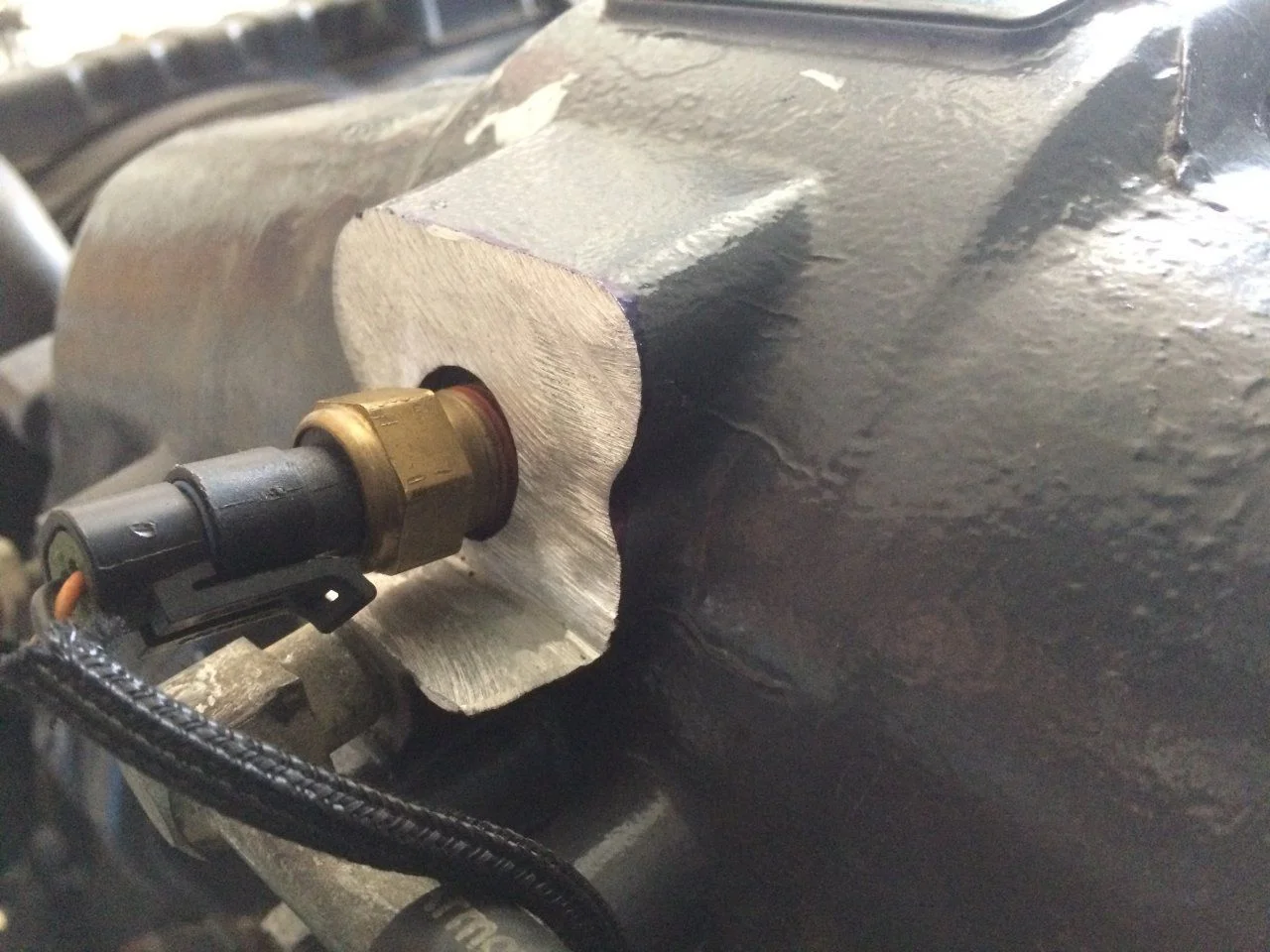

Hope you don't mind me sharing. I wound up having the cold start injector boss machined down and tapping for the sensor inside the casting. I think this might get a little better reading than how deep you can get the sensor with the adapter. Not sure if it will really matter, but I had to take it to the machine shop either way, since I didn't feel like spending the money on a 3/4NPT tap that'd I'd probably never use again. Hope you are finding some time to work on your project! I'm in the middle of a rewire eliminating the DIYAutotune relay board.
Hope you don't mind me sharing. I wound up having the cold start injector boss machined down and tapping for the sensor inside the casting. I think this might get a little better reading than how deep you can get the sensor with the adapter. Not sure if it will really matter, but I had to take it to the machine shop either way, since I didn't feel like spending the money on a 3/4NPT tap that'd I'd probably never use again. Hope you are finding some time to work on your project! I'm in the middle of a rewire eliminating the DIYAutotune relay board.View attachment 1226597
That will work!
Also FYI, a few MS tuners I have talked to have mentioned that when you put your IAT directly on the intake, you need to program the ECU to ignore it for a few seconds after initial start up. This is due to after restarting an engine that has warmed up, the intake manifold is much warmer than the air and will heat soak the sensor, which will tell the ECU that the air is much warmer
(and less dense) than it actually is, causing a lean condition until enough air flow causes the cools the sensor. Here is some more info: Megasquirt Support Forum (MSEXTRA) • Lean after warm restart? (View topic)

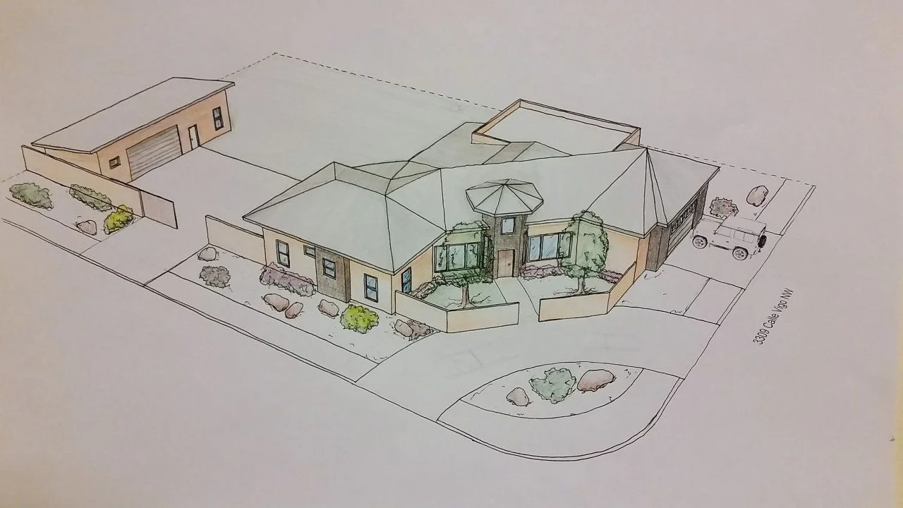

I moved the FJ40 to a house we are renting for a year while we build the new place, right now I am not sure if I will have time and don't currently have room to work on it. The garage is overflowing with boxes, but I plan to start moving some to the attic soon. The good news is in less than a year I will have a dedicated 1200 sq/ft workshop. Here is a conceptual I just got from our architect:
open
That's going to be an awesome setup. I moved last fall and had intentions of building a shop, but got really bad news that a good portion of my lot can't be built on due to a "streetscape buffer" - we are in a culdesac and back up to a 4 lane road. I'm having to circle back and rethink things. Thanks for that MS Forum link, I'll have to give it a good read!

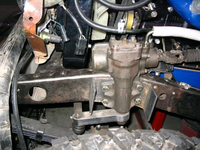

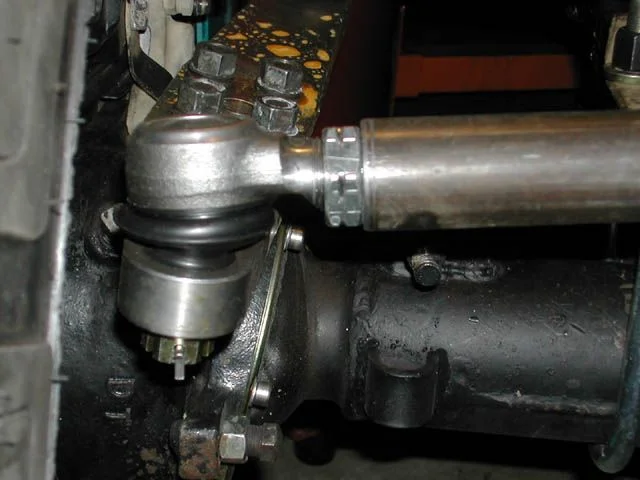

I noticed you used the straight pitman arm. Did you need to notch the frame to clear the rod nut?
Also is your high steer kit from Sky also?
No, I didn't have to notch the frame, but it is very tight. The rods were custom length from Marlin. Steering arms were the FJ80 style from Luke at 4x4Labs.
