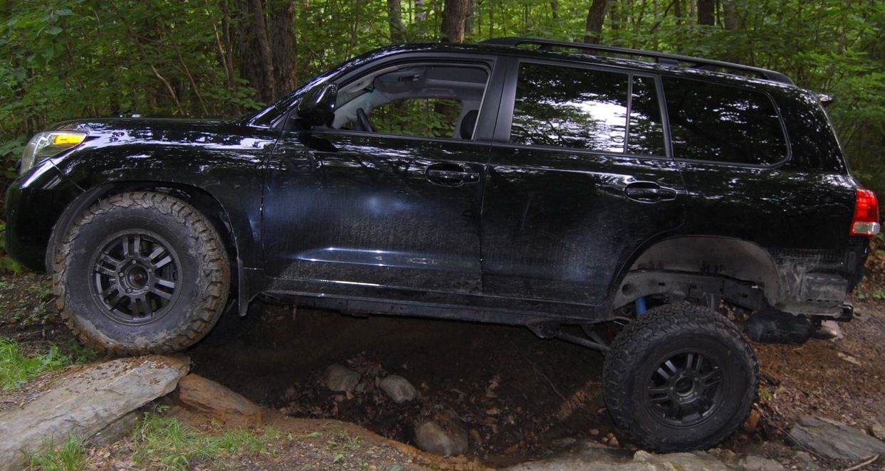

A couple of acceptable pics while out on my local test trail. Wheels and tires fill out the wheel wells perfectly and the 33.1" AT KO2 on TRD wheels seem to clear everything so far. Extremely capable and stable given the type of build.
