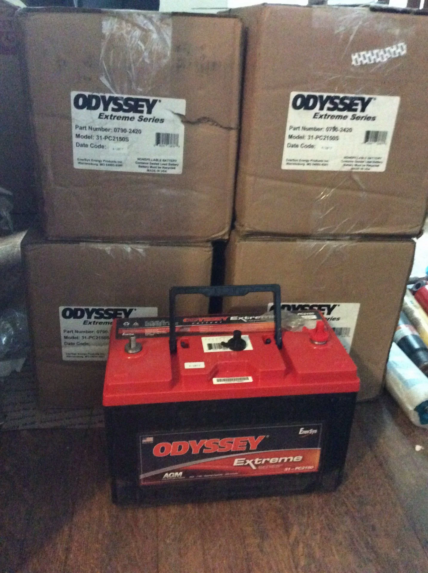

Alternator and dual battery time! Two Odyssey 31-PC2150S batteries will take over duty from the stock original Panasonic. 2300 CCA should do nicely. The "S" suffix in the part number denotes stainless 3/8" (9.5mm) stud terminals.... perfect!

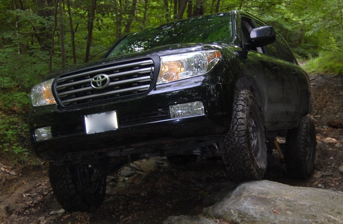

A couple of acceptable pics while out on my local test trail. Wheels and tires fill out the wheel wells perfectly and the 33.1" AT KO2 on TRD wheels seem to clear everything so far. Extremely capable and stable given the type of build.View attachment 1105312 View attachment 1105315

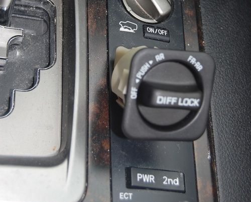

Now, where to mount this?
@bjowett I know this is a crazy old thread, but where did you end up mounting your diff lock switch? I'd like to put it in the spot you're hinting at, but I'm not sure if there's space underneath to fit. Unfortunately there's no good dash blanks available for this in my 2013 as I've already occupied most of the right side with extraneous lighting and the left side comes full from the factory.
I have yet to mount a locker switch in either hole... there is quite a bit of depth in there, 3.3" deep on one, the other is 4.8", that is from the outer face.
Thanks Brian. Did you end up mounting it somewhere else? I'm not 100% convinced the center console near the MTS control is the best location, it just seemed like an obvious spot
