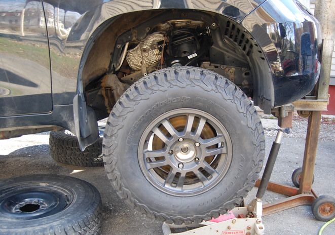

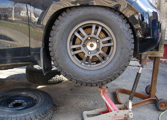

This is the only picture I took, stock wheels will sit in 10mm more, will make for an easier squeeze.

Second thought after looking at your photo Brian and you having 10.5 in width tires theres no way my 12.5 would tuck as yours do.
I'd be eating fender at best.
