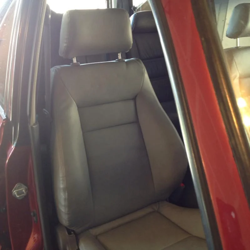

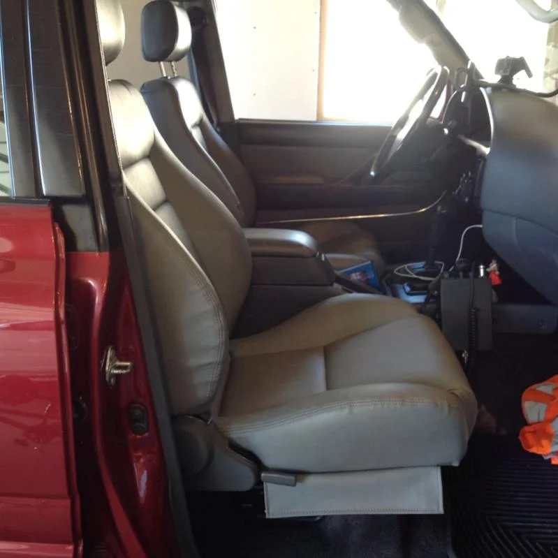

So the gentleman I sold my 80 to didn't like the PRP seats I had and asked if we could do something else, I had sat in some Procars in some 60 series and suggested them. He said go for so I ordered up some Elite series seat and brackets! Part numbers SCA-80-1100-52L (drivers seat) SCA-80-1100-52R (Passanger) SCA-81988 & SCA-81989 for the brackets. The seats are grey vinyl and I ordered them from Summit with only $19 in shipping for a total of $834.88 shipped to my door. I ordered the seats Monday and they arrived at my door on Friday even though Summit said they would not ship until 10/15 (2 weeks). The seats are great and the adjustability in them in leaps and bounds above the stock seats. It took all of about an hour to install them. Now, the seats do not come with seat belt latches as the stock seats have them built in to the seat. I walked around the salvage yard and found some latches out of a extended cab Nissan pickup that fit the latches perfectly and have a cable that I bolted to the inside rear seat bolt. This is a great option for the crap stock seats the Mr. T so greatly messed up on.

Those seats look great. Nice big boulsters. That's a pretty penny for some universal seats though. I used to buy full sets (front and rear) of BMW M3 vaders seats for like $1k and those seats where the best EVER. Full power, memory, and heat.

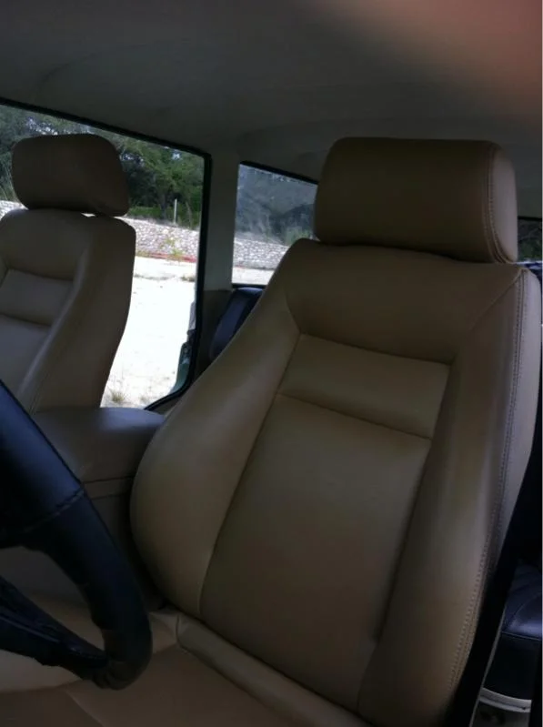

They look awesome! I think its a much better deal to get two totally new seats rather than replace leather and foam that's more expensive. Does the color match the factory tan interior for a 97?
