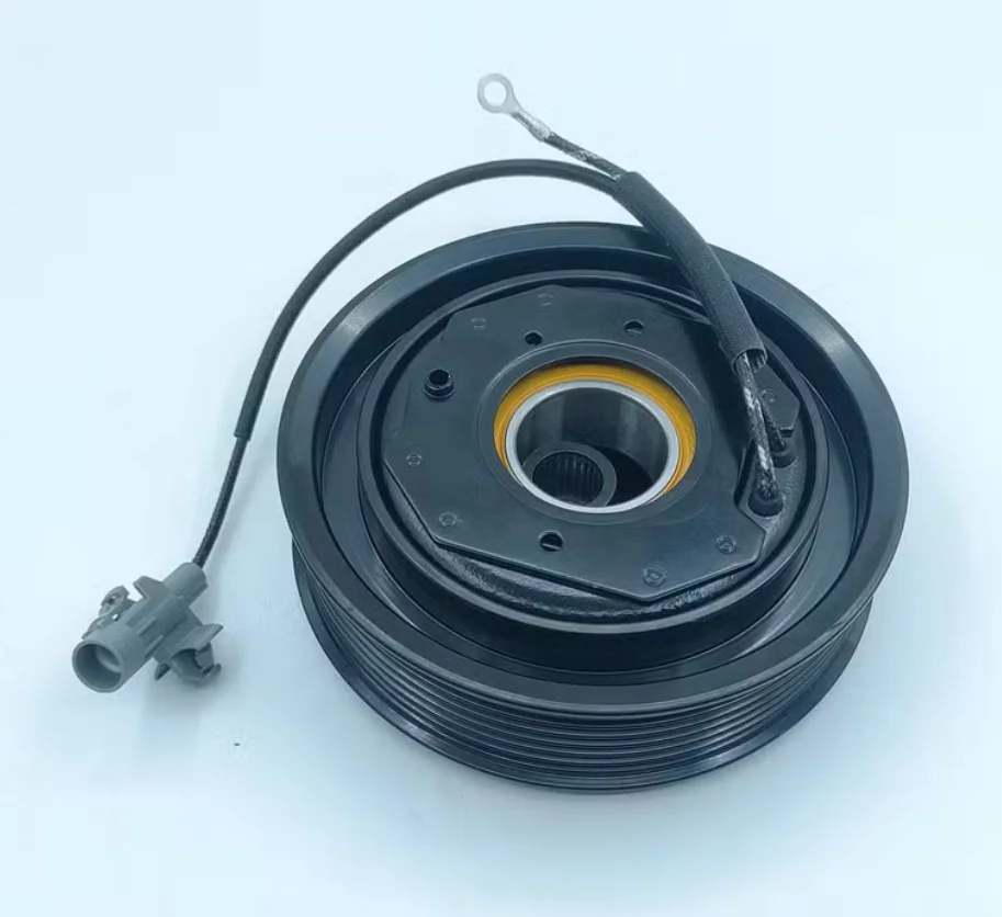

I’ve had issue with the compressor CLUTCHES on both my 100 and one of my Tundras

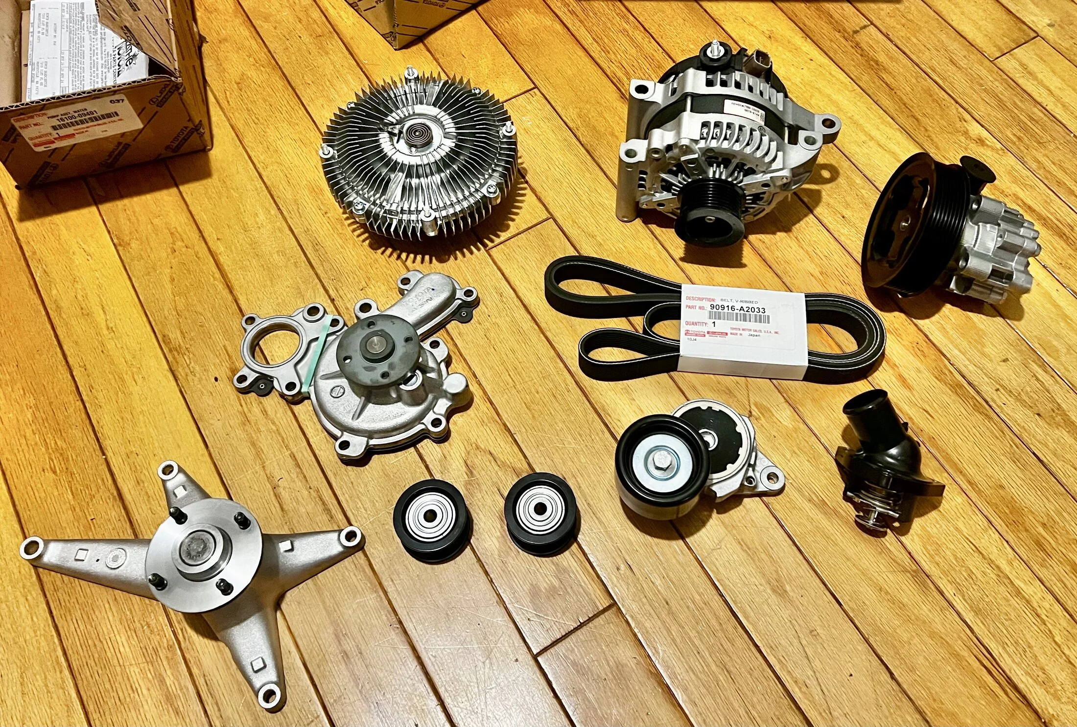

(Random Internet pic, not 200 specific)
Christmas came early…

I’m just hoping that replacing mine fixes my voltage issue.
But I also like the idea of a new old LX ready to go another 200k
If you’re never done it before and would like a couple tips, I did a write-up on replacing nearly everything in that pic in the thread in my sig. if you’re on a phone, you gotta turn it sideways to see members’ signatures

I’m not super electrical savy, but spiking voltage issue don’t sound like a faulty alternator

Sounds like voltage regulator failing to me, which is in the alternator. I have definitely been wrong many times before though…
I should also order battery cables and maybe a new fusible link

Time to replace power steering pump at 215k
Seems serp belt is about due also, and i cant find records the water pump was ever done either
So... This is going to be a While Im In There adventure
List:
-PS Pump
-Water Pump and Gasket
-Belt
-Belt Tensioner
-Idler Pulley
-Water Pump inlet and thermostat
-Fan Clutch
Anyone have any other WHILE YOURE IN THERE things to add i am missing??

Think it's overkill to do the same at 160K?
Yes…. If no signs of problems with anything
Can do the Idler and belt fairly easily but anything else it turns into a “while I’m in there” thing
