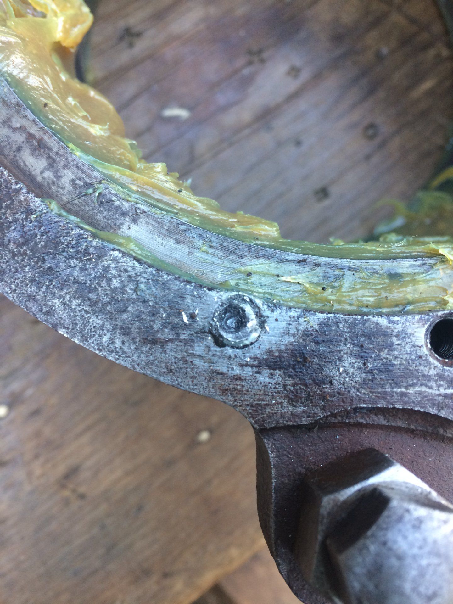

I sheared a bolt last night on the back of my knuckle. Pissed me right off cuz I shoulda known it was happening abut I kept trying to turn it like your saying. If it’s that hard, I’d really hedge that it’s crossed.
As well as my hard brake line on the driver side, I was using a flare wrench but it was so rusty corroded it rounded. I had the backing plate off so I ended up dousing it really well w/ penetrant and put a vice grip on it and that cracked the seal. So just saying, you might need something tighter at this point to get a grip on it.
Good luck. We’ve all been there w/ fighting w/ a bolt or nut that’s really snug. Step back and take a break if it’s making you too pissy. There always something else to do. Good luck!
