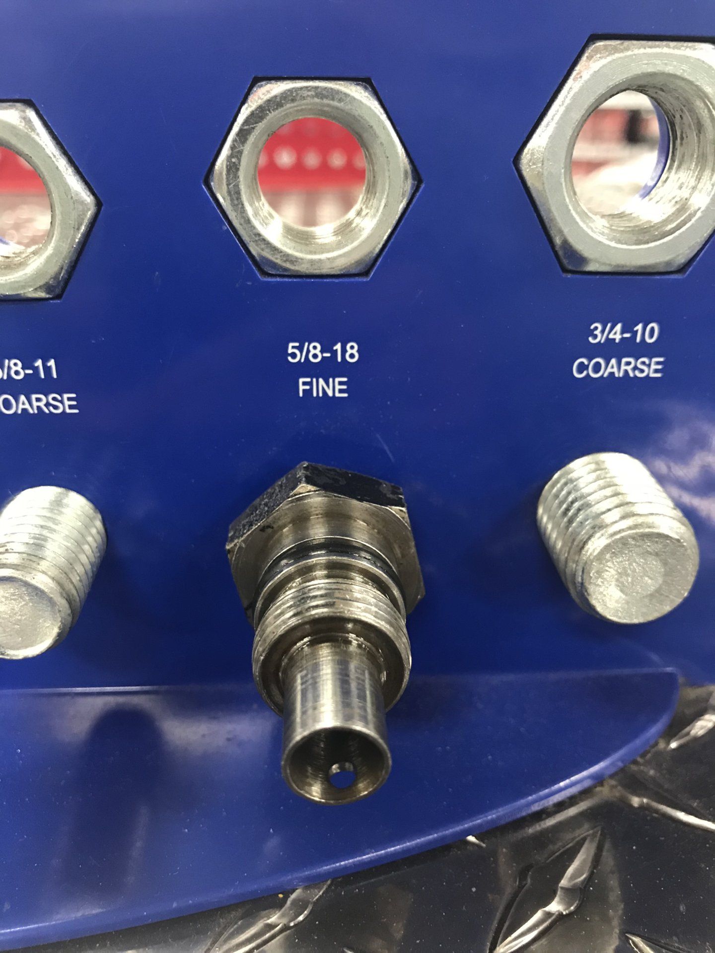

Ding-ding-ding! Looks like that’s the problem. The fitting on the hose accepts a M16 x 1.5 nut, but here’s the pump fitting threading quite happily onto a 5/8-18 bolt. And I somehow managed to get TWO pumps like this.

Actually, I don't know what to do. I've ordered two pumps and gotten it wrong twice while ordering what everyone else is getting. Autozone doesn't have a pump with the proper fitting and they don't have an adapter for that fitting. What other options are there?
Here's what I don't get: How is it that EVERYONE who's done this conversion has gotten a pump with a metric fitting but I got TWO with standard? Georg himself says you need "Autozone pump #7023" -- which is what I ordered -- and there are lots of people in the Saginaw conversion kit thread who got that pump and had zero problems, so WTF is going on that I got something different? I just left Autozone and the guy didn't know what to tell me -- it says big as life right there on their product page that the outlet size is 5/8'' X 18. It doesn't look like they even offer one with a metric fitting. So what am I missing here? The ONLY thing I can think is that Georg specifies a Duralast pump while mine is Endurance -- but that's the pump that comes up on Autozone if you search for #7023.

Lol. Just checked O’Reilly’s website: 5/8-18 fitting on that part number. But I’ve found one at my Autozone that appears to be same pump with metric fitting. I’ll grab it tomorrow. Third time’s the charm?
EDIT: Nope, 3rd time was not the charm -- that pump requires an O-ring fitting, not a flare. Still looking...
