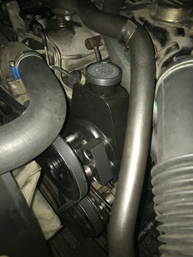

Done. Again. But really this time. (I hope.)
I had a new high pressure hose that hadn't been mounted yet since I buggered up the original one with my first failed install, so I ended up taking that to a local shop to have them cut off the metric fitting and replace it with one that exactly matches the fitting on the pump. It took them 10 minutes and cost me $5. Georg swears the hose's metric fitting works with the pump's standard fitting -- he says it's snug but it works and he does it all the time -- but I just couldn't make it work. The new fitting went on nice and snug with the only struggle being working in a cramped space. Now it's tight, I trust that it's tight, and it's not leaking. My advice to anyone who asks is to get a new fitting put on the line instead of trying to make the mismatched threads work.
The shop I went to was Orme Brothers, Inc in Northridge. Good people. Worth it at 10x the price.
Edit: Another word of advice: watch the routing of your low pressure hose. Mine ended up touching the exhaust header when it was under pressure. Fortunately, I caught it before it burned a hole in it and zip-tied it out of harm's way.

Looks like it was worth the trouble, looks good in there.
Looks good. I learned the hard way that there are MANY variations of the 'canned ham' GM pump, and you may not have what you think you have, the fittings may differ, the clocking of the pump may differ (just enough that you have to modify the bracket), etc. Never assume anything when you order one or take it out of the box.

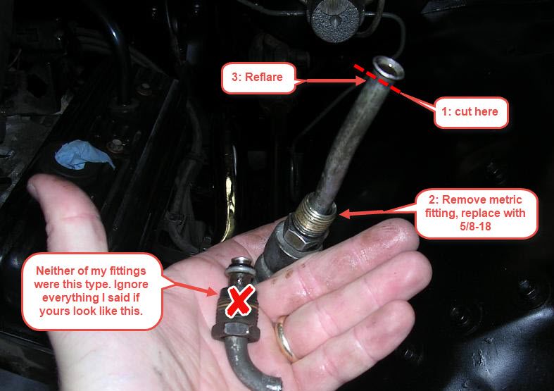

Now, how do I get the old one off and the new one on? Do I have to cut the brass pipe and then re-flare it? It looks like I could take the pipe out of the rubber where it connects, slide the old one off backwards, the put the new one on the pipe and push the pipe back into the rubber.
Can I? would prefer to have to cut and re-flare if I don't have to do so.

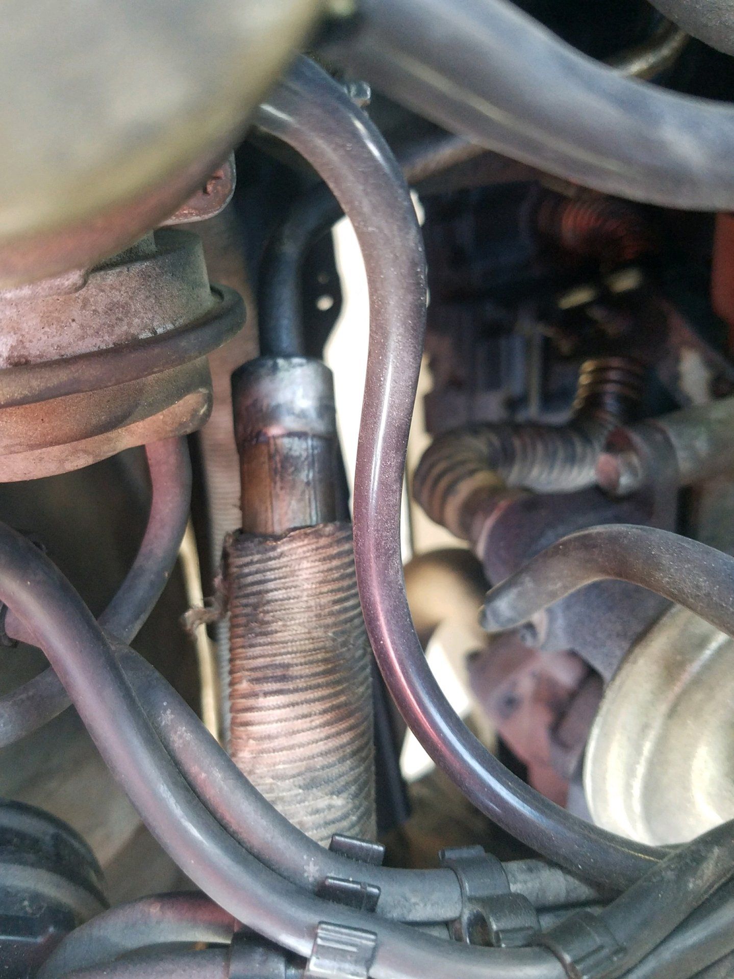

Damn thing is leaking like a sieve.
I went out and looked again. It does not appear as though I can "cut the hose" as it doesn't appear to be a hose..
I'm going to rent a flaring tool from O"Reilly's and start cutting $#!T up and flaring it out.

I will GLADLY pass the baton on this one, and I'm sorry you have to take it. Here's a diagram I just rigged up showing how I had my fitting replaced. Hope it helps...
