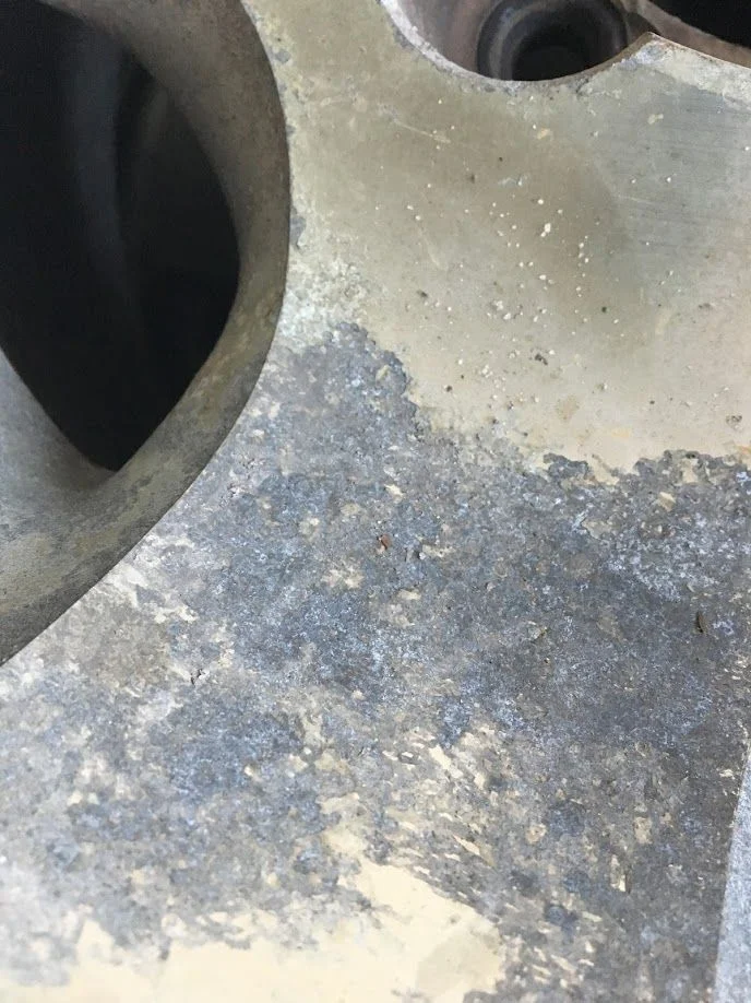

Powdercoat wheels
I just had wheels powdercoated that looked a lot like that. They are on my trailer and the finish is holding up well after a couple thousand miles so far.
For others' convenience, here are the photos.

SteveD: can you post up close up images of your wheels after powdercoating?

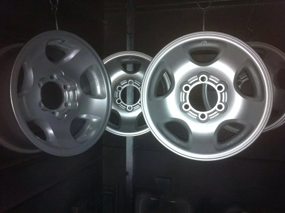

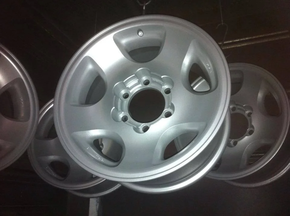

I bought 5, blasted them and had them coated in a bright metallic silver. They came out pretty nice. A few little pits show if you look close but it's fine for me. I think having them all one color looks a little tougher than the machined face on the stock ones too. Less fancy, I guess.
Notch: what brand and color powdercoat powder did you use, and did you have them clear coated also? Cost per wheel?
In my search for the "perfect" color I've found that there are dozens of different silver colors available.
I had a local coating shop do the powder for me. Yes, they have a UV stable clear on them. I think it was around $60 a wheel. There are a million silvers, for sure. I had them special order the lightest, most metallic one in the book. It still looks a little gray compared to bright metallic wheel paint like most factory alloys have.
The stock factory FZJ80 alloys had no paint AFAIK, just the rough casting surface in the cutouts, a milled aluminum surface for the spokes, then all of it clear coated. That's one reason, IMO, it is so hard to duplicate the OEM look for the standard FZJ80 alloys. The 40th Anniversary alloy wheels however were painted in the cutouts, a graphite color similar to the bumpers, same milled aluminum spokes, then clear coated.

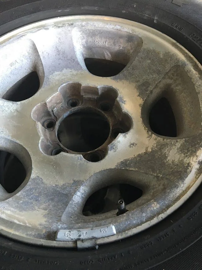

As another example taking nasty wheels and making them nice again... My LX450 wheels were in bad shape. The spare, especially. I had them blasted and powder coated for about $60/wheel. A couple of pictures below show the before and after...
I dont normally like the lexus wheels, but those look sweet in that color.

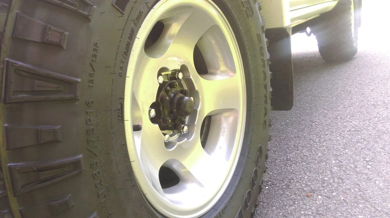

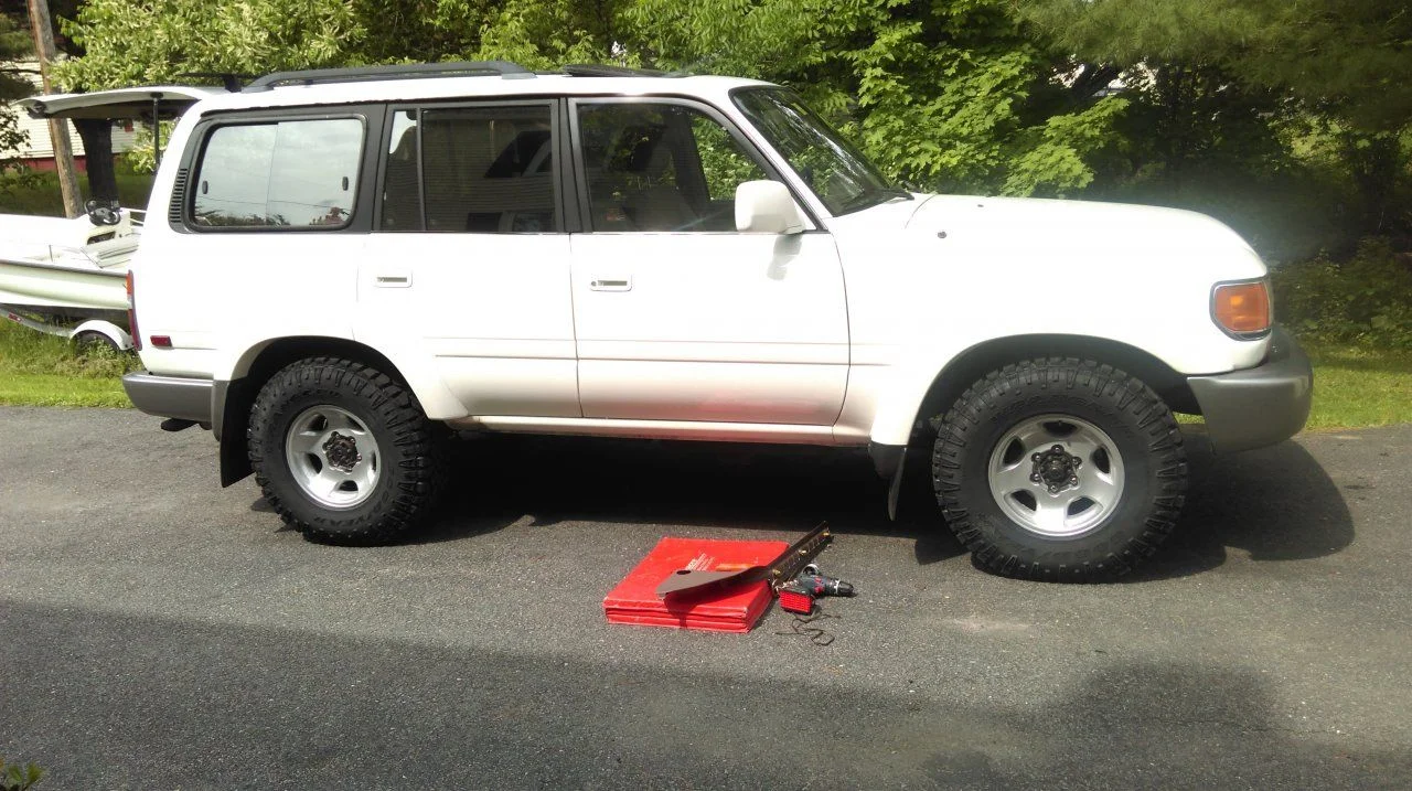

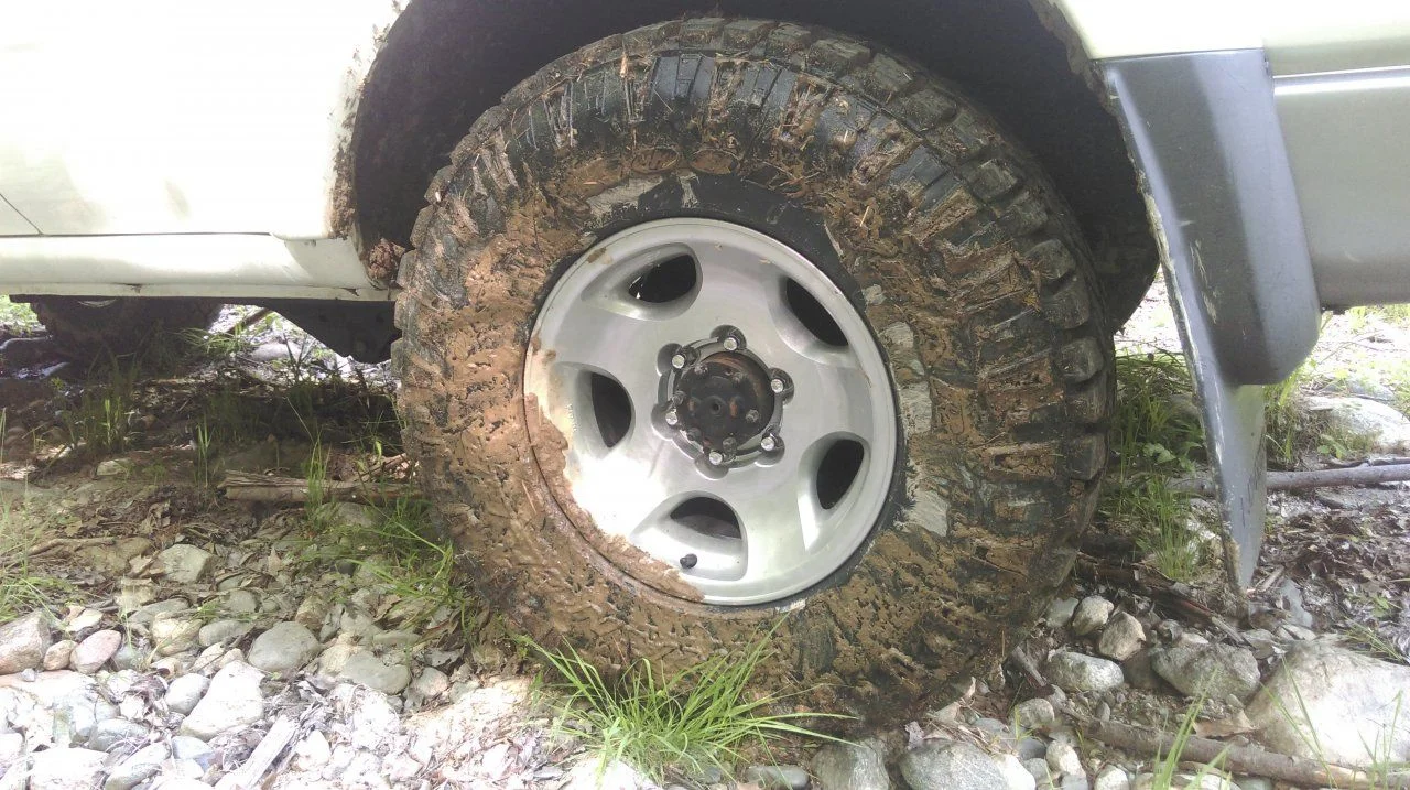

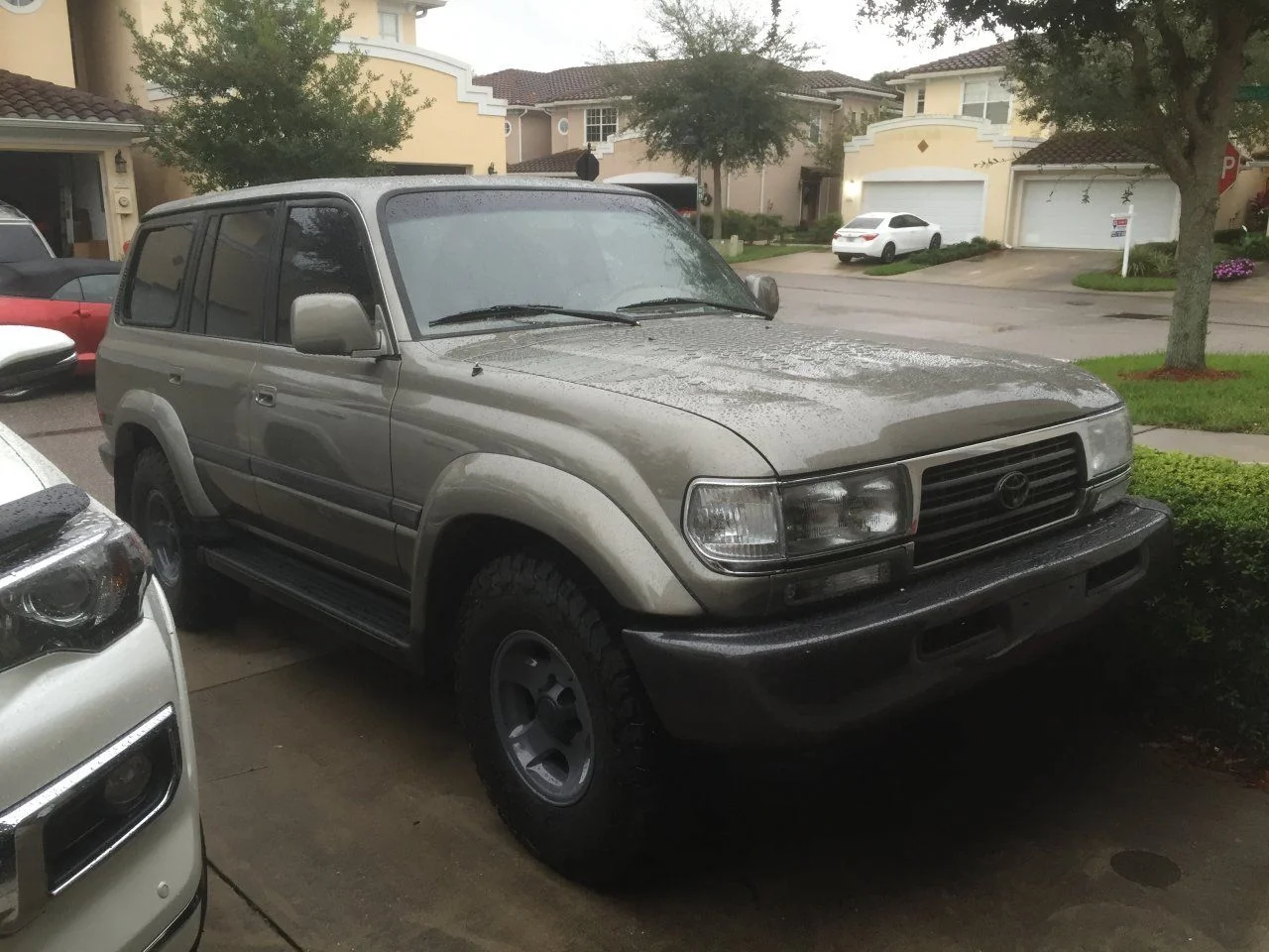

mine came out almost exactly as yours, in the shade they are kind of flat, but they are silver in the sunlight.....my powdercoat guy used prismatic Porsche silver and a uv rated clear, profile is when I had just picked them up from the powder guy and had the 315 MTR's mounted and running around in the middle of February snow
