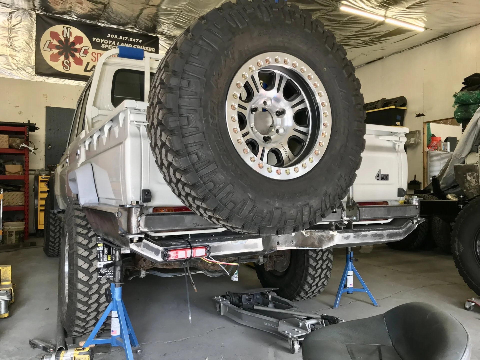

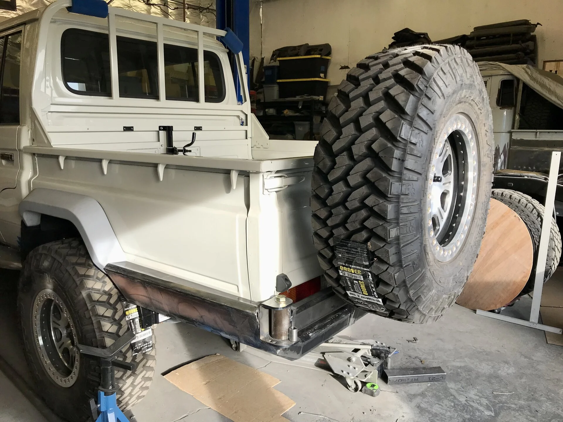

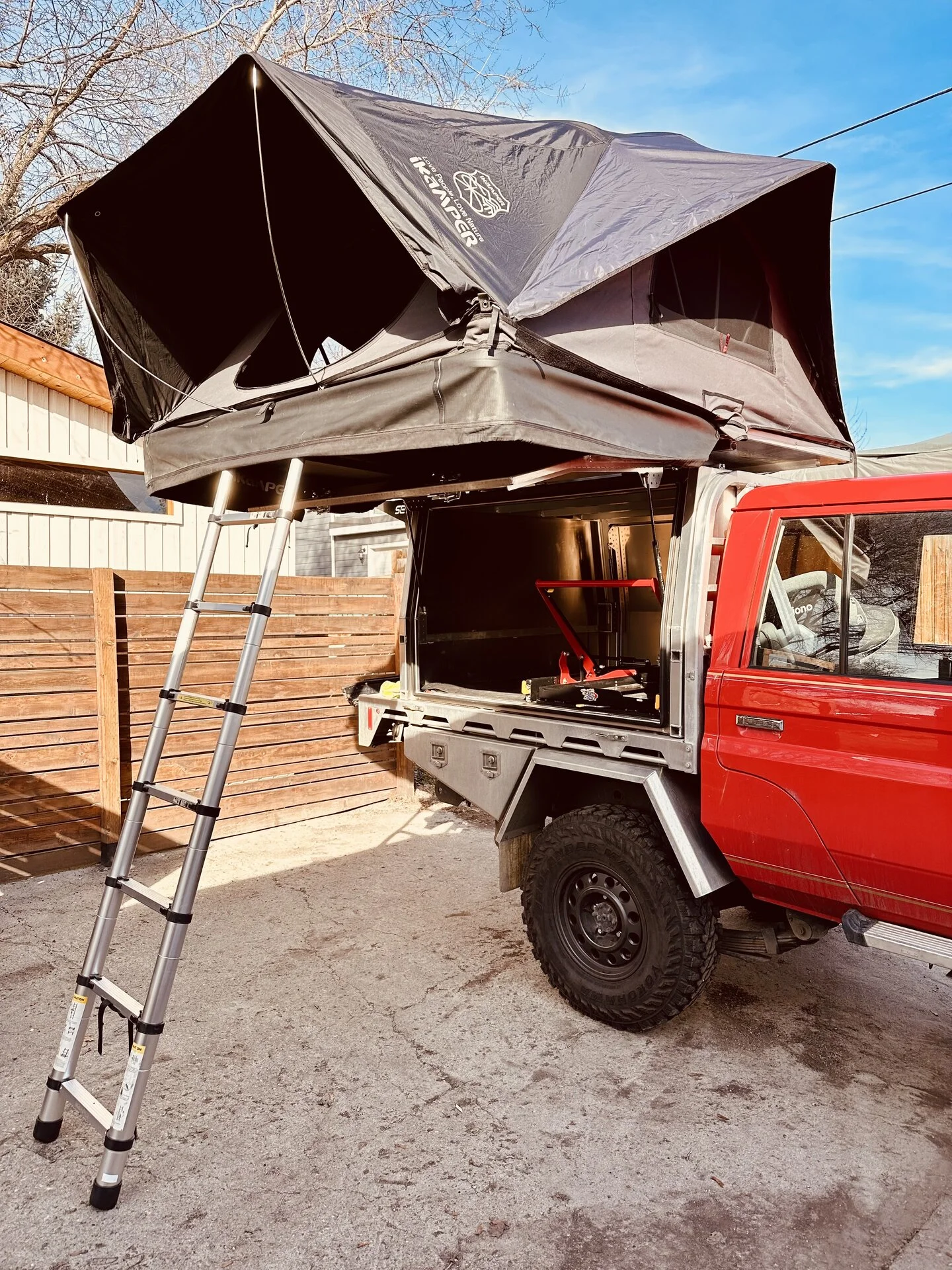

Lan, your attention to detail and eye on design is just amazing. Top-notch work as always !
Ditch the OEM hitch though 😜

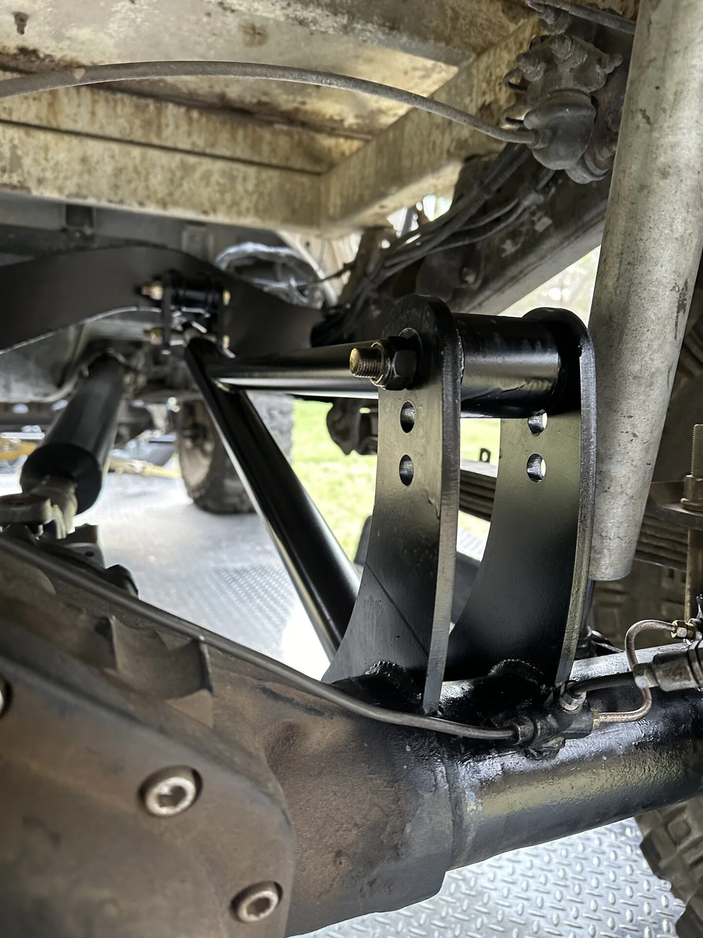

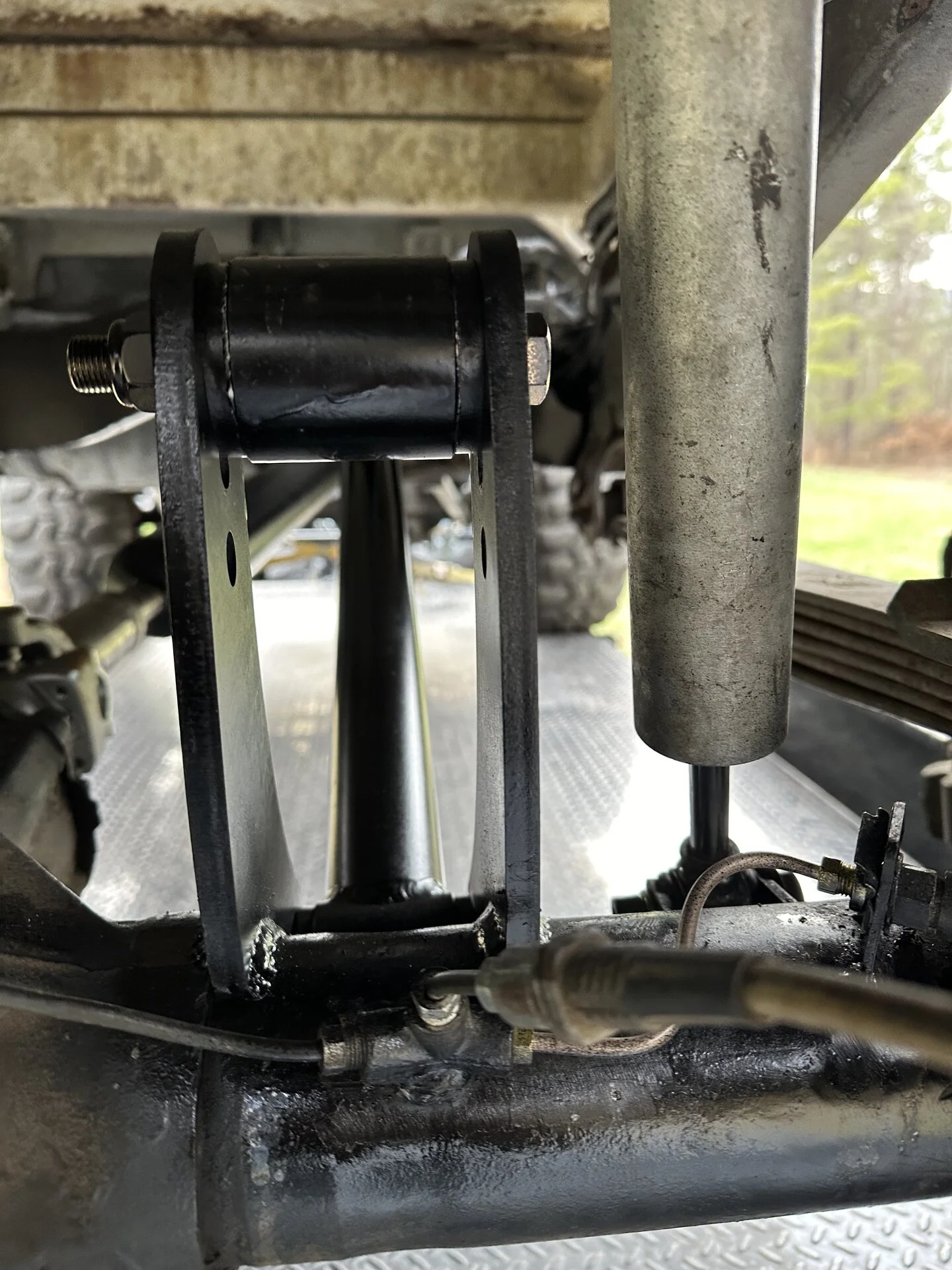

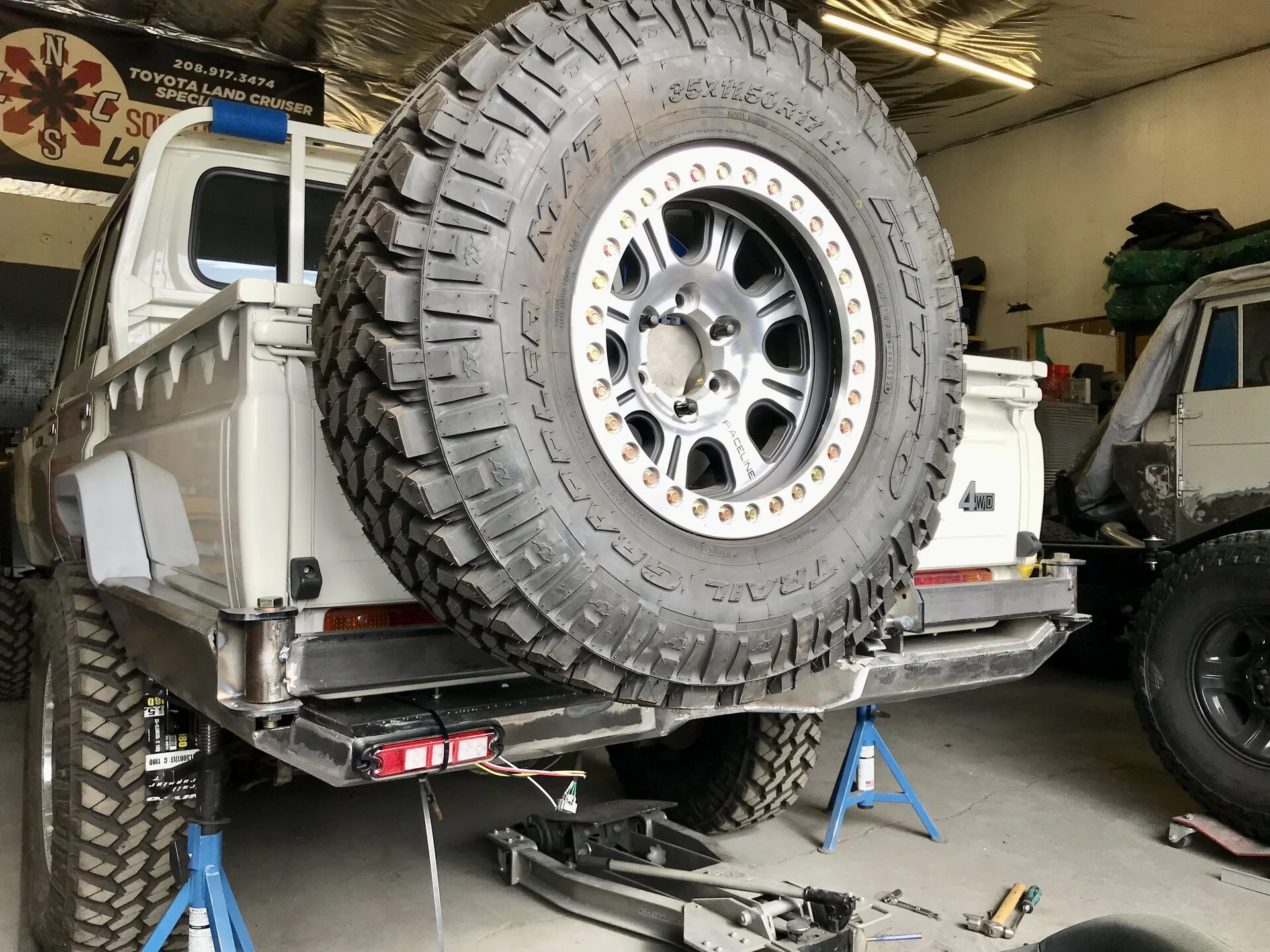

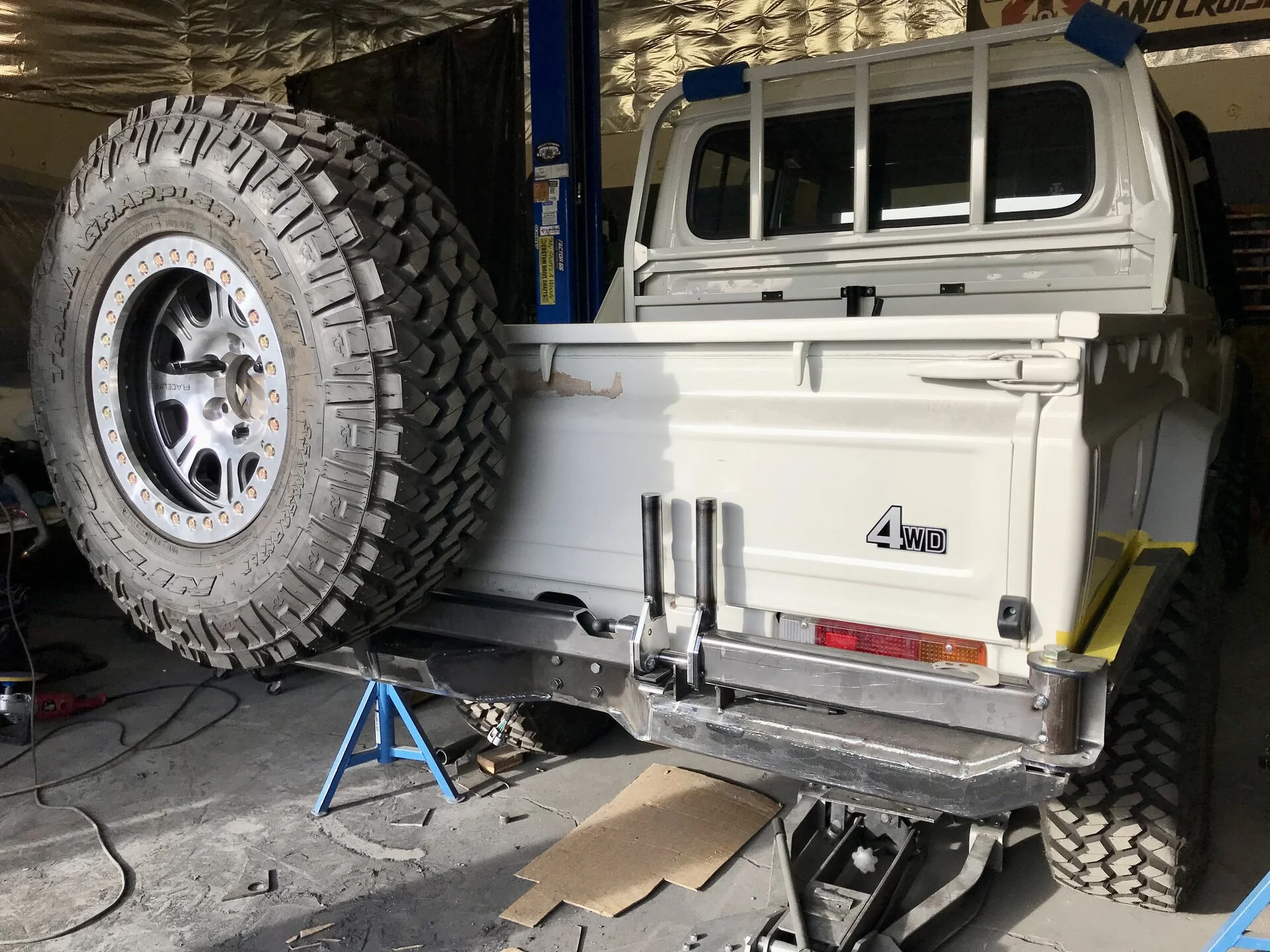

Under frame 80-series hitch will just be for heavy duty towing. Our bumper, a light trailer is no problem, a tow hitch can be bolted to where the pintel mounts.
Cheers

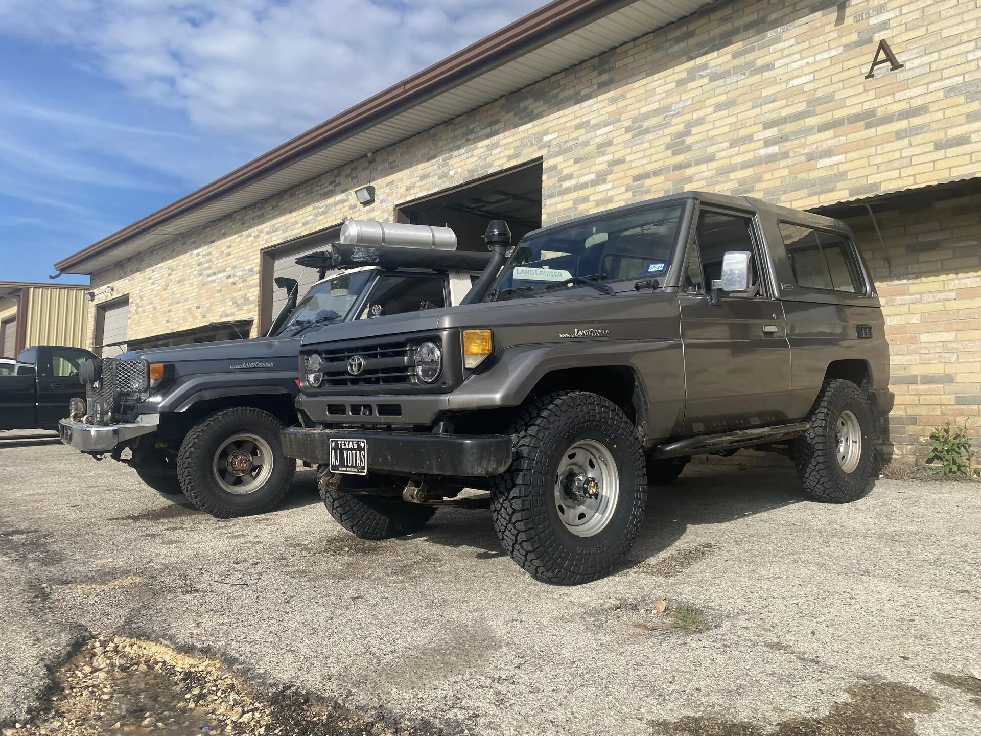

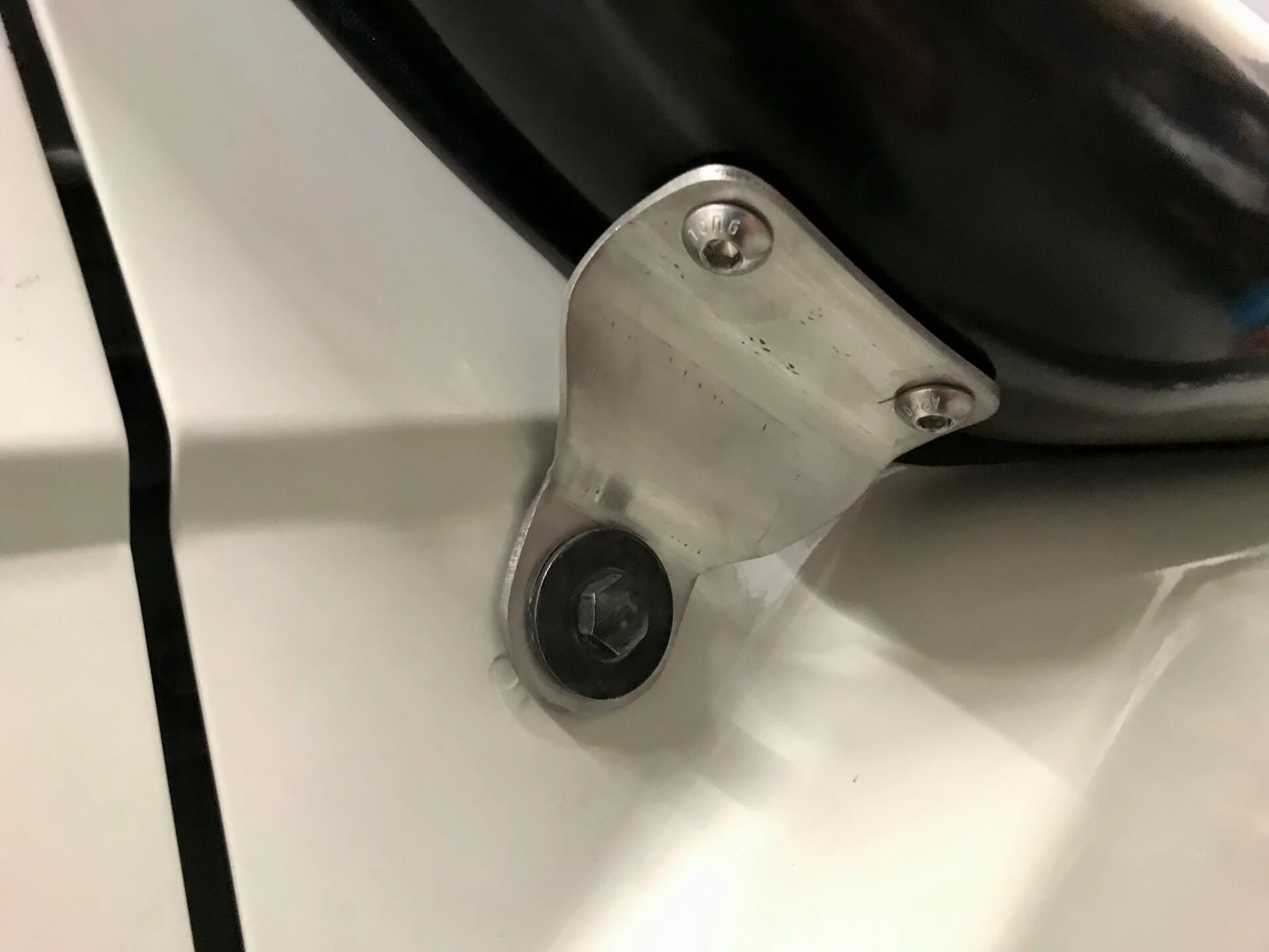

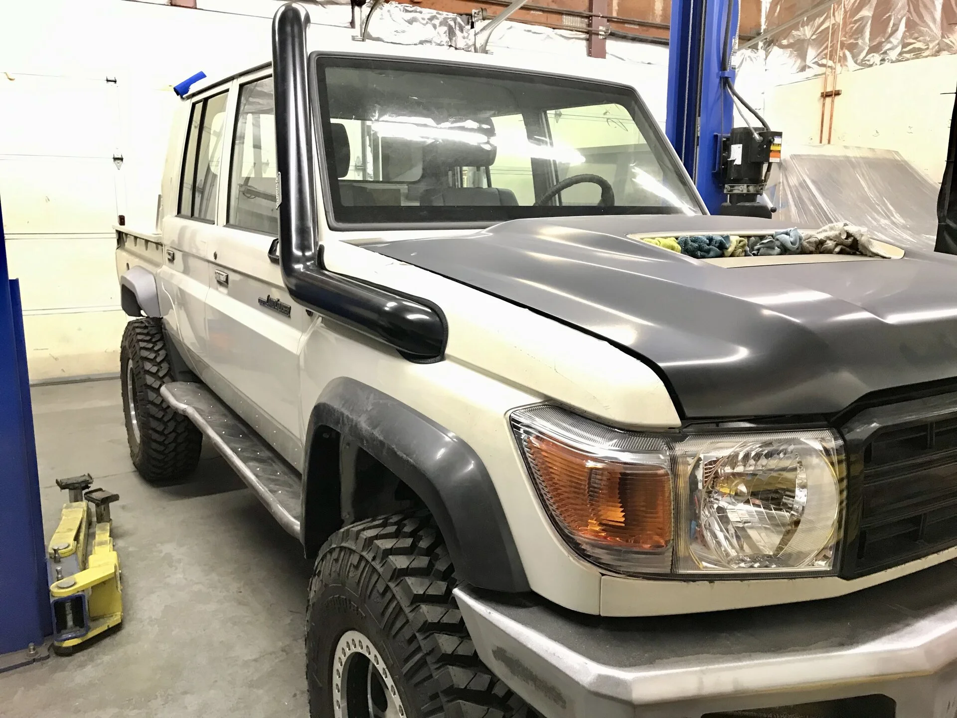

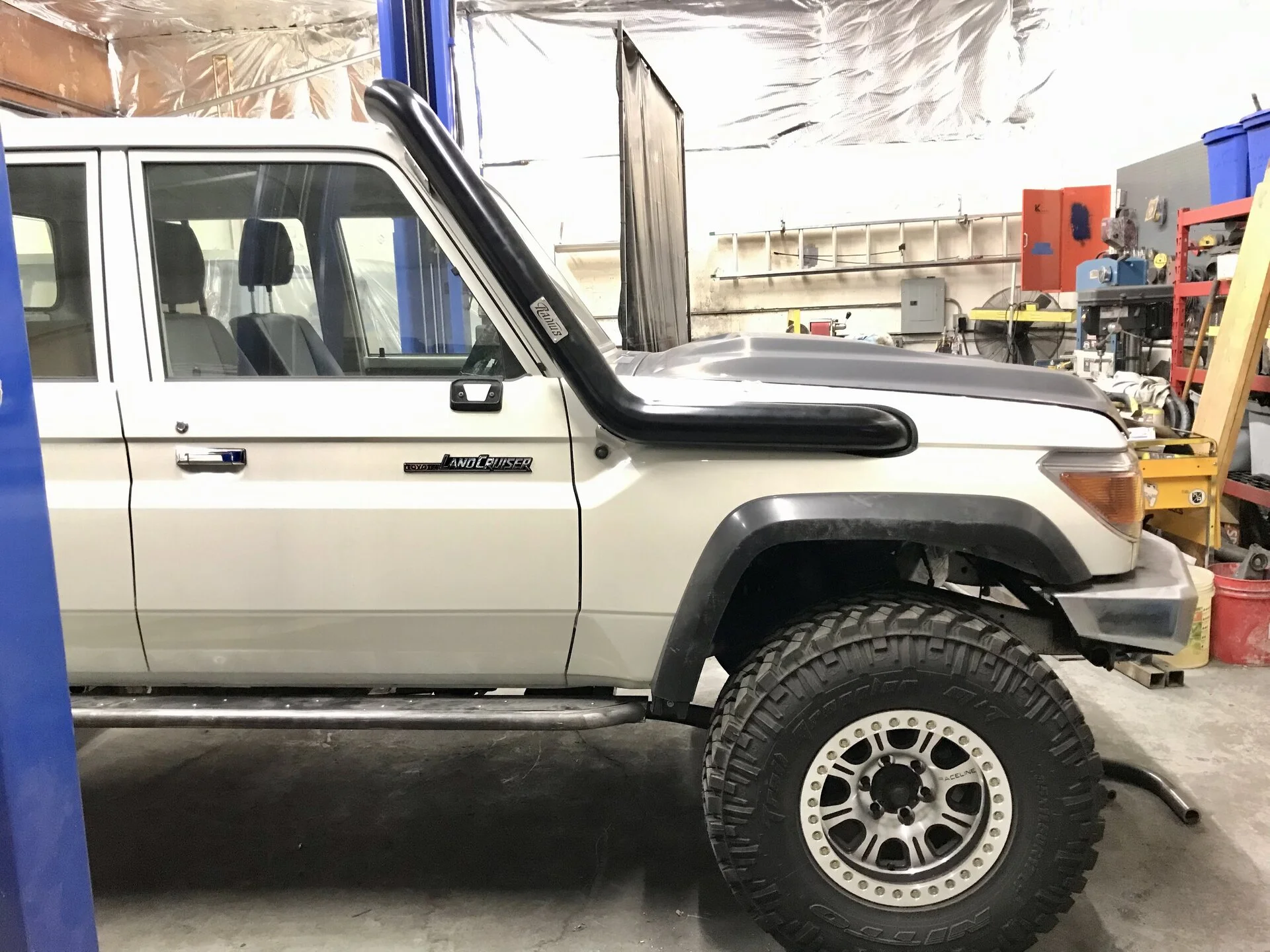

Installed this Radius Fabrication snorkel today on this 79.
It didn’t come with a support bracket here where the original snorkel mounts so we made this one out of stainless steel.
Cheers

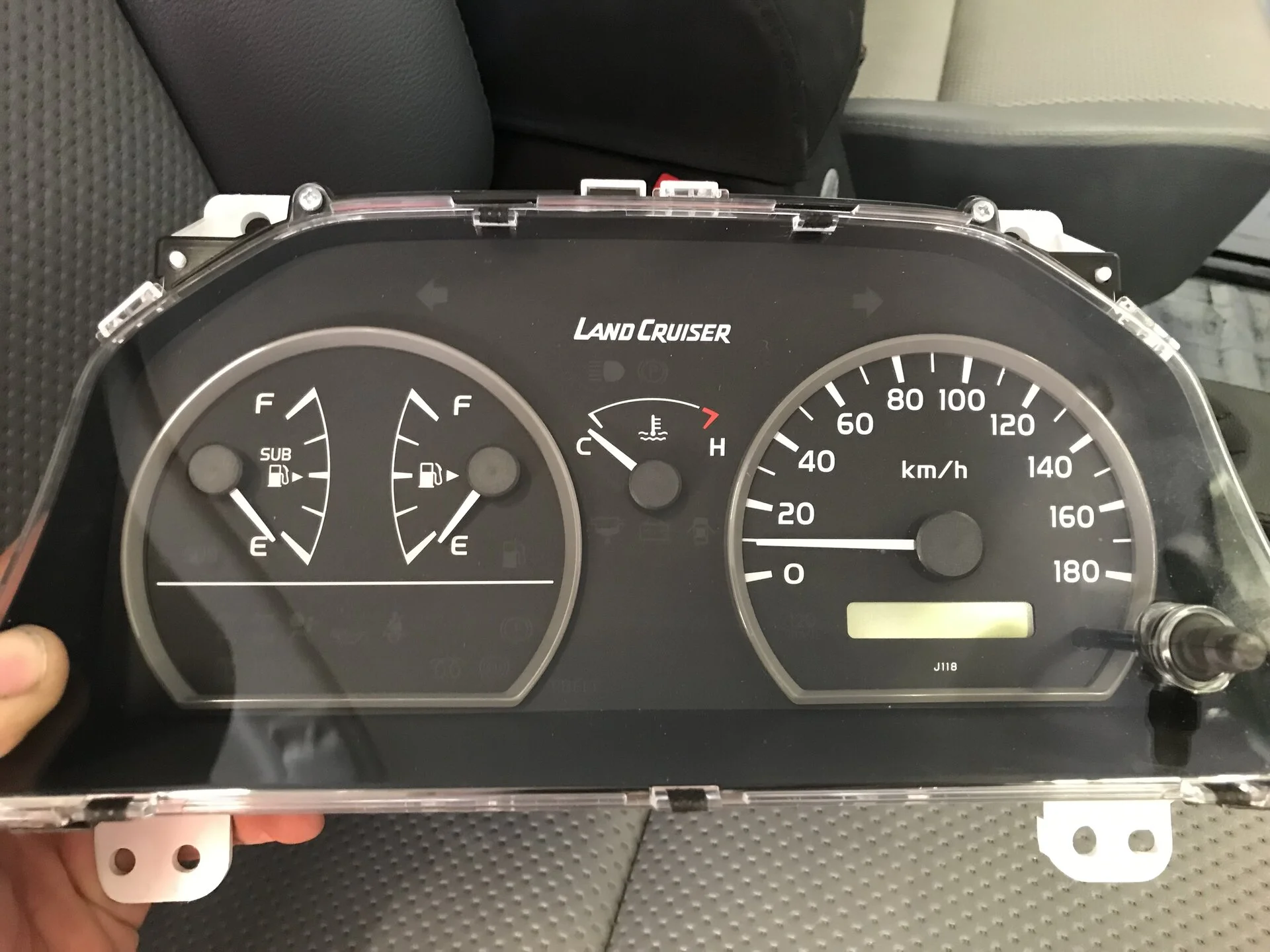

After searching the globe for a year I can not lay hands on the correct gauge cluster for a build we are doing. Canada, South Africa, Japan, Nicaragua, the Middle East and even the USA has turned up nothing but dead ends.
The only cluster I can lay hands on is this, it doesn’t suit our build because it is double tanks and we have a single. Not to mention no tach, it is the bare bones single cab with double tanks.

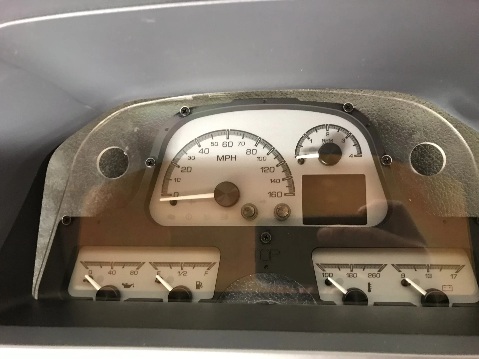

So we are probably going a route like this.

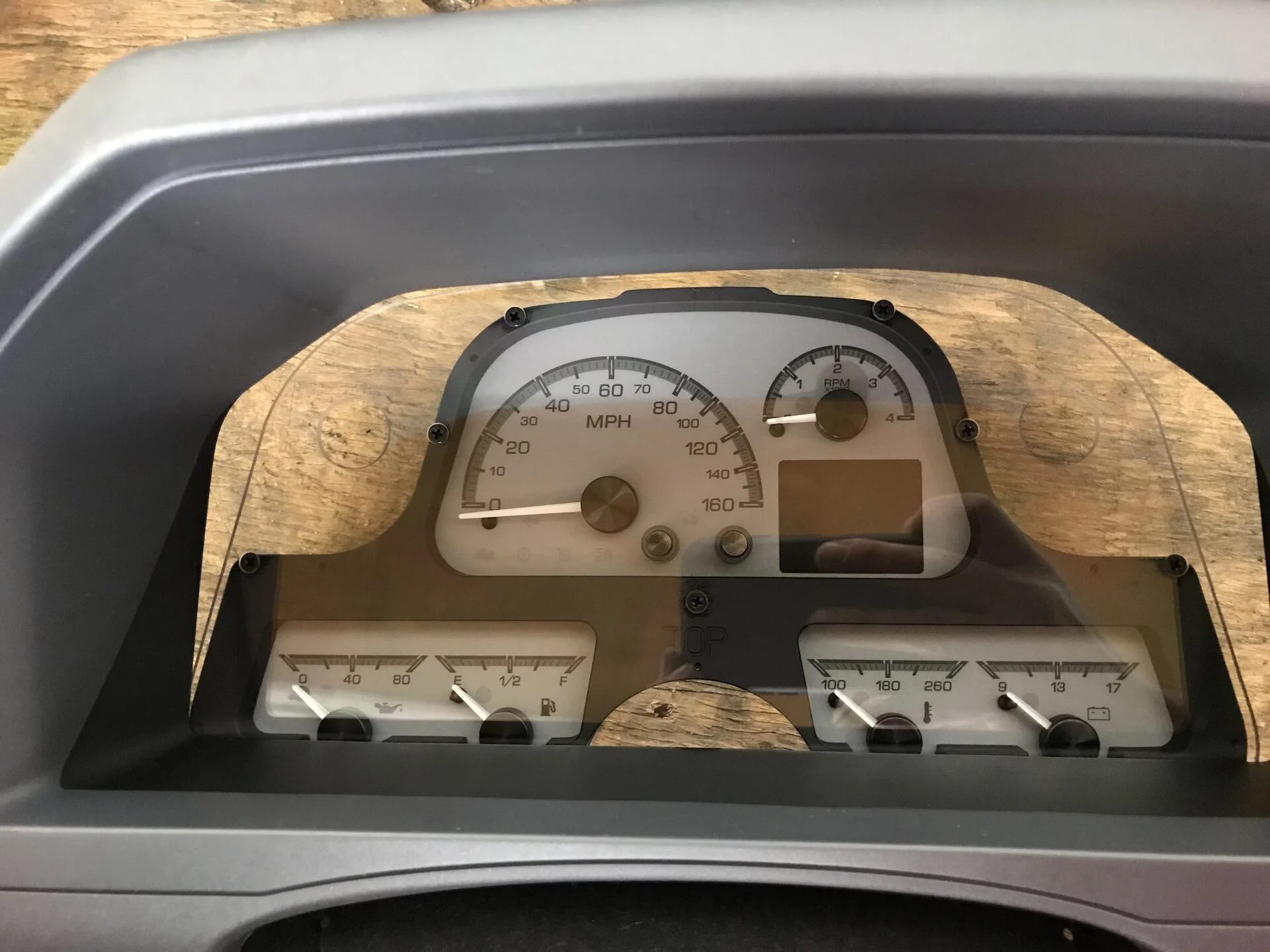

Yes that is a Dakota Digital for a diesel 40-series but it does fit, we can make it work and yes we will add trim so it looks more appropriate.

Change of plans, rather than retrofit the 40-series diesel cluster we are sending off our low grade 79 cluster to Dakota Digital for fully built out custom cluster. I am excited now to see the results!
