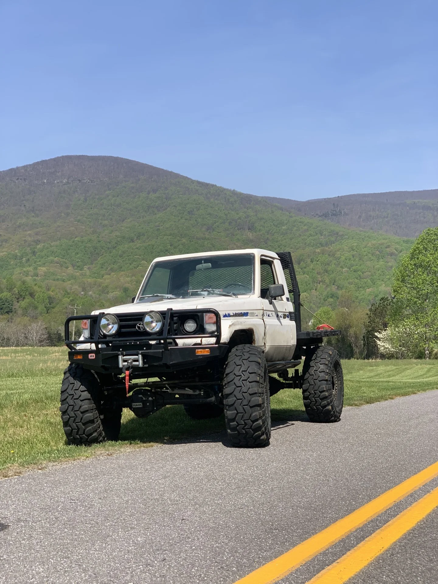

Finally got the bj74 back together for a trip out to UT a few weeks ago. Here are a few shots:

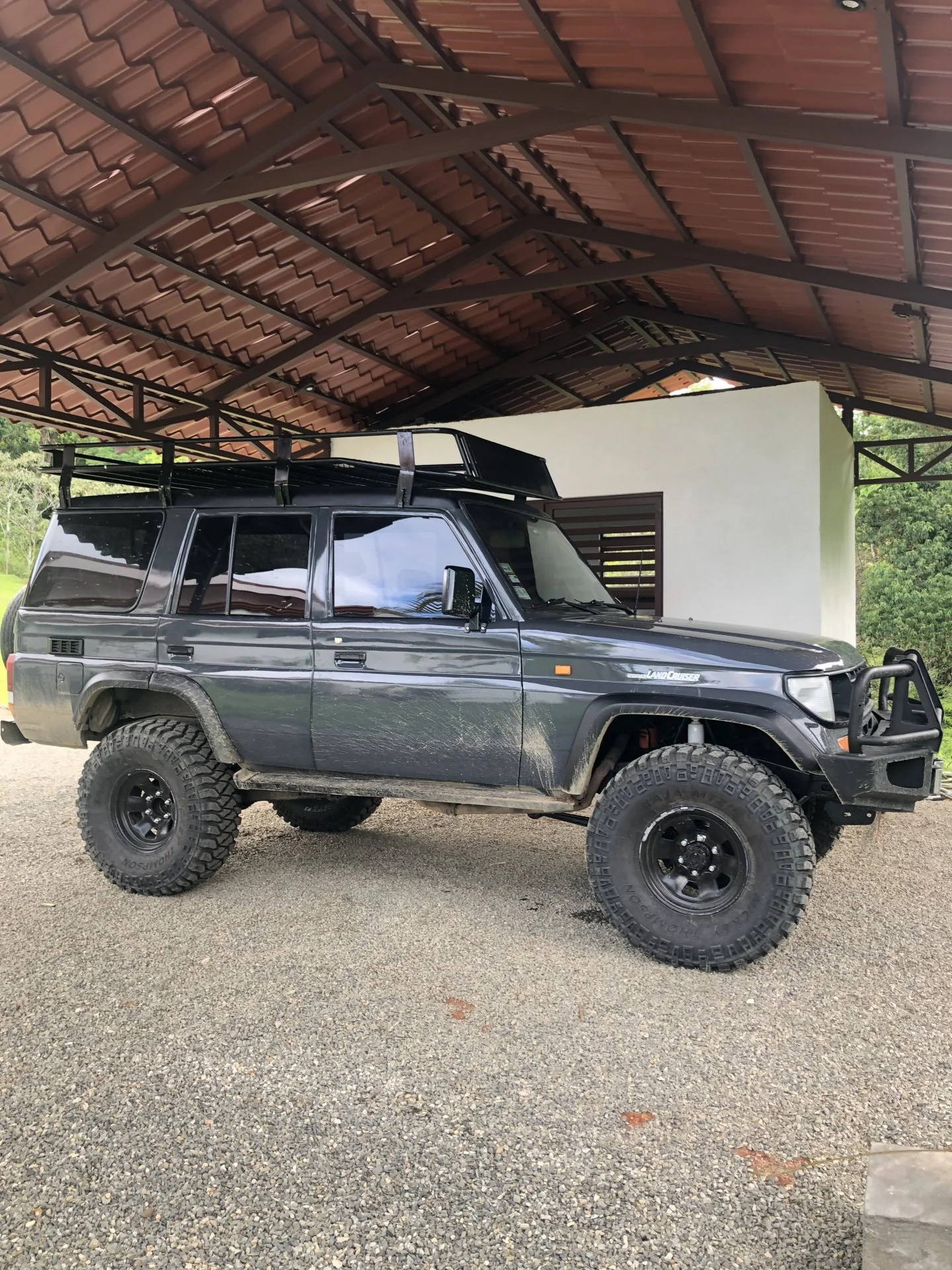

I’m new here. Just picked up this LJ78, threw on the Iron Man kit and 35s. Love how it looks, but BOY is it ever slow. Cant even get it over 70km/k on flat highway. I need some help with figuring out my options on getting it more power. Ayuda por favor!
GM LS V8. You are asking way too much of the 2LT.
Cummins R2.8?
Have a read through this thread, lots of good info here: Ideas for improving the 2LTE - https://forum.ih8mud.com/threads/ideas-for-improving-the-2lte.680759/
It is possible to get decent power out of a 2L-TE, but it takes a lot of work and patience. I chose to engine swap my second LJ78 with a VW TDI, power and fuel economy have both improved significantly, but the swap took lots of time and work and wasn't cheap, even if I don't count my labor. 35's are probably a little on the large size unless you do some significant engine modifications.
Edit: if you only have a 2L then you are definitely better off swapping to a different engine. Is yours manual or automatic?
