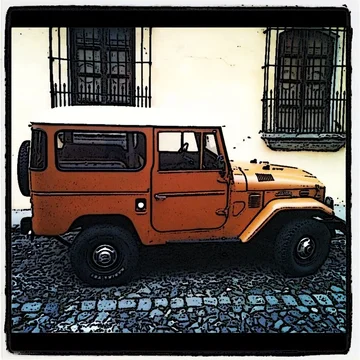

I have a 1974 FJ40 (3 gear) Lots of problems with my points all of a sudden. I had new ones put in -but still fizzle pop as I drive along. Loosing power etc. Friends here that rebuild Rovers recommended that I go with Pertronix and call it a day-
I have heard otherwise though here in these forums. What do you recommend? Help! Suggestions? I need to DRIVE!
I hope that's enough info-
My ride:
