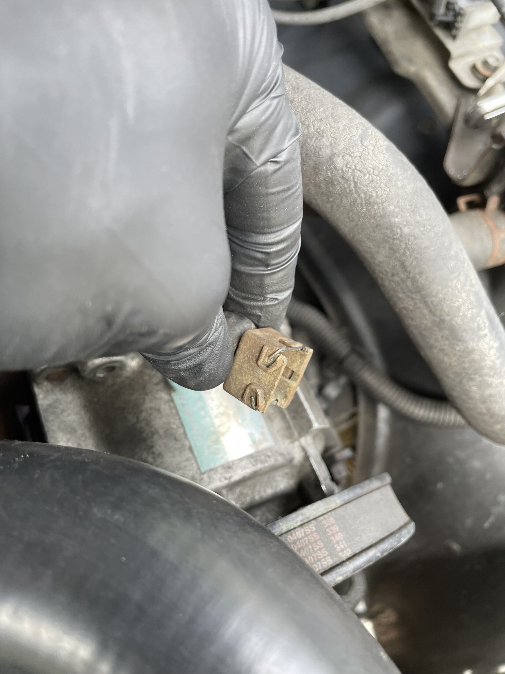

- The connector on the water temp sensor was very brittle/broken, so I ordered a new sensor and connector from @ToyotaMatt and replaced both. Unfortunately that did not fix my issue either.

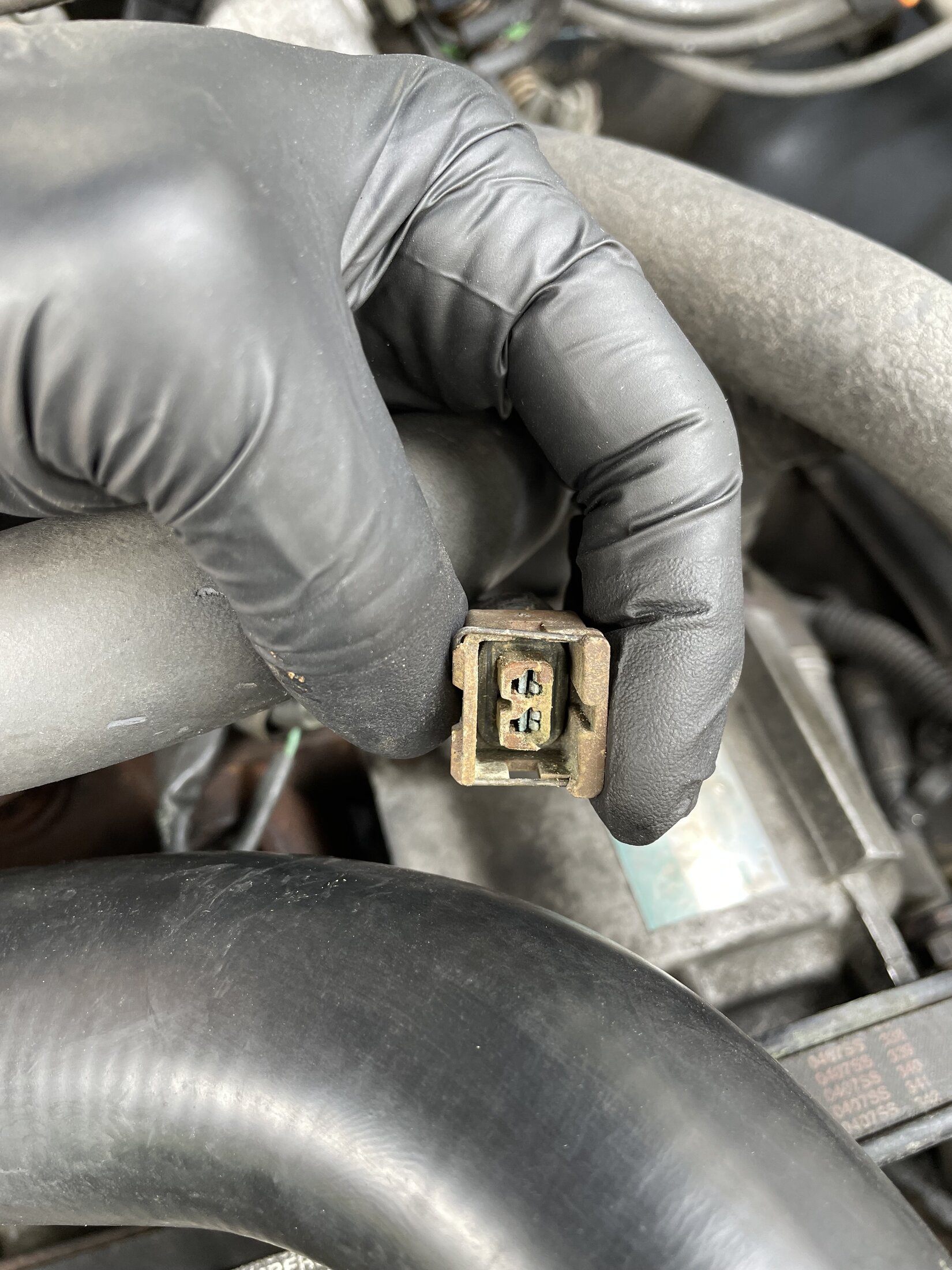

I check the resistance on the cold start injector time switch and it measured 80 ohms which is in the proper range. I’m a bit concerned about the wire harness plug on the cold start time switch though. It’s very brittle and maybe it’s not making good connection to the sensor itself. Is there a replacement for just that female wire harness plug?
I would hit it and the connector on the switch both with a healthy dose of CRC Contact Cleaner (the plastic safe kind in the red can) and see if you can get a good electrical connection with it. You can verify if you have a good connection by checking where it connects to the ECU with an ohmmeter to be sure you have the same resistance there as you do at the switch itself.
