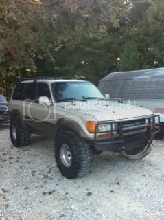

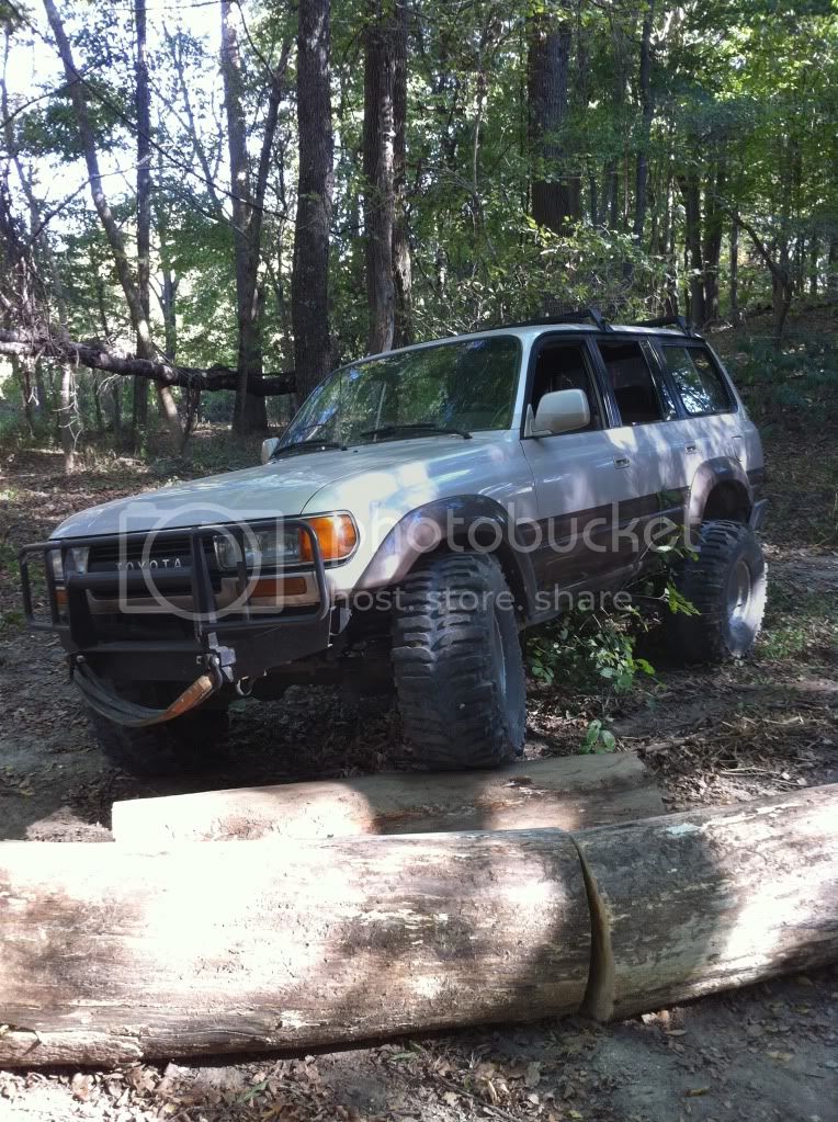

Here's mine with OME 2.5" HD and MAF 30mm coil spacers up front on some 35s Kumhos.
315/75/16 MT/Rs with 2.5 inch OME springs.
Hey Pin_Head,
Are the MTRs flushed with the flares? I couldn't tell by the picture.
OME 2.5", Medium Springs, 30mm spacer up front, 35" Duratraks
Those are the tires I'll most likely be going with :cool:
Currently running 305/70/16 BFG MT KM2's
Now that I have 2 winches, I'm willing to trade off a little mud traction for less road noise, but would also like to fill my wheel wells a little better :hhmm:
Do you have any issues with rubbing?
My 91' fj-80 with 35-14.5 Boggers they rub a little when fully flexed, but not enough to tear the flares off!:eek:
:edit: I'm running 2 1/2" OME mediums with homemade bumpers, I've removed the stock mud flaps and I had to take a hammer to the inner wheel well just a little(1/2") in one little spot.
