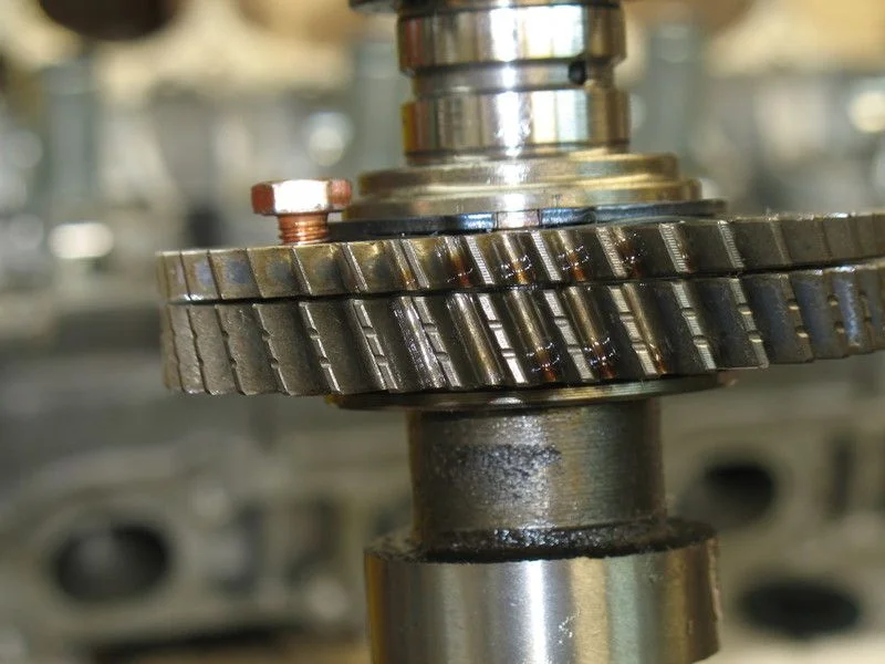

Not sure if this issuse could have something to do with it or not. My brothers 97 fzj80 just did a head gasket so got the head done up etc while its off, on one of the cams gears it has a split gear which is for doing the preload the headman said .He said if you dont do/set this or they go he said they sound really bad ,rattle and idle like a diesel lol just another idea guys
i found a pic on photo bucket of the cam gear i was trying to explain, save me taking a pic
