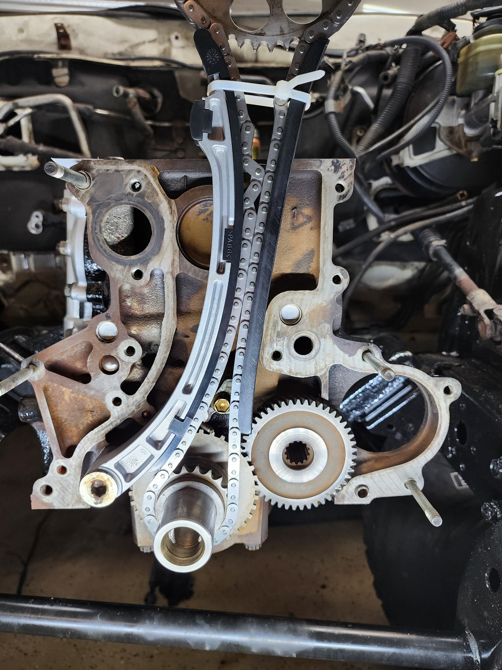

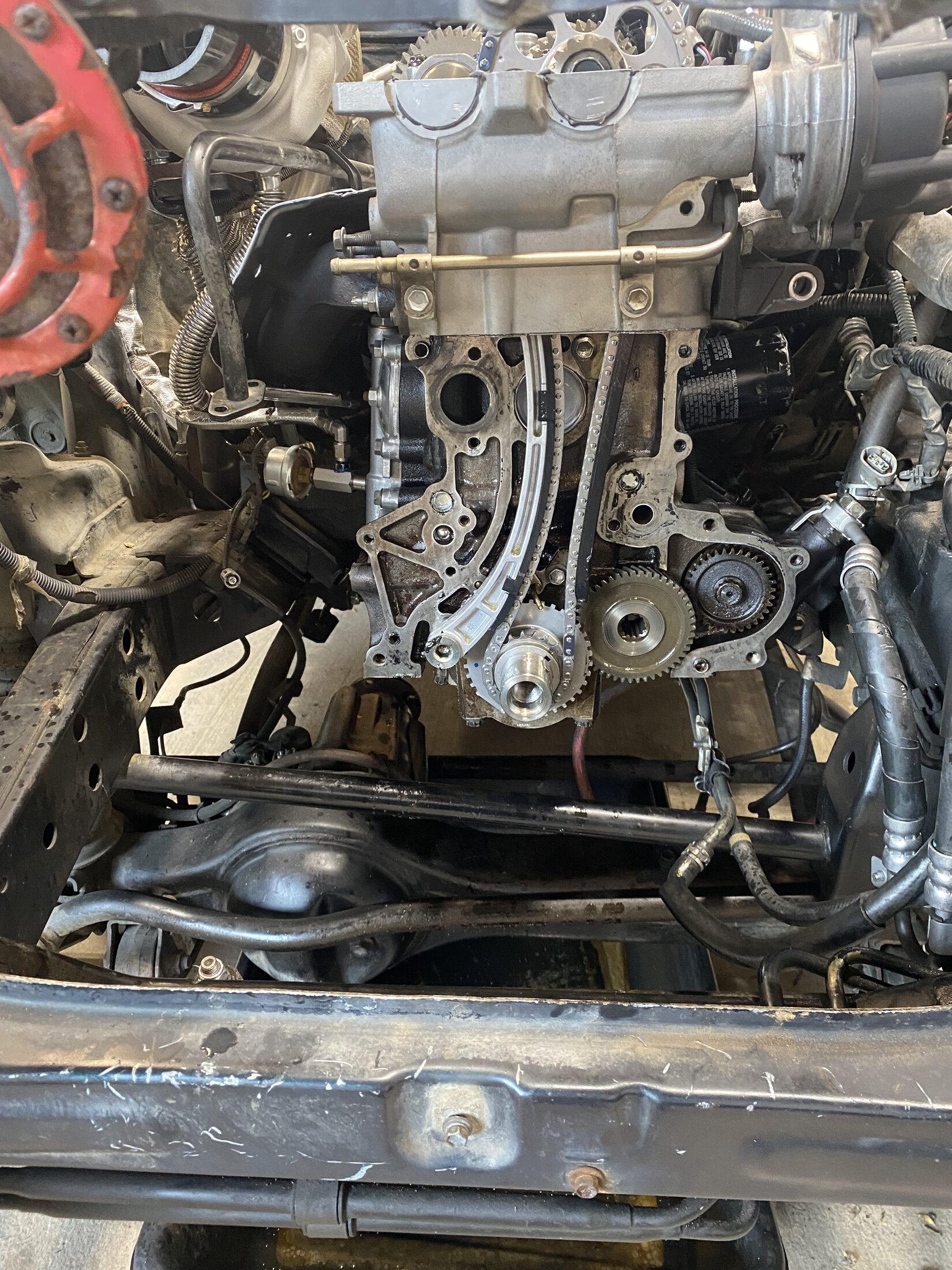

Here’s i pic with the head left on. Be advised this is a 6 hour disassemble and you need two people to set the upper oil pan because of the tight clearance and not ruining your FIPG seal.

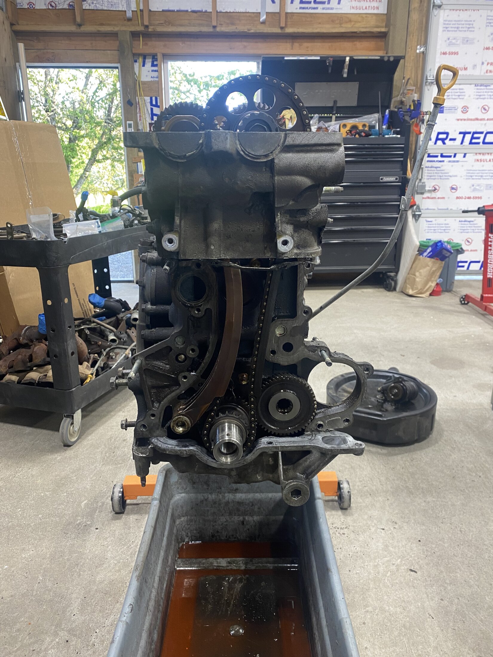

Here is a test engine I pulled just the timing cover off with out removing the head or upper pan. I would not trust this method for reinstalling as you would smear all the lower timing cover FIPG seal off and not catching the head gasket would take some serious finesse!
