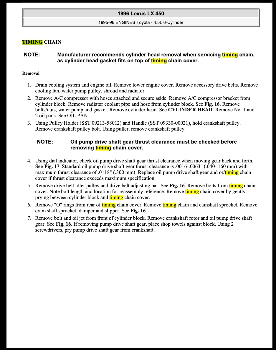

the mechanic says he followed the repair manual.
6. Coolant evaporating every 2 to 3 days but no apparently leak. Many many more issues
I would be hesitant to blame this on your mechanic. You said back on post #43 that one of the reasons that you began the original chain replacement was that there was coolant loss of unknown origin. Unexplained coolant loss can = cracked block/head, head gasket, oil cooler leak, etc.
There was never any reason presented here to think that he did not, beyond some assumptions you apparently made. He *may* have made mistakes. he may not have. Following the manual does not keep that from happening any more than not following it automatically causes them.
What is your point here?
Mark..
Mark..
Not making a point but just answering one of the questions posted here as to why did the mechanic remove the head because its not needed to replace the timing chain. So now after reading the manual he was following, i dont blame him either. He simply followed the manual and removed the head.
I would think following the maual would reduce the odds of mistakes happening.
It does. But if all you had to do was follow the manual for a guaranteed result... any IT worker, insurance adjuster or toll booth attendant could fix your Cruiser for you. Or build a space shuttle! ;)
Mistakes happen. Even when you know your s***, mistakes happen. That is why they are mistakes. :confused:
