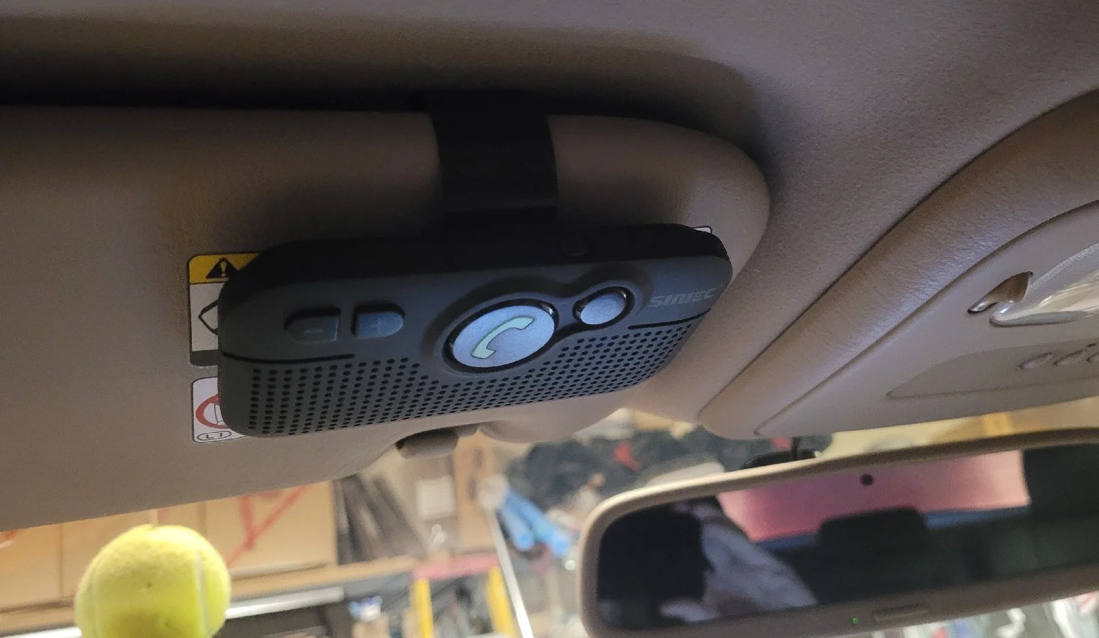

I use a magnetic mount for my phone and a Bluetooth device with built-in Speaker for hands-free phone use.

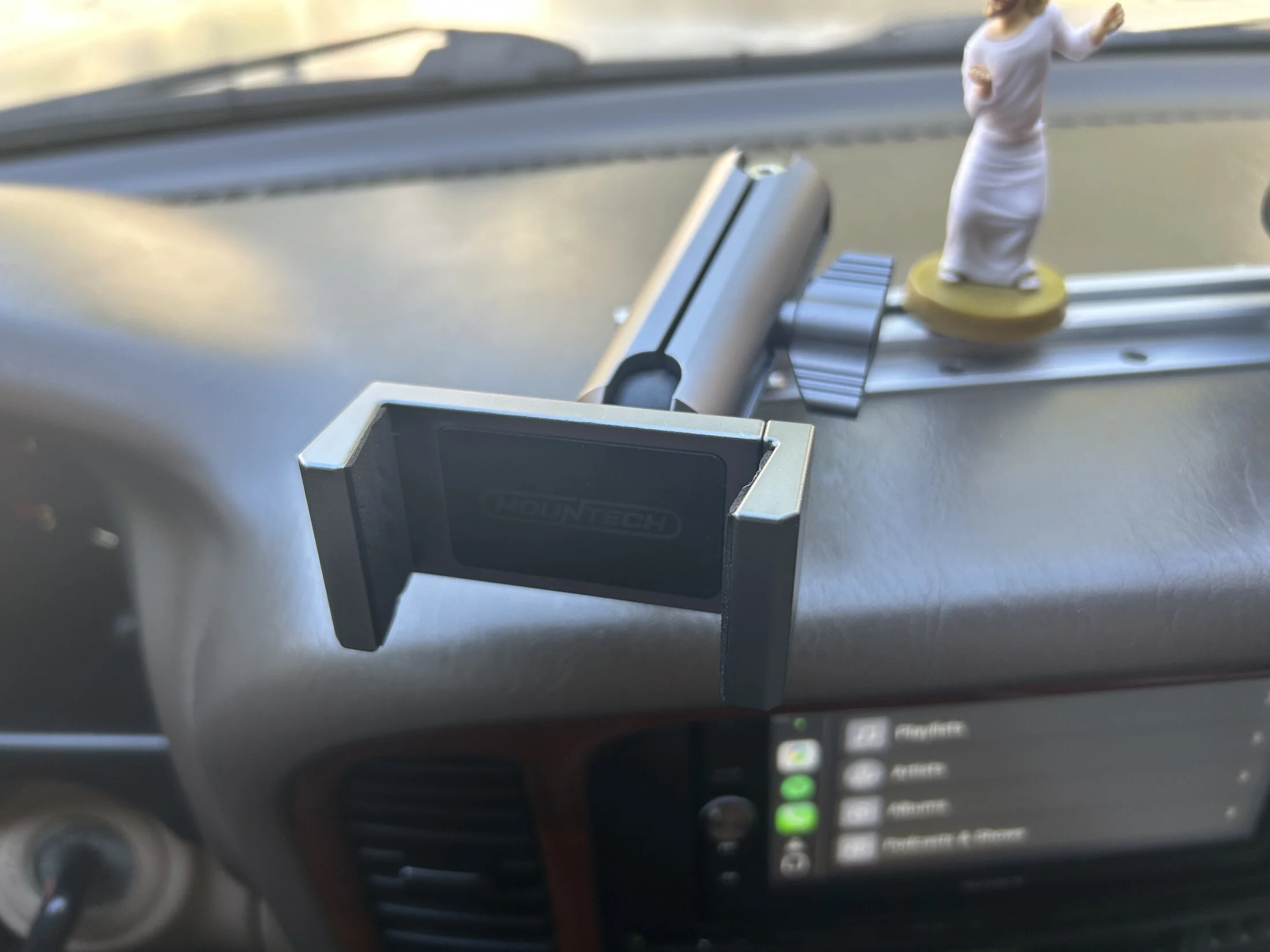

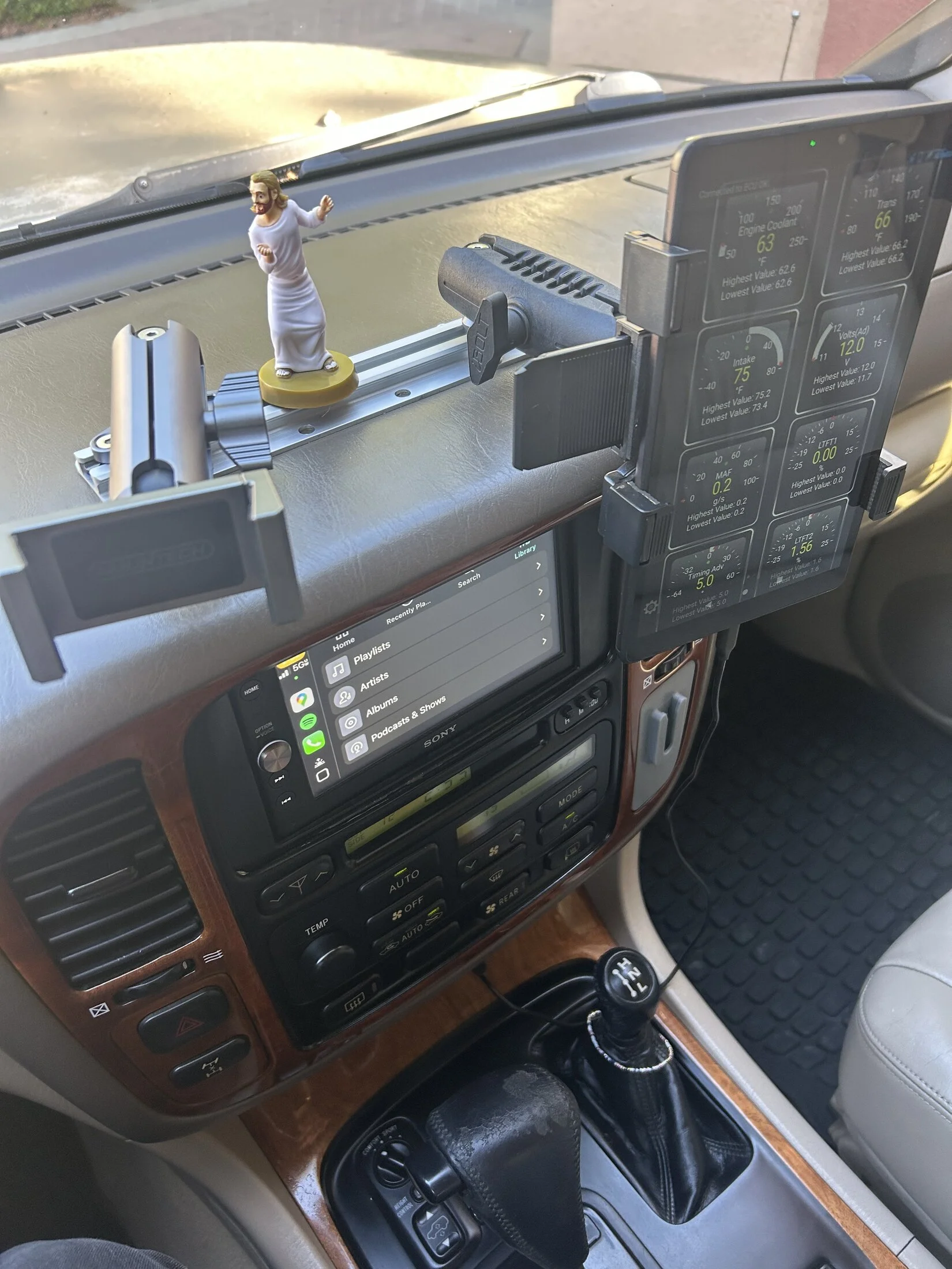

Big fan of Mountech phone holder. It uses a 1” ball (“ram”-type) mount so lots of options. I drilled into the dash with four holes to secure this T track. I made a support plate for underneath the dash and it’s bomber. Never ever moves.

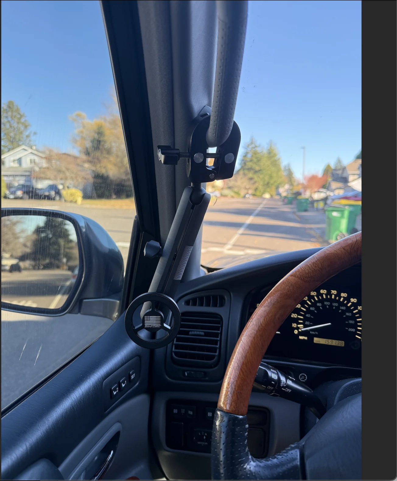

Rockform Magnetic phone case > Bulletpoint magnetic 1" ball mount > Fanadue double socket arm > brocovan aluminum alloy handlebar clamp mount with 1" ball joint clamped to the "oh s***" handle.
