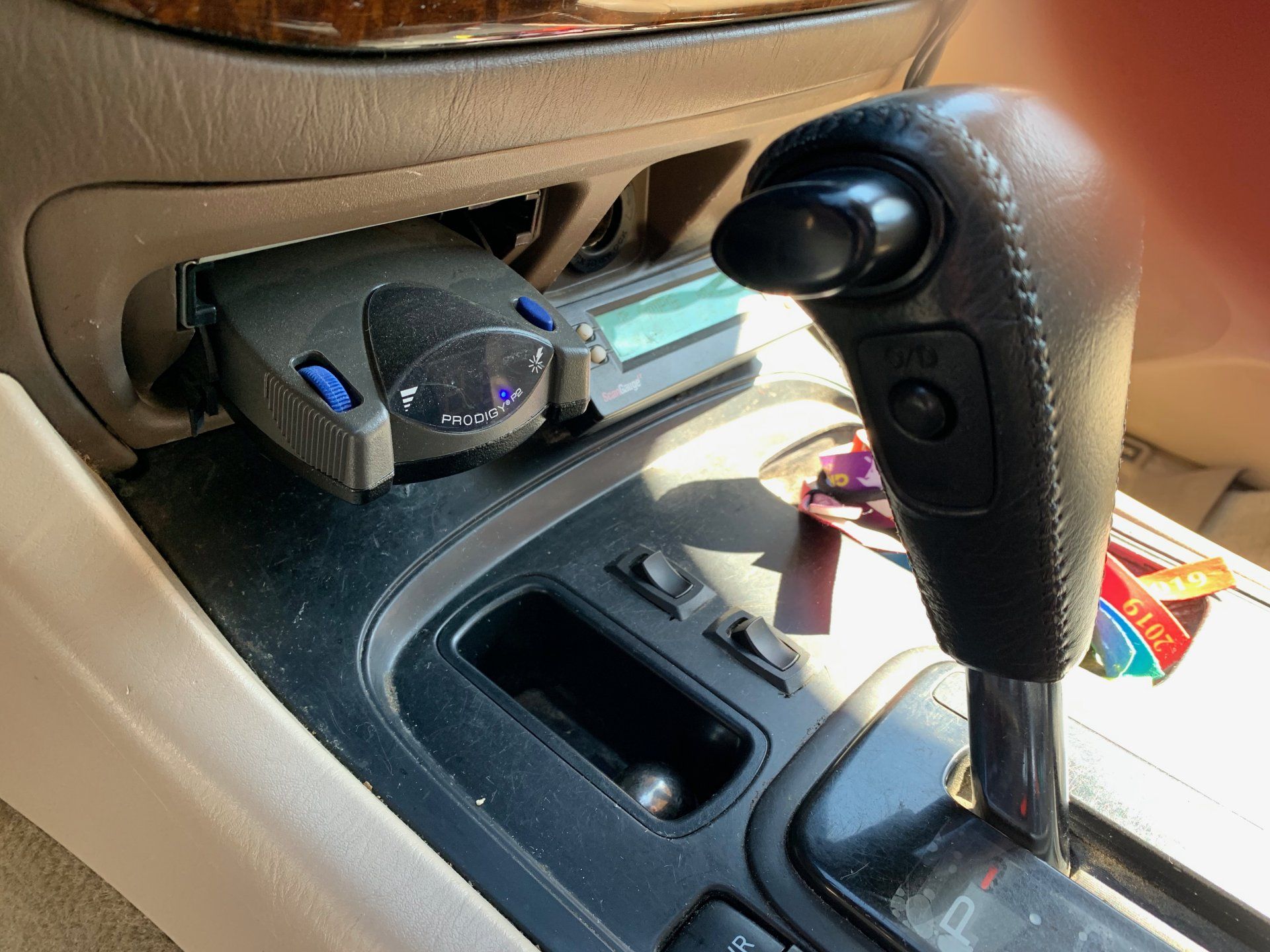

I’d love to see an integrated trailer brake controller housing, and a smaller 4 rocket switch panel to replace the homelink in 04-07 lx470s. Hoping to find a trailer brake controller able to fit in the ashtray

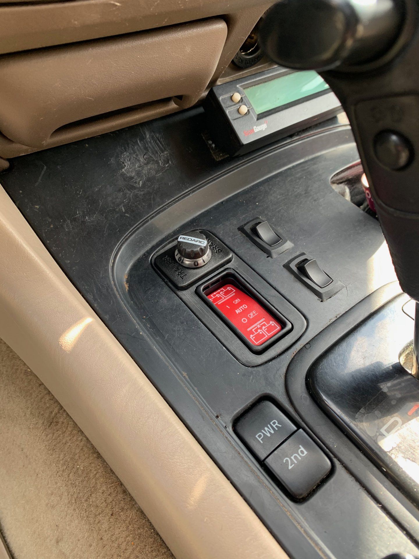

Well through the ingenuity and collaboration with @BenCC i was able to take the braking controller *Out* of my ashtray and get a much more functional controller along with some space to re-do my legacy Luna dual battery controller. switched out to the ML-ACR and now I have a much cleaner cockpit!
Looks simple from this before and after - but I spent much of the weekend gutting the dual-battery system and installing the ACR, and swapping the trailer controller. Redarc makes it easy to go from the Prodigy to Redarc with a power/interface cable matching the Prodigy wiring - just plug and play.
Thanks to @BenCC for working with me to create this configuration! Hopefully this doesnt put too much stress on him for more!!
Before:

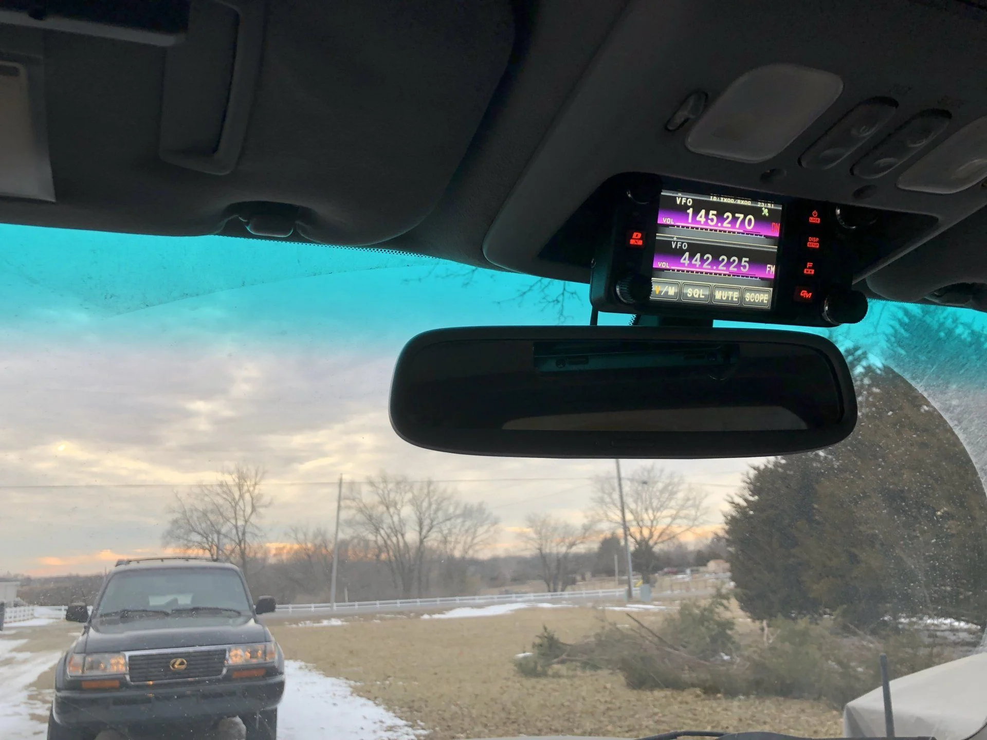

I have my Ham above in the sunglass / homelink spot - i hacked together something for my 610 a long time ago. I already have way too much going on on my lower console and looking down while driving isn't a great idea... so I like the HAM high! I'll probably get the new 610 mount shown above since it increases the viewing angle to what I did.
Before:

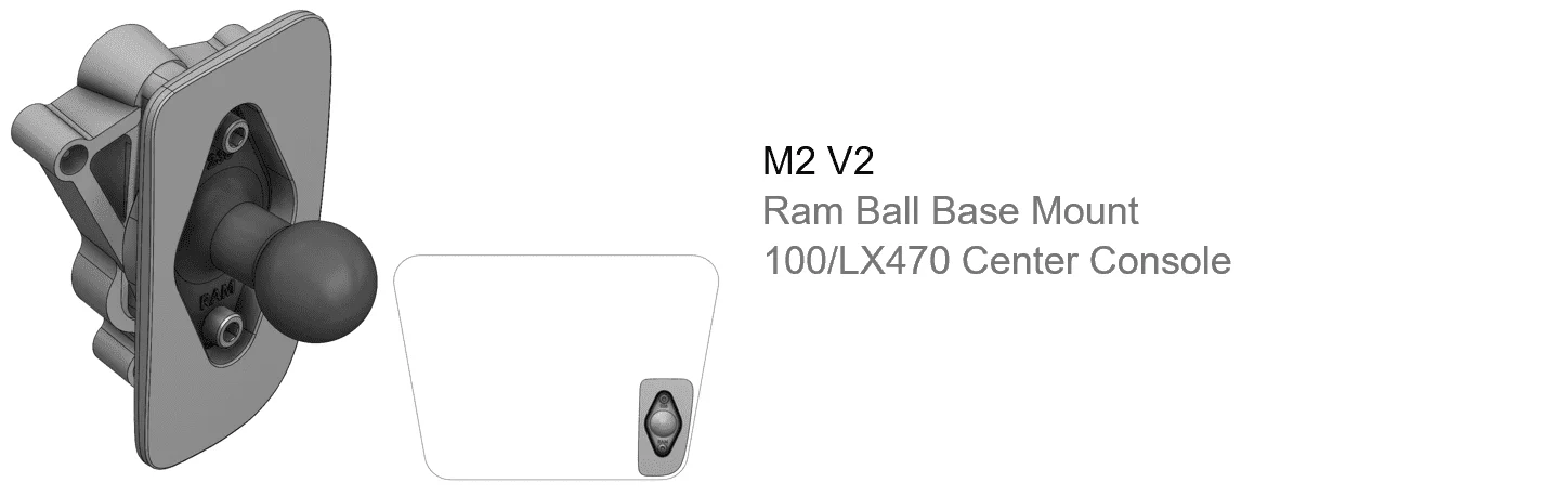

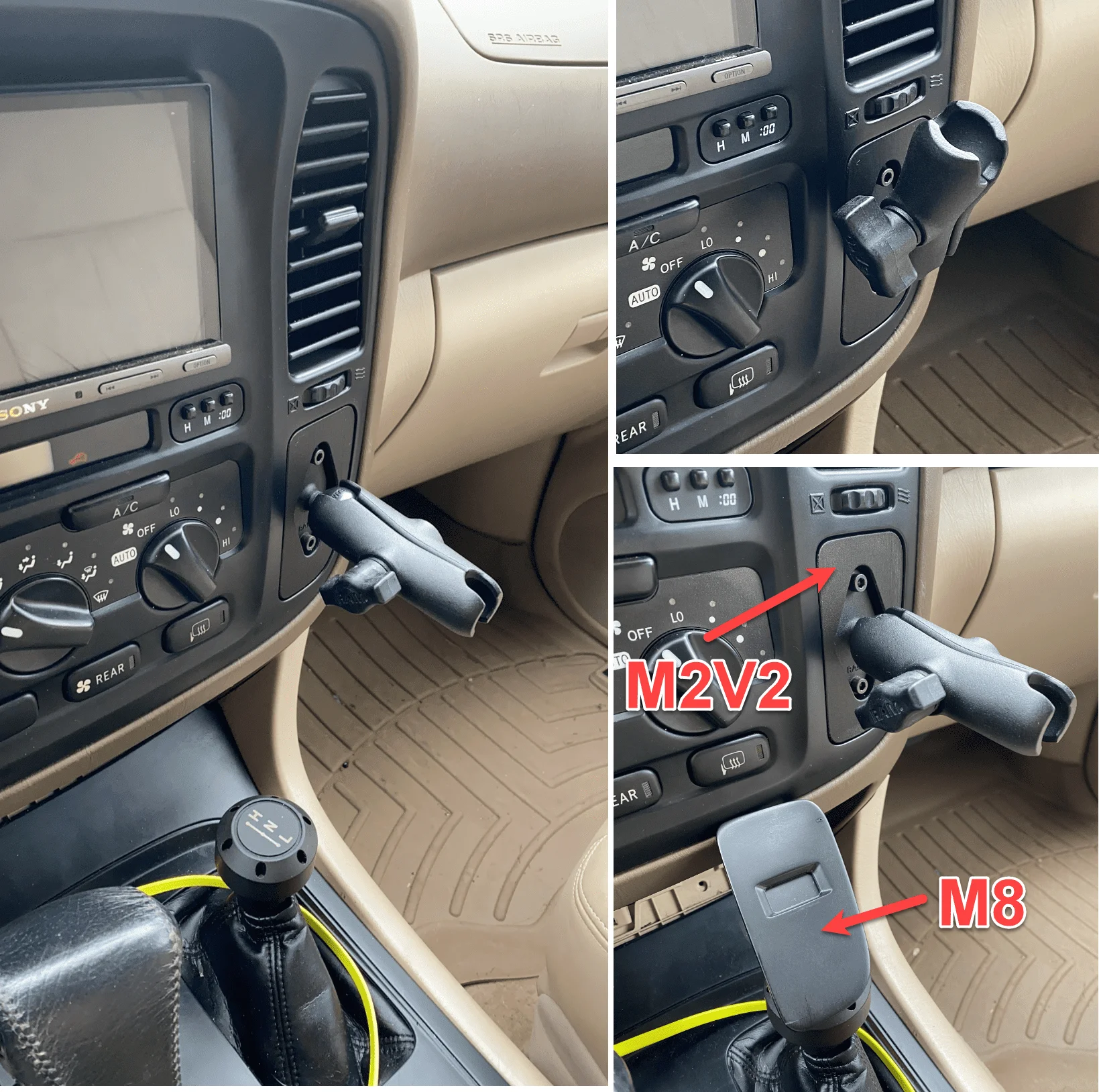

Make 2 V2: Ram Ball Base Mount
1. Overview of the Final Product
This is the final product, M2V2, installed on my truck.
2 Introduction

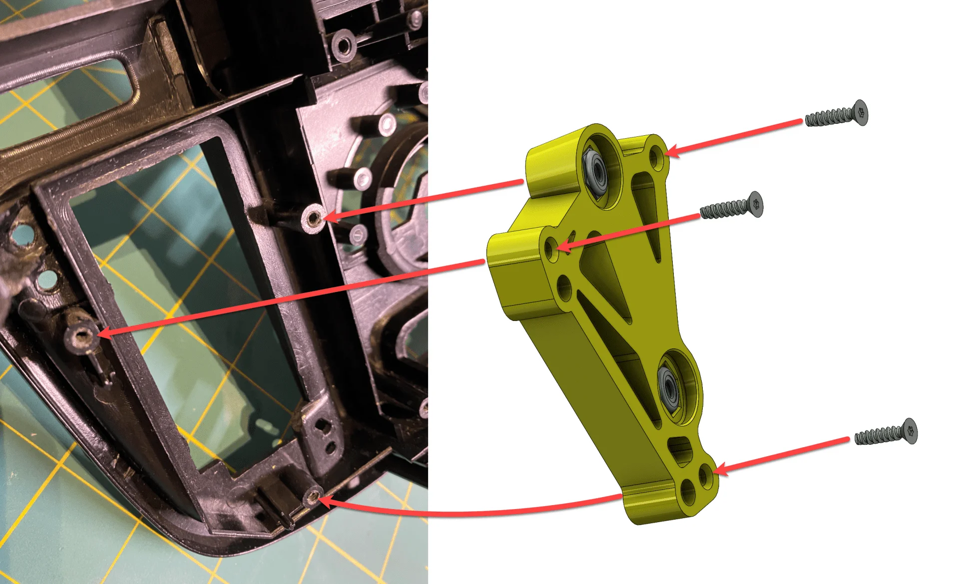

The design has two parts, the backing bracket and the face panel. The backing bracket is to reinforce the factory panel. Three existing fixture points are used.
The following figure shows the whole assembly (Ram ball mount is not included in the order).
All fasteners are 18-8 stainless steel and will be provided.
Three #4 Flat Head Thread-Forming Screws for Plastic
Two 10-24 Nylon-Insert Locknuts (Black-Oxide)
Two 10-24 Socket Head Screws (Black-Oxide)
2 Introduction

I'm really excited how this turned out. The design work from @BenCC is spot on and it's a perfect fit for the YotaMD printer since it calls for high strength and a great surface finish. It's a rock solid mount and you could convince a lot of people this was an OEM option by the looks of it. Recessed and form fitted. Really well done, Ben!
