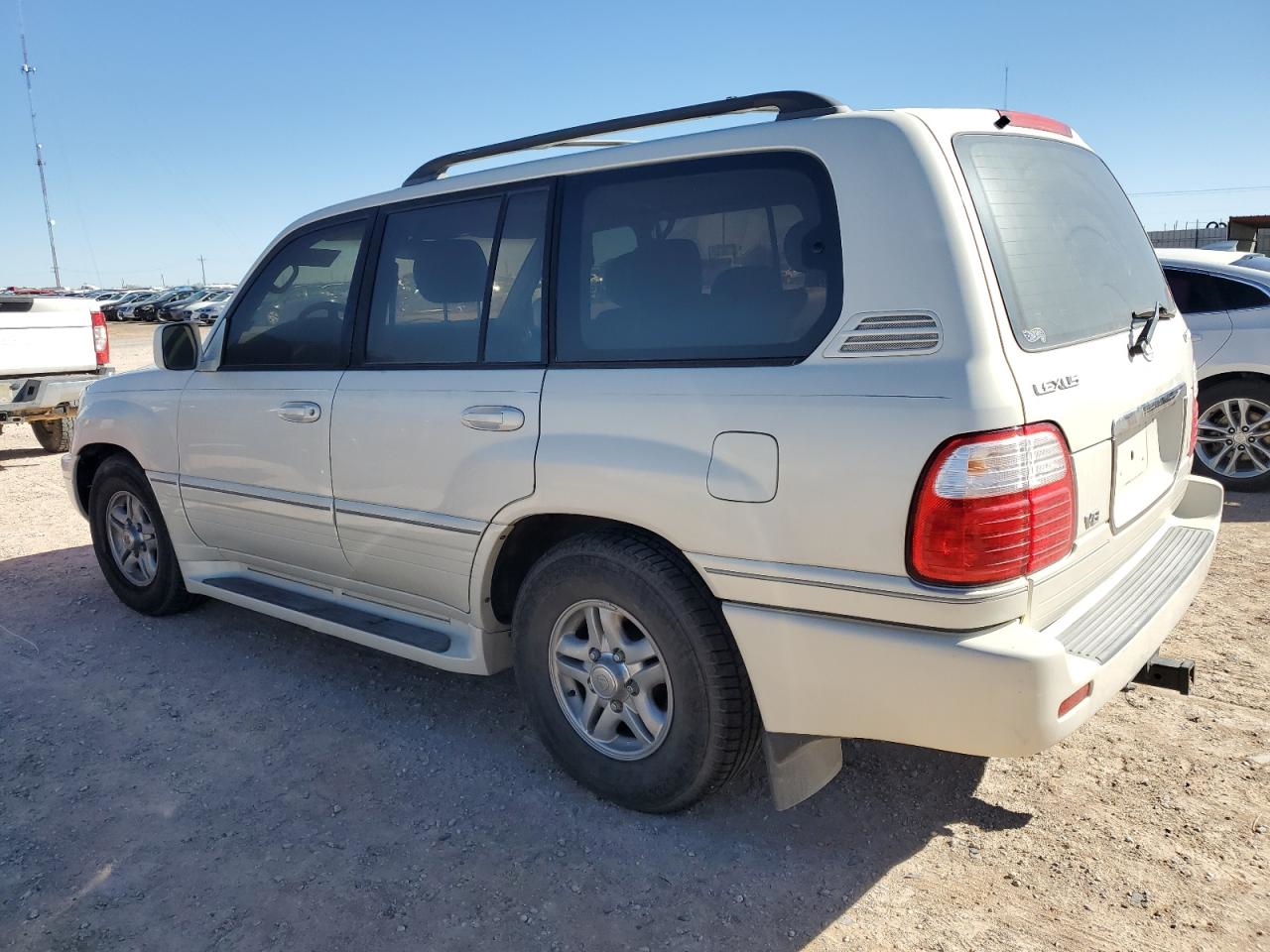

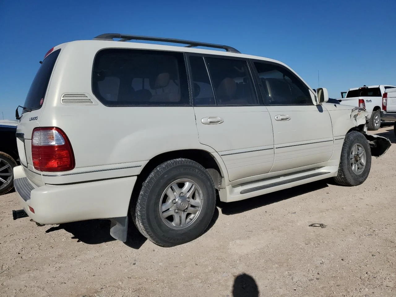

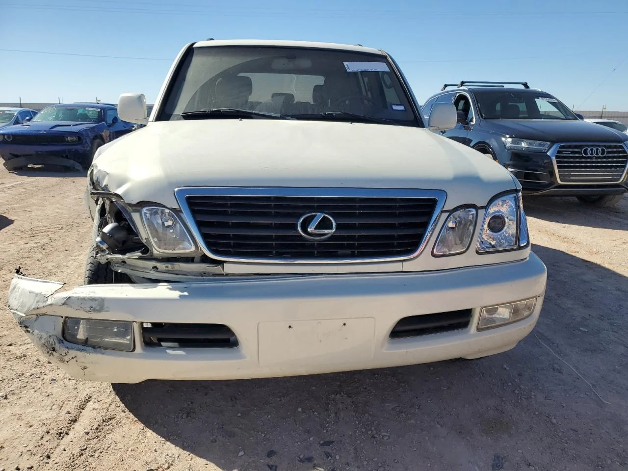

Ok ;)
Congrats! That looks like very light damage to me.

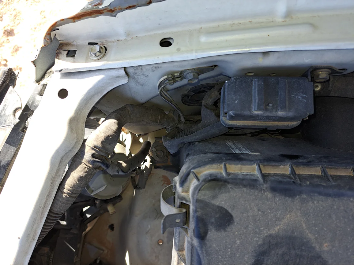

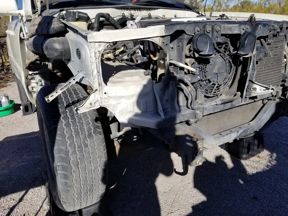

Yeah it is pretty light, the fender and fo-bumper took most of the impact, the inner engine bay got push in about an inch but was pretty easy to pull out using a hydraulic ram. I wish I would have taken more before pictures of that area, because it turned out real nice.

Is there any frame damage? And what were the miles on the odometer? Sorry if it’s already been mentioned. Congrats

Zero frame damage!
The only thing that might have took a small hit was the upper ball joint, the boot is torn.. and it looks fresh, so, I plan on doing the upper and lower ball joints on both side just for the hell of it. Right now it goes straight down the road, pressing the breaks hand and it does not pull left or right, so 99% sure it is G2G

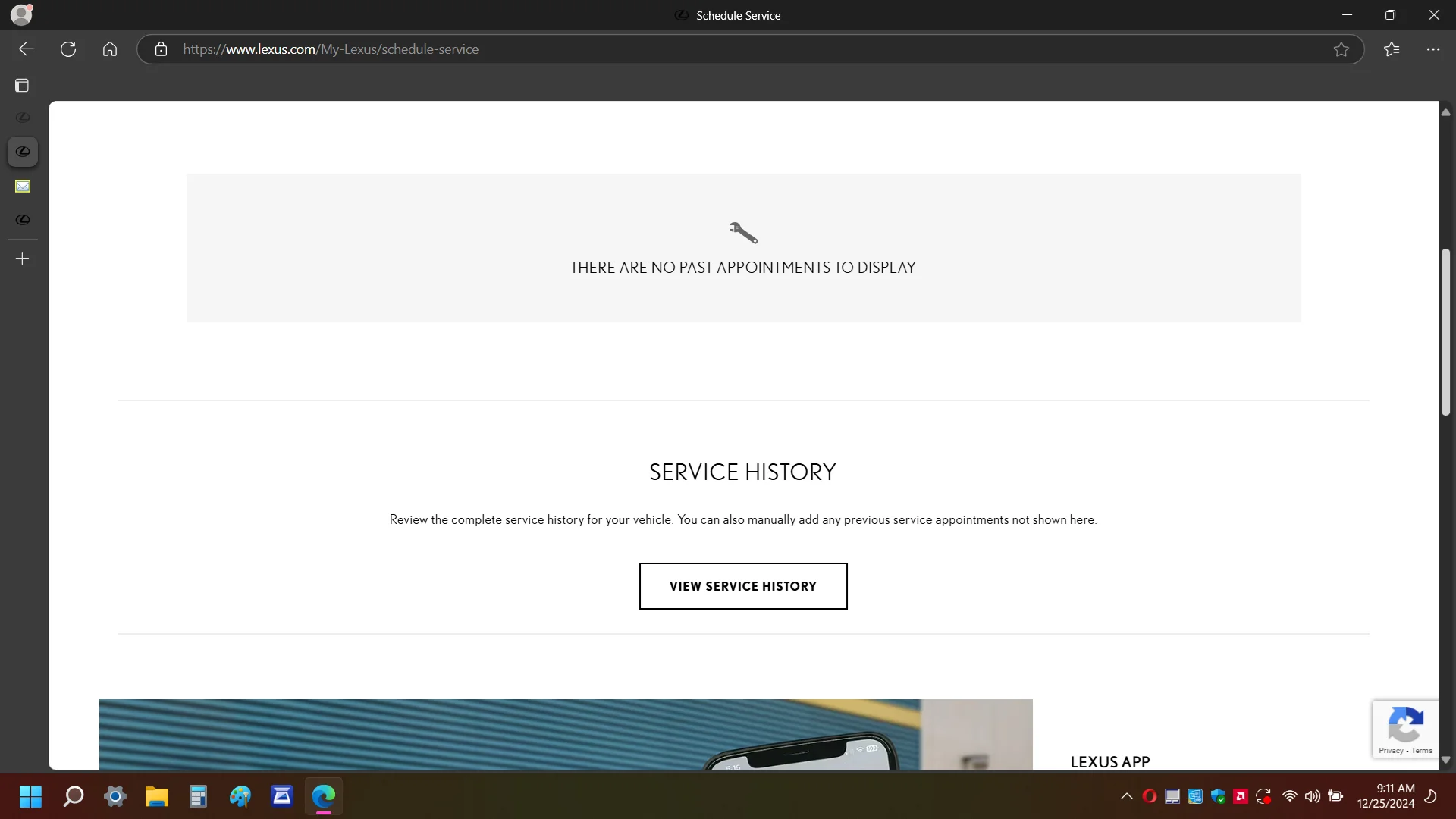

Also went to the Lexus website service history and punched in the VIN.. The original owner had the car for 21+ years and took it to Lexus for all the services, even the oil changes! So it was take good care of!
Here is the link.. It is not a direct link to where you punch in the VIN, you have to join and click on a few extra things to get to that point
Update on the Lexus service history..
I kind of forget how I got there.. I had to join.. Than had to add my vehicle via the VIN.. Than I was able to navigate around and found the service maintenance area.. and than got to the schedule-service area.. There it had the option to view the service history! Note AFAIK this is just the Lexus dealer history!
Here is a pick of the website and the button

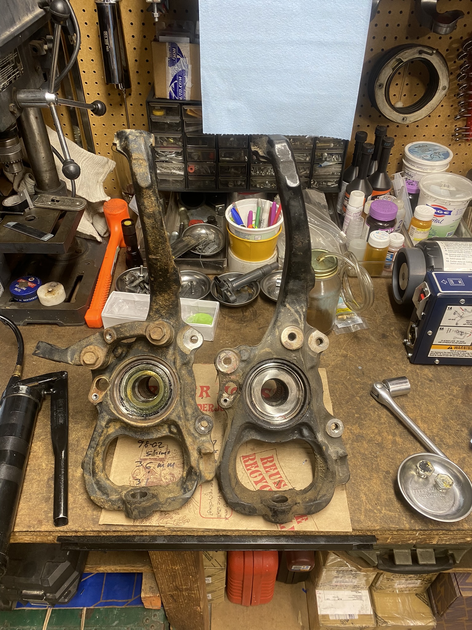

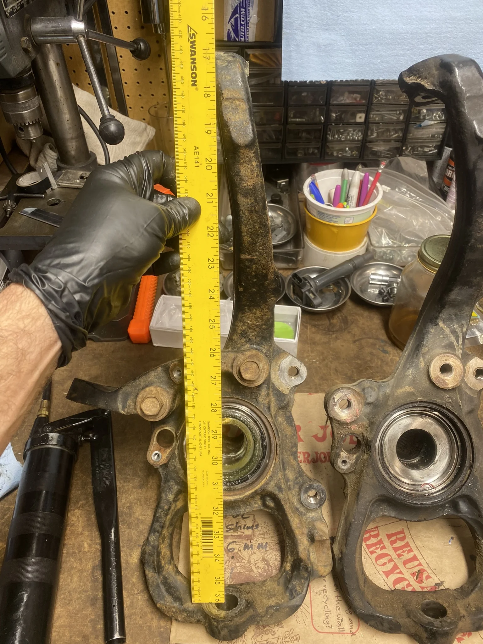

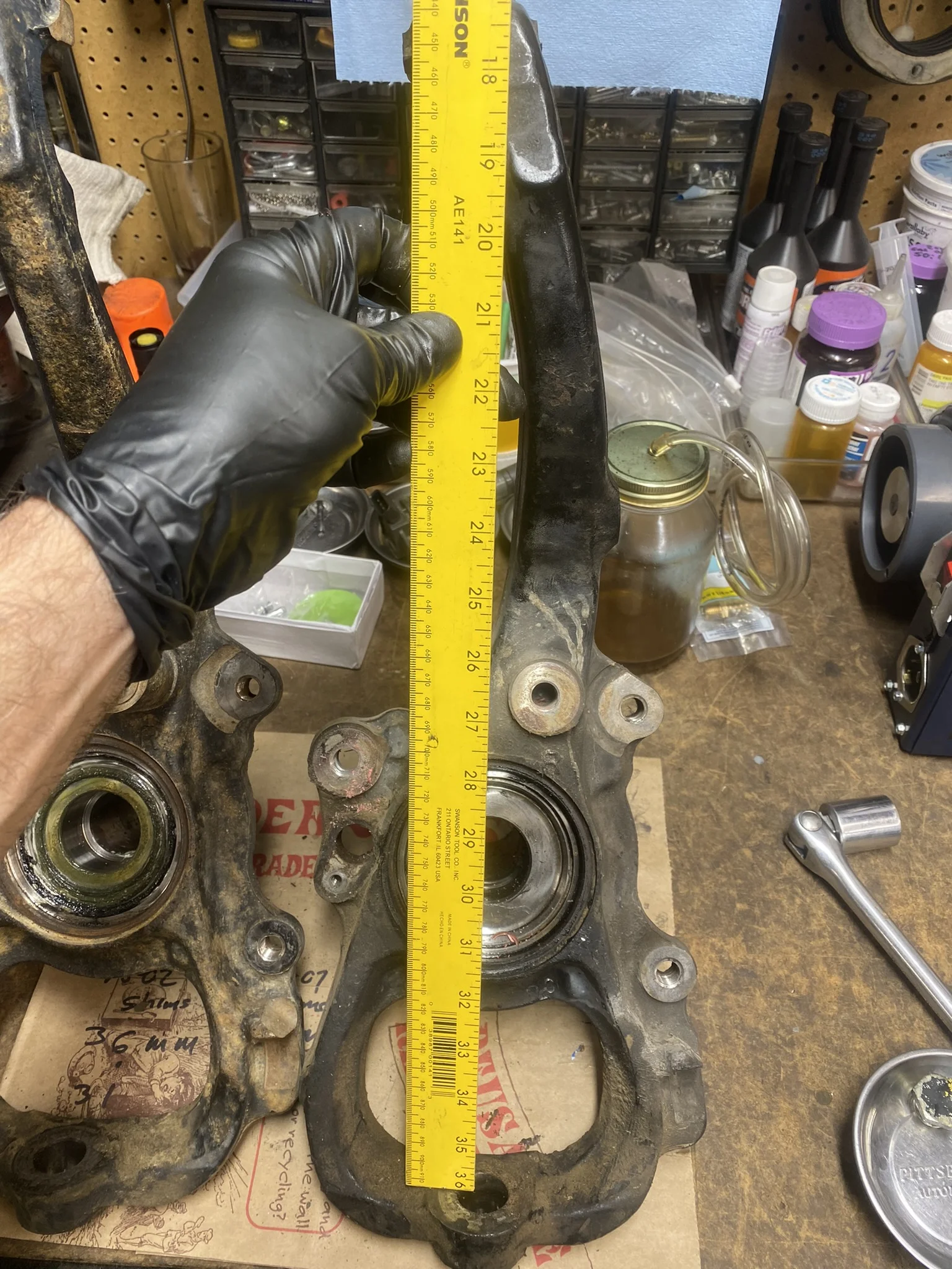

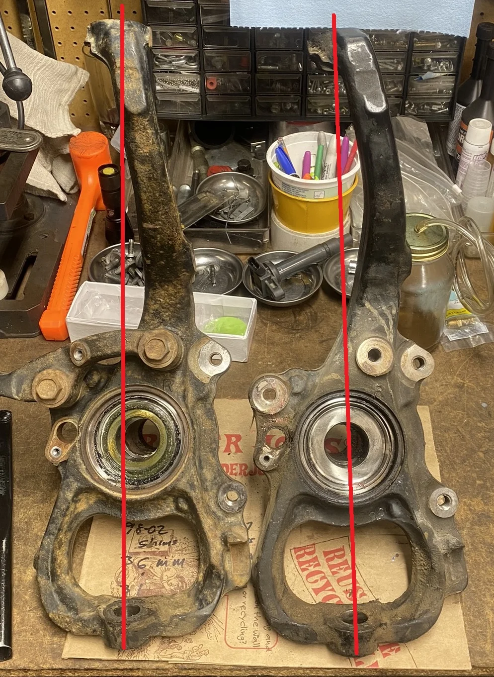

But looking at damage to RH front. It's, very likely knuckle has been bent. For sure, I'd check it on the bench.
I use levels (not shown). Placed on knuckle where LWR & upper ball boots would ride. With LWR level, top should be level also. Both side to side and front to back.
A straight edge helps eyeball.
Here, upper ball joint hole should be center, with LWR and spindle. It's bent!
Here, line passes through all 3 centers. Eyeball test, looks good.
Your RH ( your RH, as your facing picture) cleaner looking knuckle, is bent
Often with front side impact. Frame does move or bend a tad. One clue I've found, is when pulling #7 coil. It gets hung up more than usual.

But.. I think I might be able to pull this and fix it.. It is a tight bend, might not pull clean
Will do!
I think I am good to go! My Copart 2004 Sequoia took a much harder hit in the same spot, but there it actually pushed the tire back and flattened out the alignment tabs.. The good news is this is pretty common for the 4x4 guys and their Sequoias so replacing/repairing alignment tabs is pretty common. The control arm was fine. But yeah, Ill take a look at the knuckle on the LX, in that even though it does go and stop straight, it did mess up the alignment enough to cause the steering wheel to be off a bit.
I 'hear' what your saying..
Just hard to 'see' from the pictures..
But I know what your saying and what to look for!
Thanks a million!!
