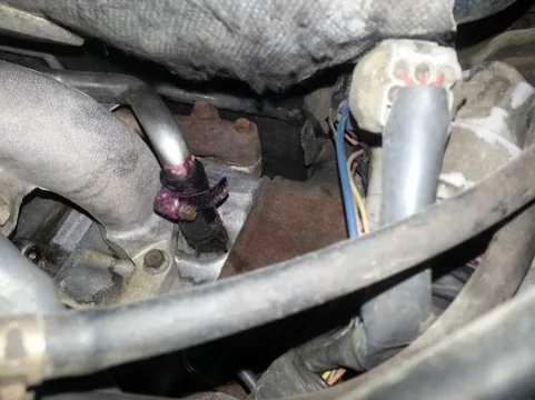

The offending hose.
Doesn't look that bad but it is leaking for sure. If you can get your tools like that camera then it looks WIDE open. I did mine awhile back and remember it was not bad at all. I did not take off the starter or anything else. To take hose off make a slice with razor blade length wise on the hose, then you can just peal it off.
It is done. Was not bad at all. The rubber hose broke apart when I was pulling it out.

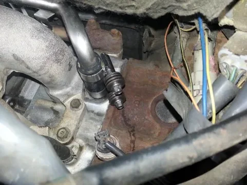

Look at the pic....the orange wire has to be put back together. It was twisted with a piece of electrical tape around it. What is this wire to?
No idea on the orange wire, everything there should be in a loom or sheathed, possibly something aftermarket? Alarm?

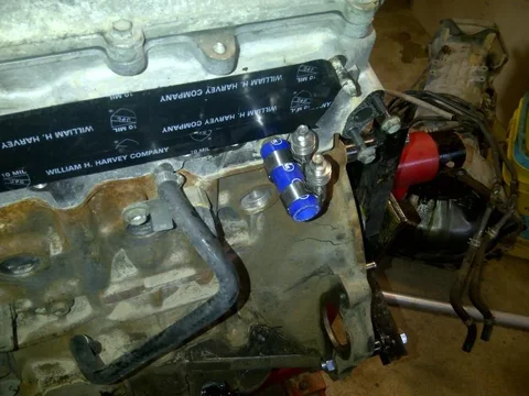

Also, there is another small heater hose under the intake. This is a good picture below of one next to the blue silicone PHH.
The black hose is the throttle body bypass hose (either #1 or #2, can't remember specifically which) - runs coolant through the throttle body to prevent icing up.
It's somewhat more of a pain to get to since it's crowded even more by the knock sensor just under it and intake manifold above. I replaced mine (straight run to my s/c) when doing a bunch of other valve cover/injector work so that the top intake manifold was off - still a pain to get to.

It's the #1 bypass hose
