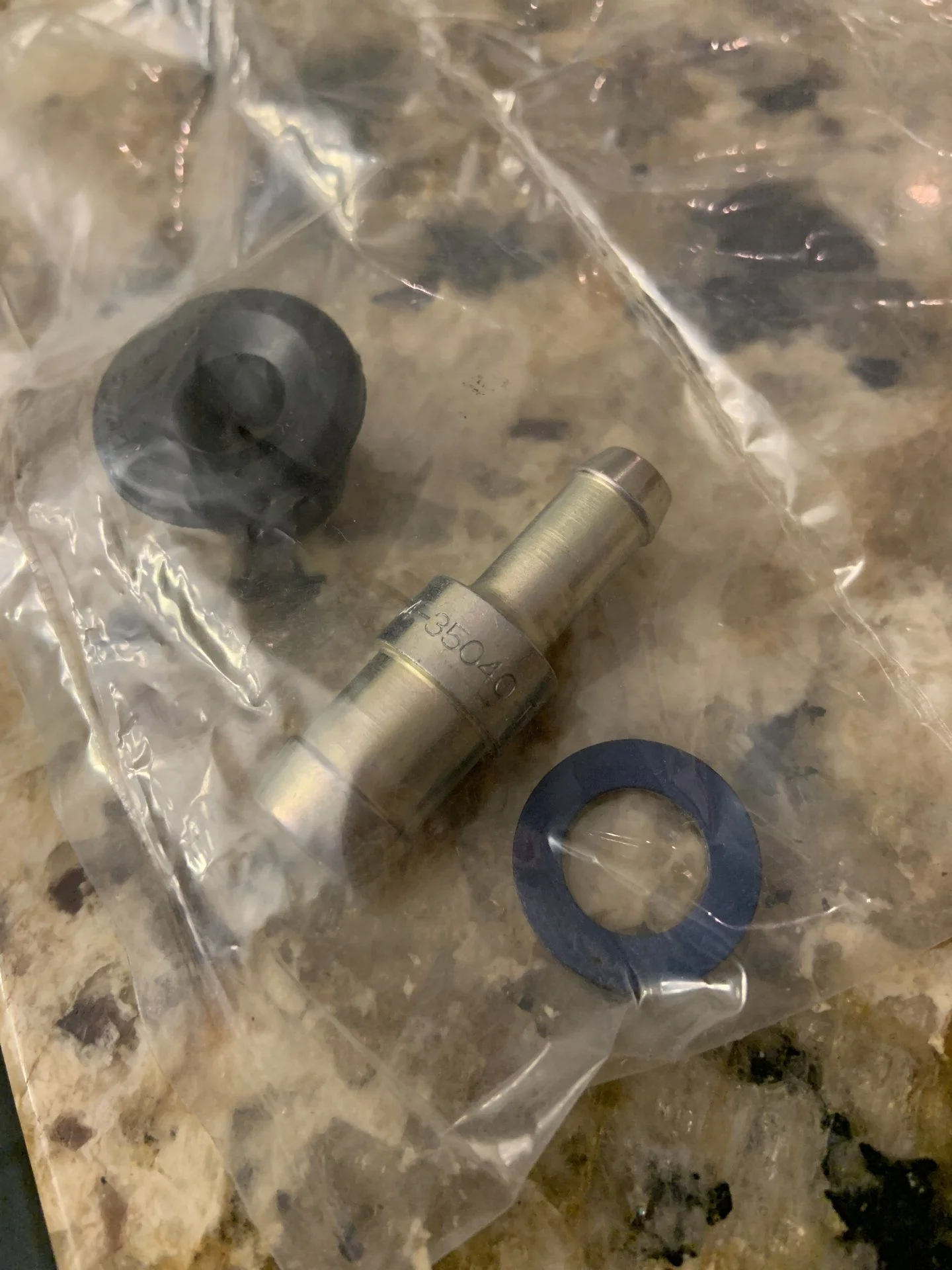

Here are the 3 pcs that came together

Finished, the replacement. With a pair of vise grips, wiggled the valve in all directions until the bottom part of the grommet broke off and fished it out with a pair of needle nose pliers. 10 minutes tops. Btw the third piece was a oil drain gasket.

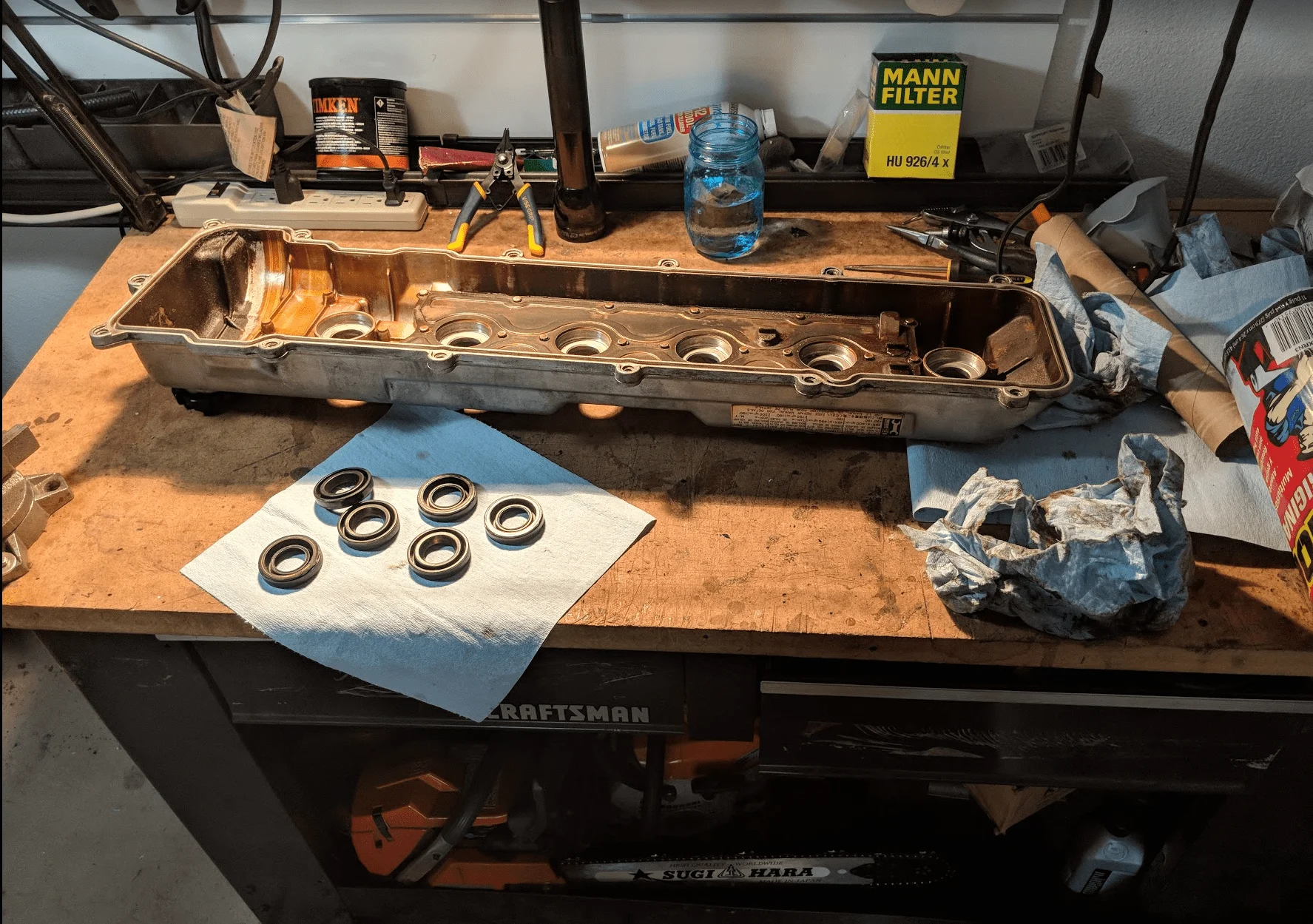

Next time pull the valve cover and do the PCV / spark plug tube seals / valve cover gasket all at the same time. So much easier on the workbench.
I was going to do that and I'll regret not doing it because I most definitely need to do the spark plug tube seals and gasket. Still waiting for the valve cover gasket to come in. Does it require any special tools?
No special tools needed, other than be careful not to scratch the aluminium surfaces with a screwdriver (or whatever tool ends up working) when removing the spark plug tube seals (they are stubborn to remove). Be sure to wash off the engine before taking things apart.
