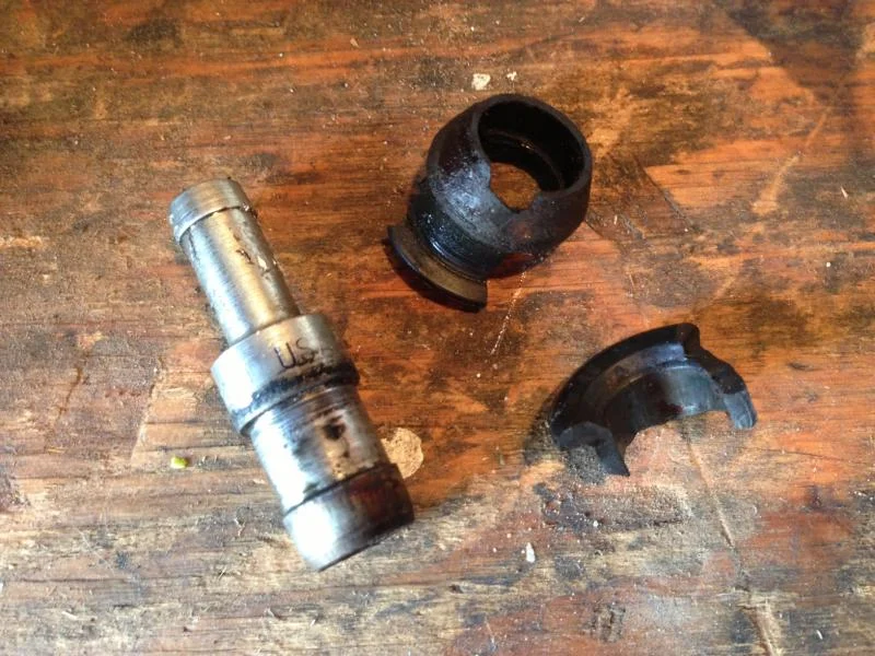

I had the same problem with the PCV valve and grommet that plutonius mentions. My valve slid right out without much effort. The grommet separated into two part - upper and lower - with the lower going inside. After some fiddling with some needle nose pliers, I got the piece out. PITA.

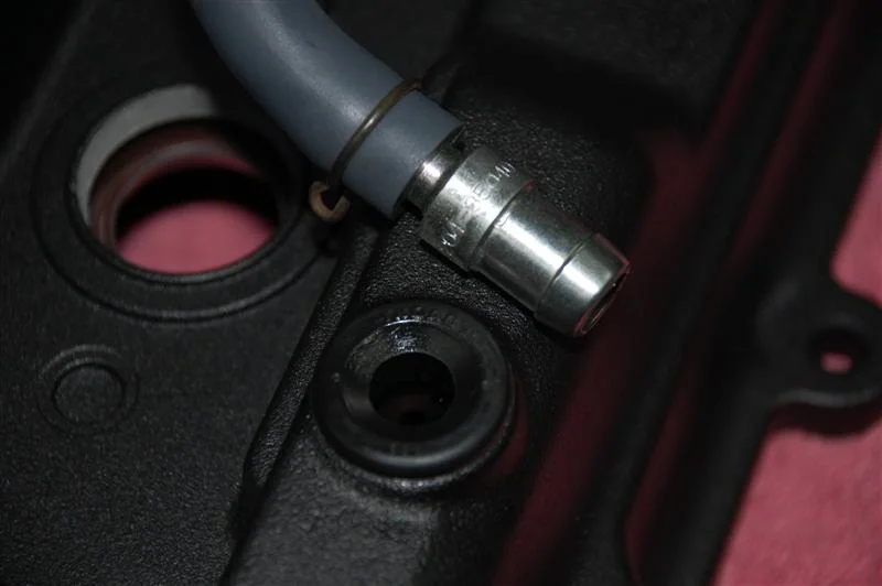

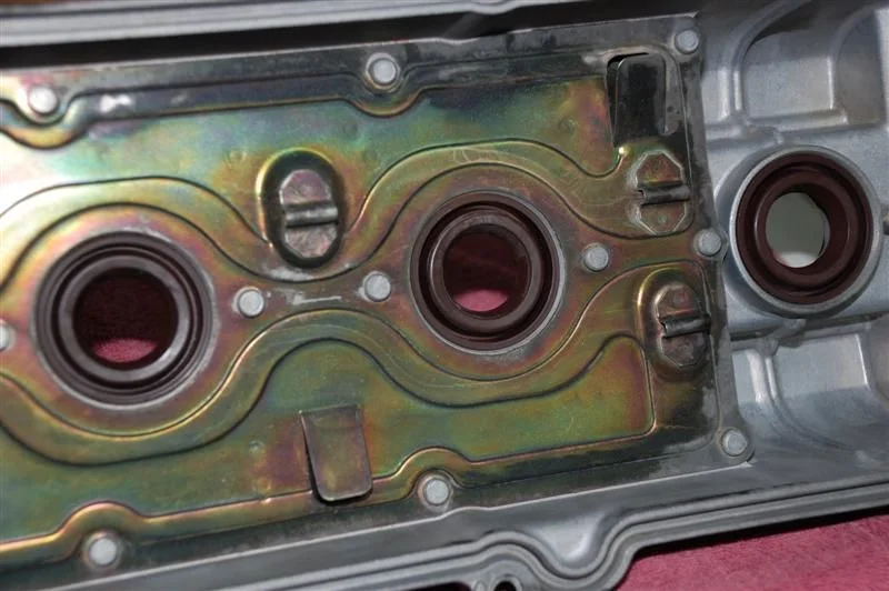

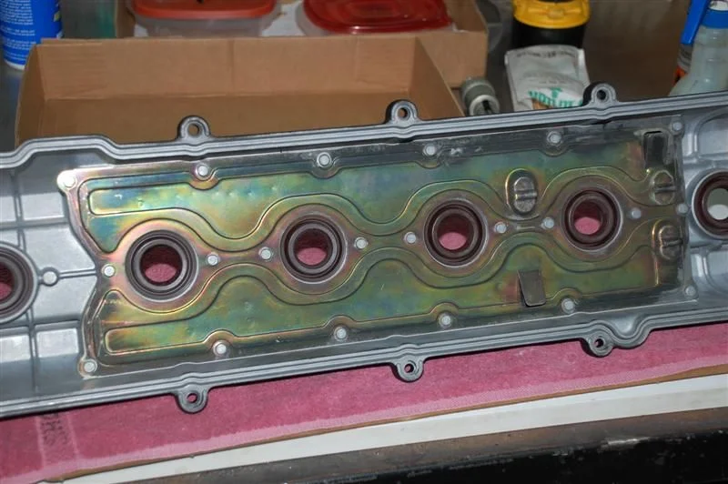

I'm looking at the parts right now. Here's a couple pics - Live Action! :hillbilly: <= turtleman?
Not a lot of room for a big piece to go through.

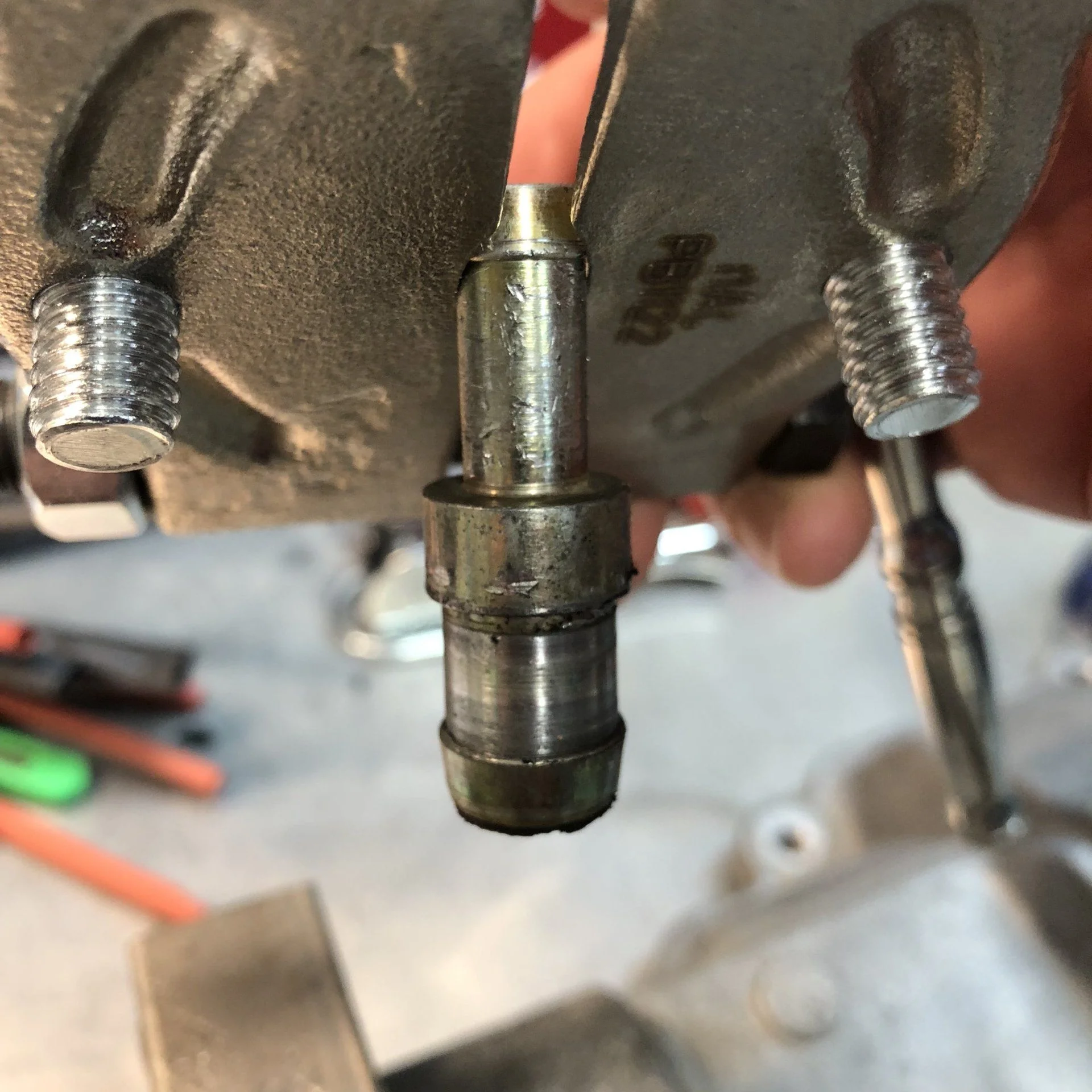

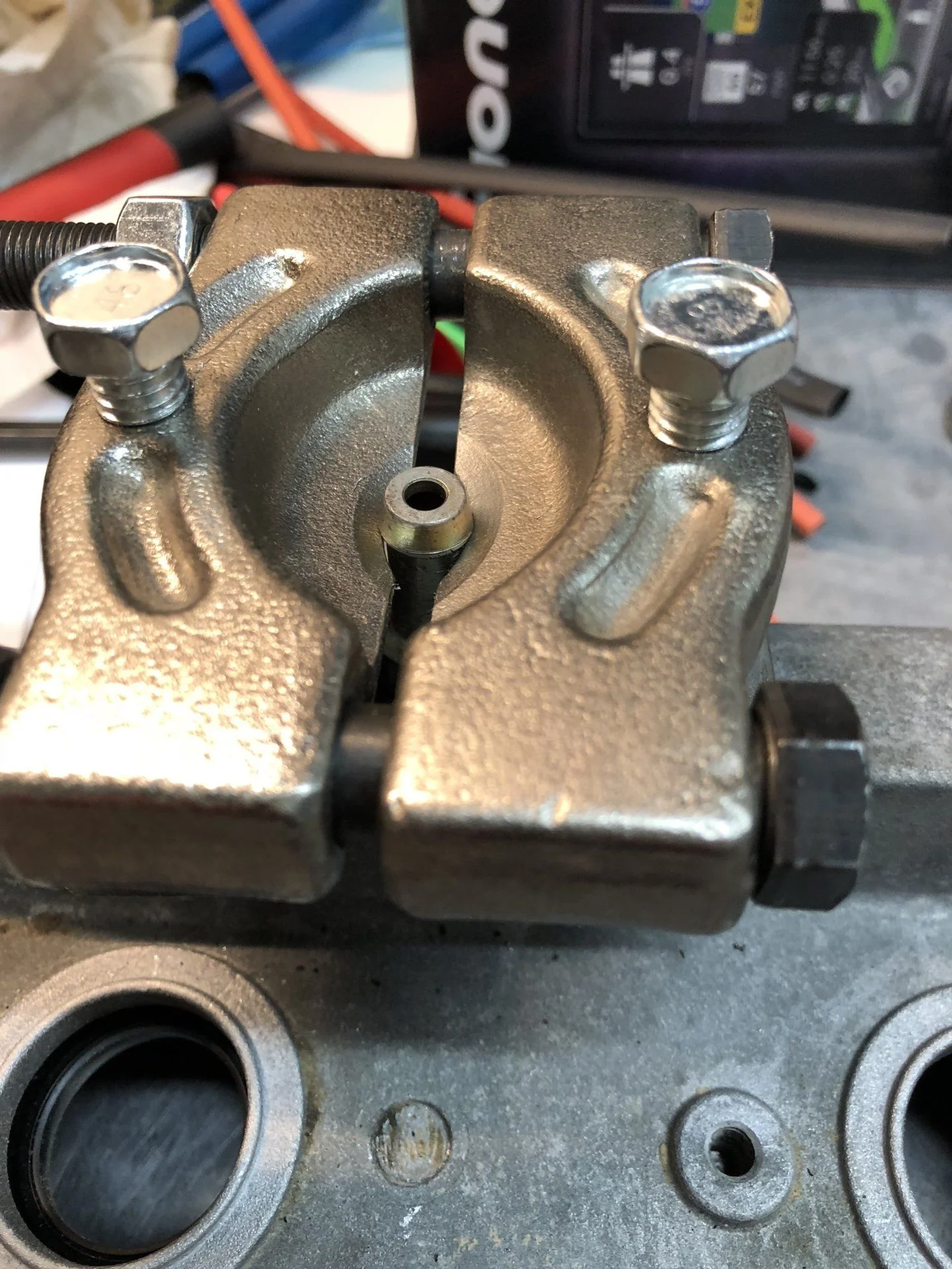

I used a bearing splitter to pull the PCV valve. Nice and no stress. I did not heat the grommet beforehand - it was brittle and partially shattered. I'm pretty sure if I had heated it it would have come right out along with the valve.

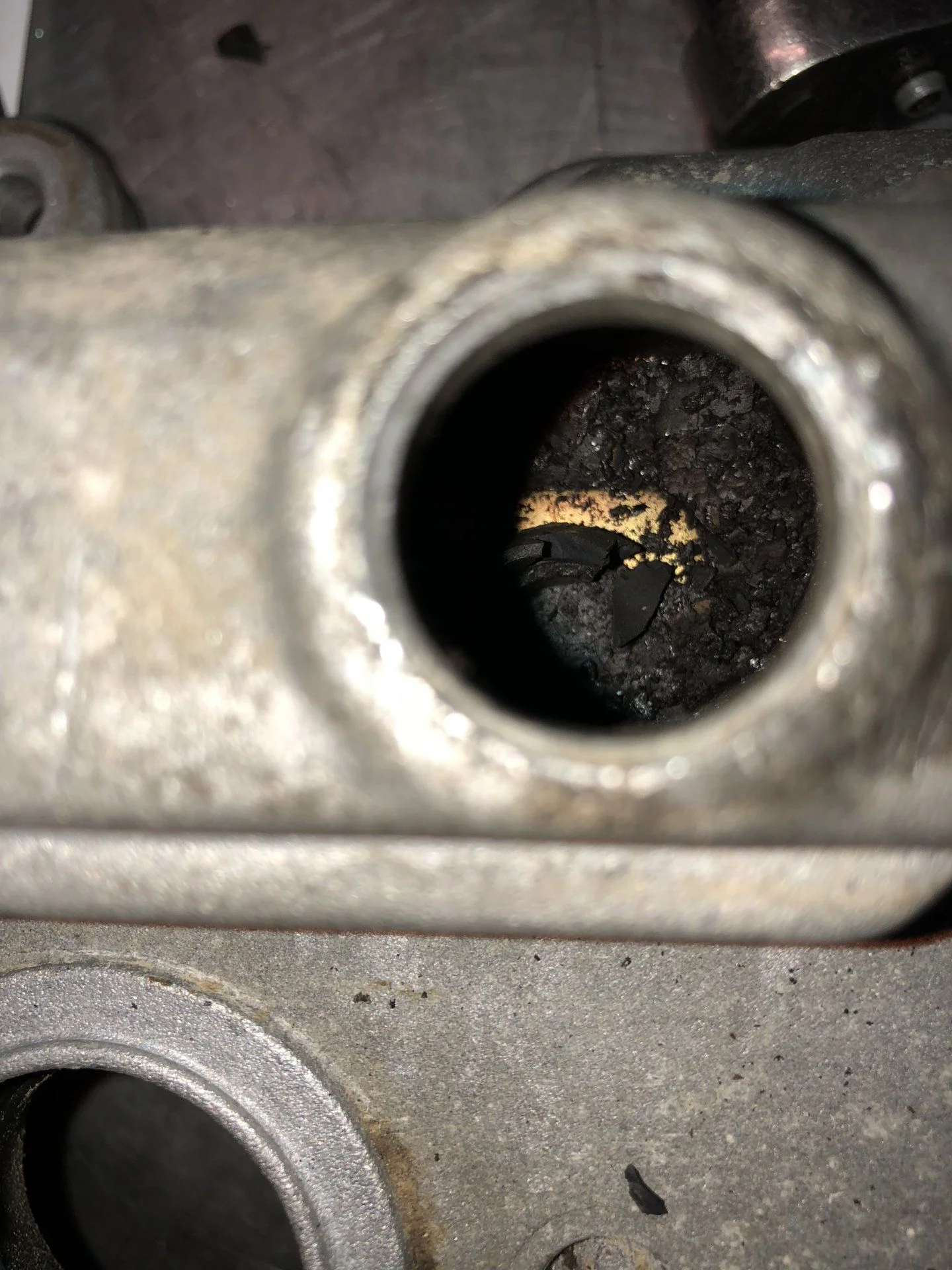

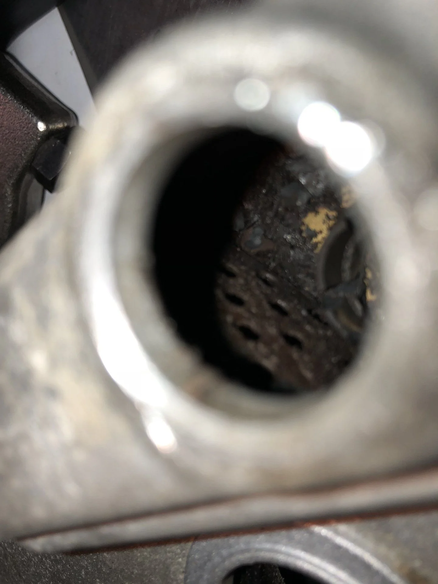

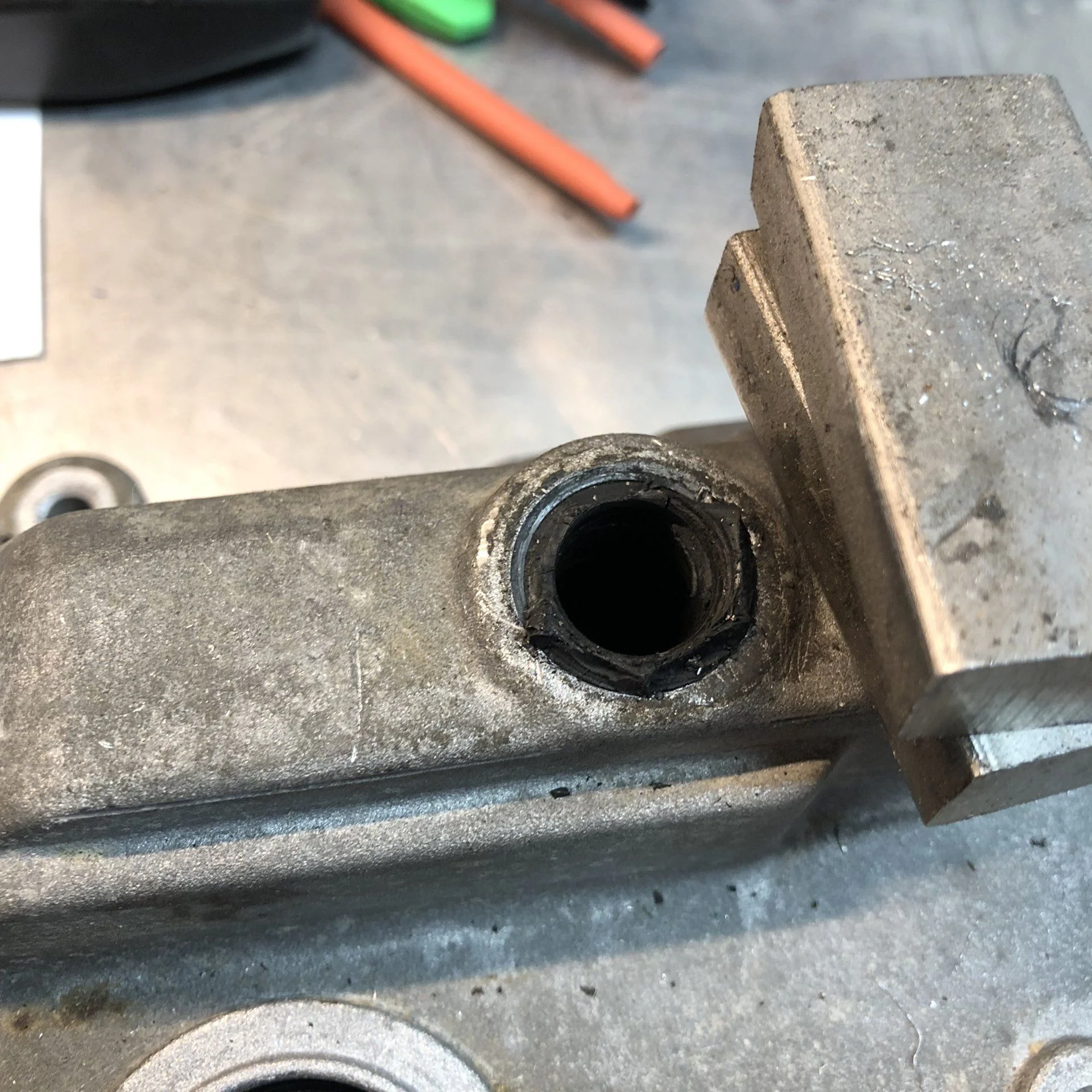

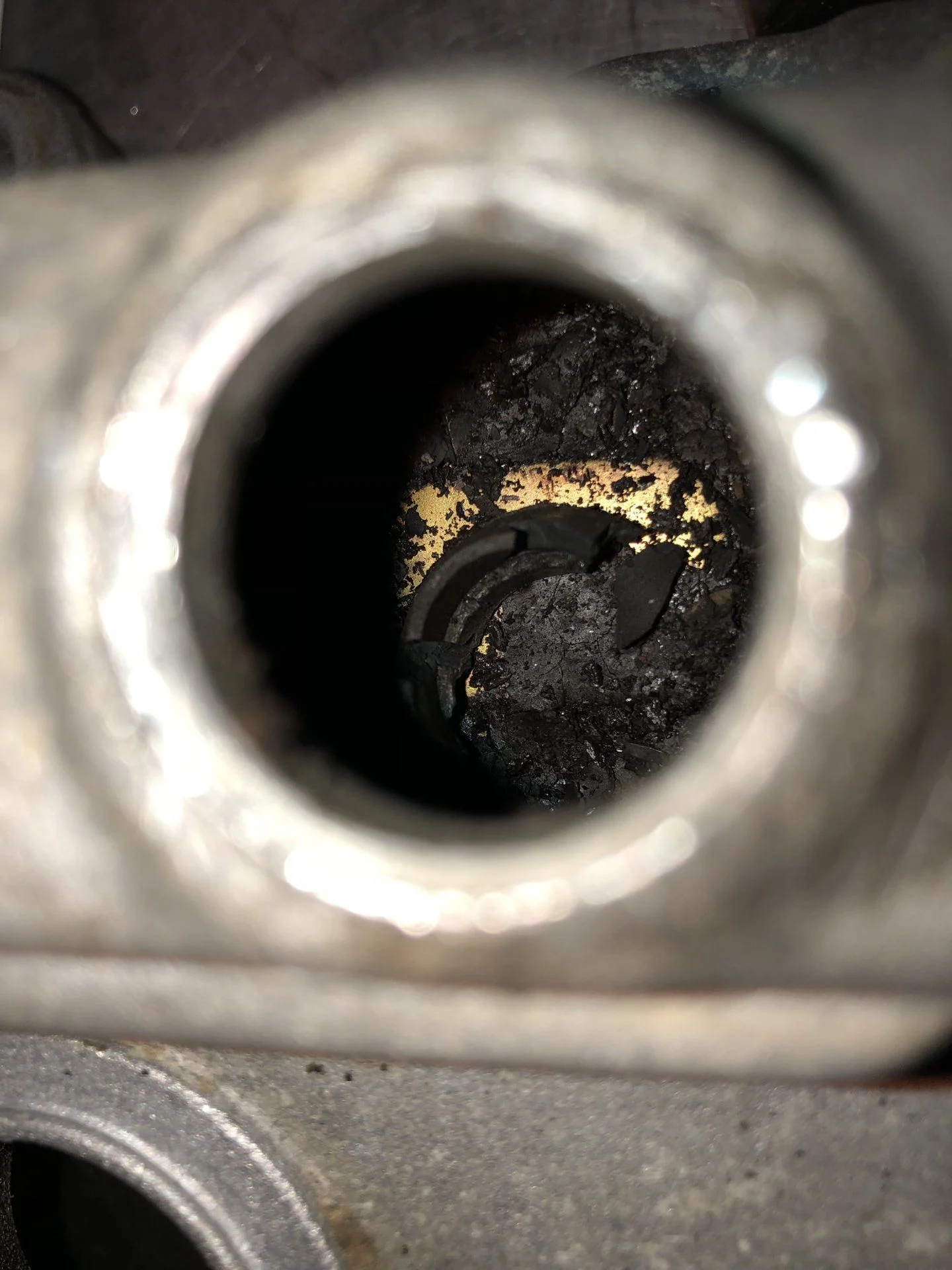

Here are a few shots down into the valve cover where the PCV valve lives. You can make out a screen - good for keeping large chunks of grommet contained!
Note: this is from a parts vehicle. Lots of gunk in there from the PO who did not take care of it well

Not sure about the seal. Primary issue is that the grommet gets very brittle with age. When you try to remove the grommet, it shatters into multiple pieces and gravity takes over. Higher probability it's droping down into the valve cover than lifting out intact. I don't remember a seperate seal with my PCV. You using OEM?
