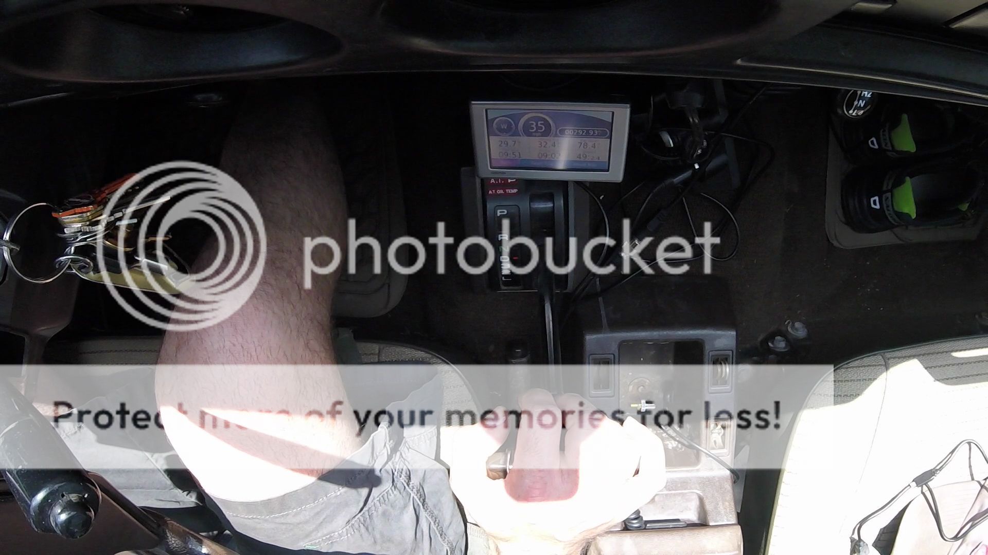

Let me start off with what I was hoping to fix and then what it actually did.
****Do this at your own risk. I am not responsible for your transmission, should you damage it!!****
See, my transmission seemed to shift ok in every aspect except one...when I need to downshift from 3rd to 2nd (like going up a hill), it would downshift from 3rd and skip second and go to 1st. Then I would have to let off so I don't blow the engine since it's redlining and trying to hit 1st gear. So since I would let off, then it would go back to 3rd since it didn't see I needed that kind of pressure in the transmission. If I manually pull the shifter down to 2nd, it does the same thing. So what I do is pull it down to 2nd, let off the accelerator pedal until I can tell it's not in 1st anymore, then drive off in 2nd gear and everything is fine. So basically, that's what my problem has been that I was hoping to see some improvement. That did not improve at all...nothing changed in that aspect of the transmission, still does the exact same thing.
But...what did change unexpectedly, was now my shift points have changed a little and it seems to hold in gear longer than it did before. Meaning, if I drove like any normal person would with a 1989 fj62, the shift points would be so quick, I would be shifting from 3rd-4th at under 30 mph. Now it seems to have made it where my transmission seems to hold in all gears longer and makes it feel a lot more peppy on take off. So that's a plus in my book.
I'm still frustrated about my downshift problem and I'm really hoping to get that taken care of. It's really irritating since when I need to downshift to gain speed up a hill, I end up actually loosing speed since I have to monkey with getting it in gear. If anyone has any suggestions on how to possibly improve this issue, I'm all ears. I don't want to swap transmissions and I'm hoping to not need a rebuild.
Hope this helps someone wanting to know what happens when you throw a transmission into park!
