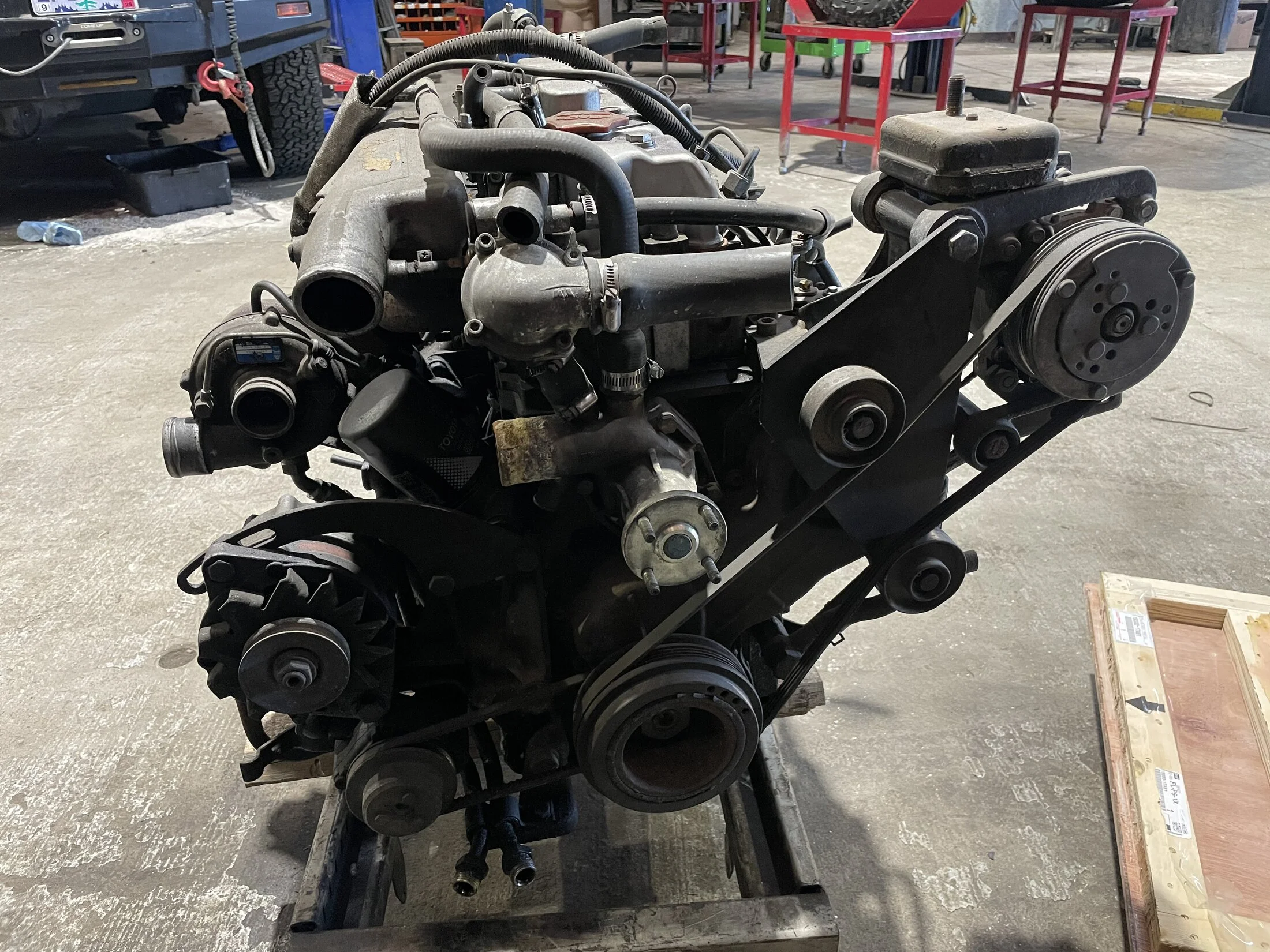

Hello,
I am currently working on an om606 swap into my fj60 with h55 and need some bj73 parts in order to use the available adapter kit. Here is that Thread. I need the bell housing, clutch fork, and slave cylinder to a euro spec bj73 with the ZM2.5. The bellhousing should be part number 31111-60160. Does anyone have any leads on where I could source these parts? Thanks for any help!

Those are the wrong parts unfortunately

You might want to do a search in the 70 series section and contact the people that swapped out their VM for a different engine , they might have what you need gathering dust on a shelf
@joekatana Dm’ed this afternoon at 4:00 after finding out he had pulled it out of a truck using the search function as you suggested. Me asking seems to have inspired him to see if it will sell on open market, albeit at a higher price. Doesn’t want to seperate the bellhousing and other parts I need.
The only person willing to buy that has a bad VM and has the bh already , just give it a few days until he realizes he is selling a boat anchor . I trew away 3 of these in the past few years .
I don't know set you are on using the H55 but DieselPumpUK also sells an adapter kit to bolt the OM606 to an H15X transmission utilizing a diesel 80 Series bellhousing. If you can find an HZ to H55 bell housing you could probably use the same adapter kit. It might be easier to source the parts. This is the setup I plan to use to swap an OM606 into my 80 series.
I actually can’t even get them to respond to me at all at the moment so @LA Z has offered to make an adapter plate if I can find a 3d scan of an h55 and 2f bellhousing.
I'm swapping my VM 2.5 to a 15B-FT, so I'll have those parts, but I haven't been moving fast on it, so if you're in a hurry I may not be the person to talk to.
