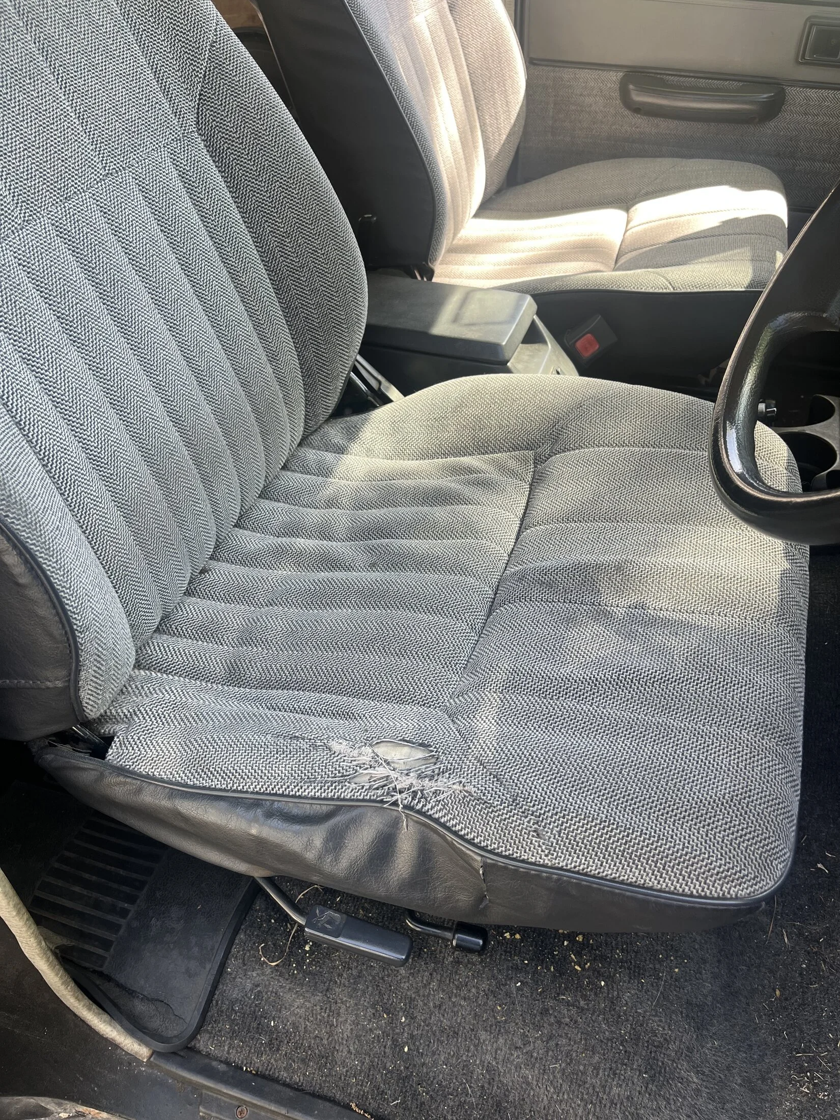

Team - My 1987 BJ73 needs a right hand driver side seat bottom cover and cushion. Does still sell these parts or will I need to find these used? Thank you.
Covers are NLA, seat cushion I believe are also NLA but you might be able to find some old stock somewhere. You can get newer year covers and cushions but don’t remember what year. You might be able to fit them to your old frames. If you are bored you can look through my build thread and see if I documented this.

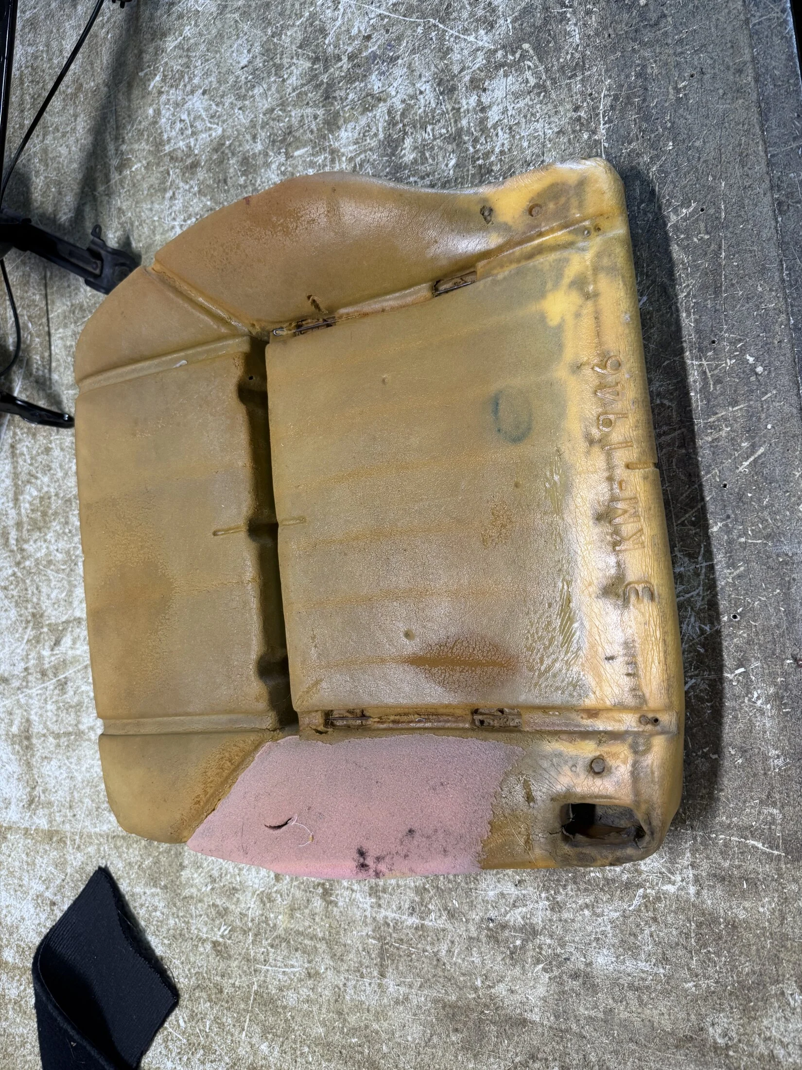

You can swap the bottom seat cushions side to side. You have to keep the covers the same, but that’s what I did a few years ago to give them a little more life.

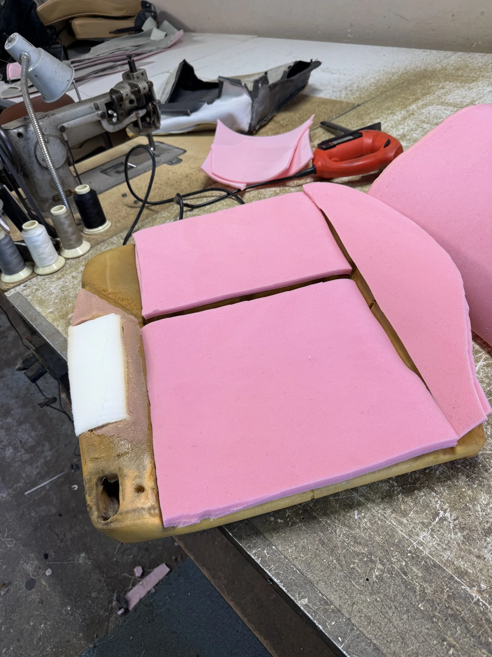

I just patched mine. A good upholstery shop should be able to get you going again. My upholstery guy let me do the tear down and rebuilding of the foam so I could learn(he re stitched the wire track and the torn side seam) I did the rest.
