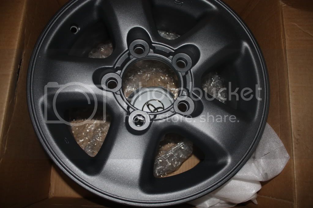

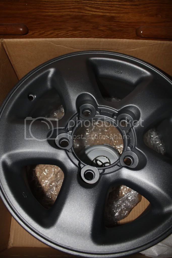

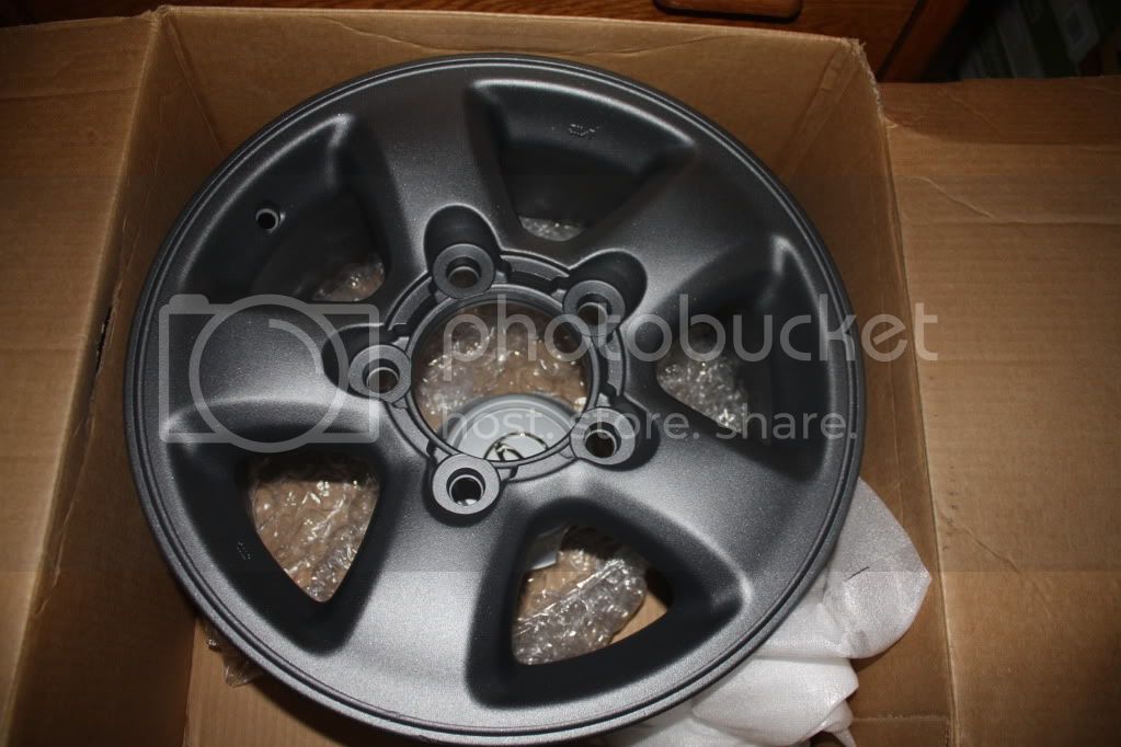

Another angle in the sun.
I like the graphite too. Just bought some of the Tundra steel wheels for cheap -waiting to pick them up and put new shoes on them. Don't want to paint them black, but might try the graphite color. Great thread. Thanks
im having trouble posting pics so if you look me up on flcikr under people" Ded Bhind Da Eyz", theres a photo stream . i was going to go with dupli:graphite but i am planning on matching the arb/slee bumper and dont want to spray paint my bumpers. as you can see, they are much darker, and are metallic, photos dont do them justice.
Socal - Even Walmart has a pretty good selection of spray paint... There are lots of varieties of shades of blacks and some don't look quite black... Some have textured finishes, metallic finishes or properties, hammered finishes, flat, satin, gloss, semi-gloss... Most of those textures and finishes are available in lots of colors... You can also go to a local hardware store or auto paint supply store and have them match your bumper color and many can put the paint into a spray can as well... Good luck!
semi-gloss rustoleum high enamel, those huge brushed aluminum cans match the ARB powdercoat perfectly. That is what I use on my rims and it matches quite well. I use it on the ARB every few trips out.
