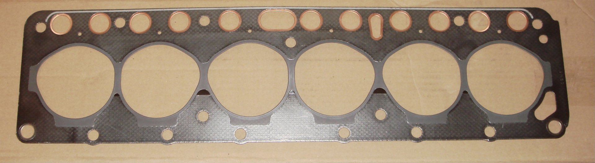

Hey guys, I just changed out my head gasket along with a new aluminum radiator, but I'm still getting high temps. The gauge gets to about 2mm behind redline before I shut it off and I've already flushed out the old oil contaminated coolant and put in new 50/50 premix. I tried searching for similar issues on here, but can't seem to find something that could match my issue...
Edit: I have the oem thermostat rated at 88C
PS: I uploaded a picture of the head gasket before install, and I'm pretty sure I put it in the right way? Can someone verify with me whether that's the correct orientation? Thanks guys for the help!

Ok. that's good. The head gasket looks correct to me. I'm not sure it can be installed incorrectly? Others may know. I've done a few and it seemed only possible to go one way.
Apart from a blockage in a water passage or a severely advanced ignition, I can't see what else could be causing he overheating . {except maybe a cracked head}

I’ve read recently that some head gaskets can block some of the coolant passages. But if you got it from mr T it should be correct.
There have also been counterfeit aisin parts floating around on eBay and amazon FWIW. But again, Mr T should supply the real deal.

And yes, you can indeed install the HG backwards…yours appears to be correct tho.

Unfortunately- that’s an aftermarket head gasket and not the Toyota gasket. I had one of those abominations.
The cooling holes on some of the passageways are not the same size as the Toyota gasket.
Either replace that lame gasket now - or later / but one thing is for sure - you’ll be replacing it again with the Toyota gasket before you want to.
Vendors shouldn’t even be selling that gasket.
So what's the giveaway its aftermarket? I have actually never done one of these myself, and would buy OEM based on what I have heard about the after market ones available, but just wondered if there was an easy way to tell right away.

It's a Fel-Pro gasket and I know they don't exactly have the best reputation, but I got a really good deal on the kit from a friend in the industry, and I just want to make it last a couple more years because there is a diesel swap in the works right now.
