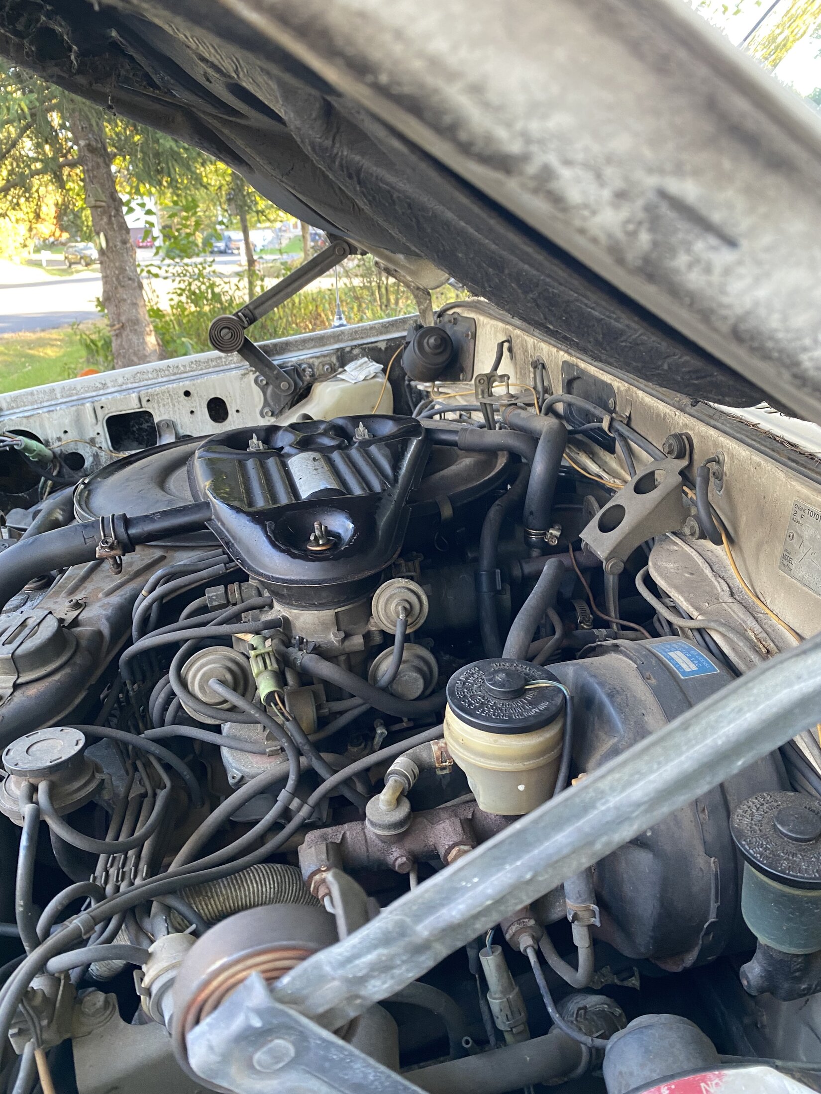

Saturday Morning Update - I took on a ten minute drive. Huge plume of white smoke from exhaust. Smoke/steam appears to be rising from around what I think is valve cover and rising from directly under the air filter holder. Motor runs gone, as usual. Temp and oil pressure normal. I could not determine a distinctive smell from the smoke/steam, but my sense of smell is pretty bad. I was definitely surprised by the amount of exhaust smoke. At one point I stopped in the road this morning and a cloud surrounded me.
You mean coming out of the end of the exhaust pipe or from the manifold area at the engine?
By everything you’re posting here it sounds to me like you could have a significant oil leak that’s burning on your manifold or exhaust pipe.
But if you’re saying the steam is coming out of the exhaust pipe then I wouldn’t be driving it.
Have you checked your oil to see the level and also if it’s milky white?
Also, in the absence of wind, steam typically dissipates much faster than smoke. I’m sure you’ve experienced steam while boiling water on a stove, and smoke from a campfire.
If you’re still not sure, post a video here.
Big news - Leave it to the Australian. My Son in-law from Melbourne isolated the source. On the drivers side just behind the carborator , behind a heat shield of some kind, we found a spot where there was some liquid spraying out. It is next to what looks like a spark plug (but obviously not a spark plug) maybe even a temp sensor of some kind. That’s all good news.
i win i win!
coolant spraying on the manifold
